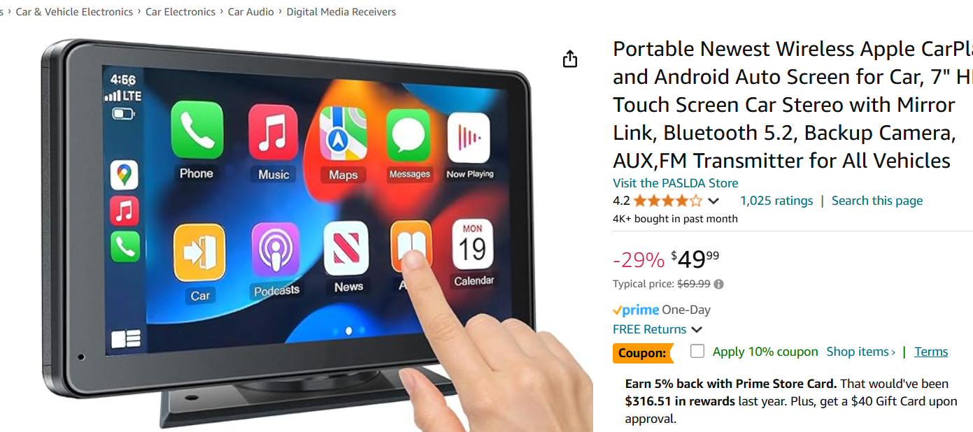

Curious if anyone has tried one of these screens? I've seen the GPS screen replaced with a Garmin.

7” screen will be much larger than factory Nav screen opening in dash, if that is what you have in mind.

that has some big margins......

A couple of years ago I purchased one of these cheap units and installed it in my Mitsubishi Montero. It replaced my Pioneer stereo. The sound quality was terrible. On a trip to LA from Palm Springs I was using the GPS. In the middle of the 10 freeway it suddenly said "in 500 feet make a sharp left". which was impossible. A couple of seconds later it said "That's impossible". I later took it out and installed my Pioneer unit back in. Now days, I just use my Waze on my phone which is always accurate and provides updates on traffic.

For that price, keep your expectations very low…
