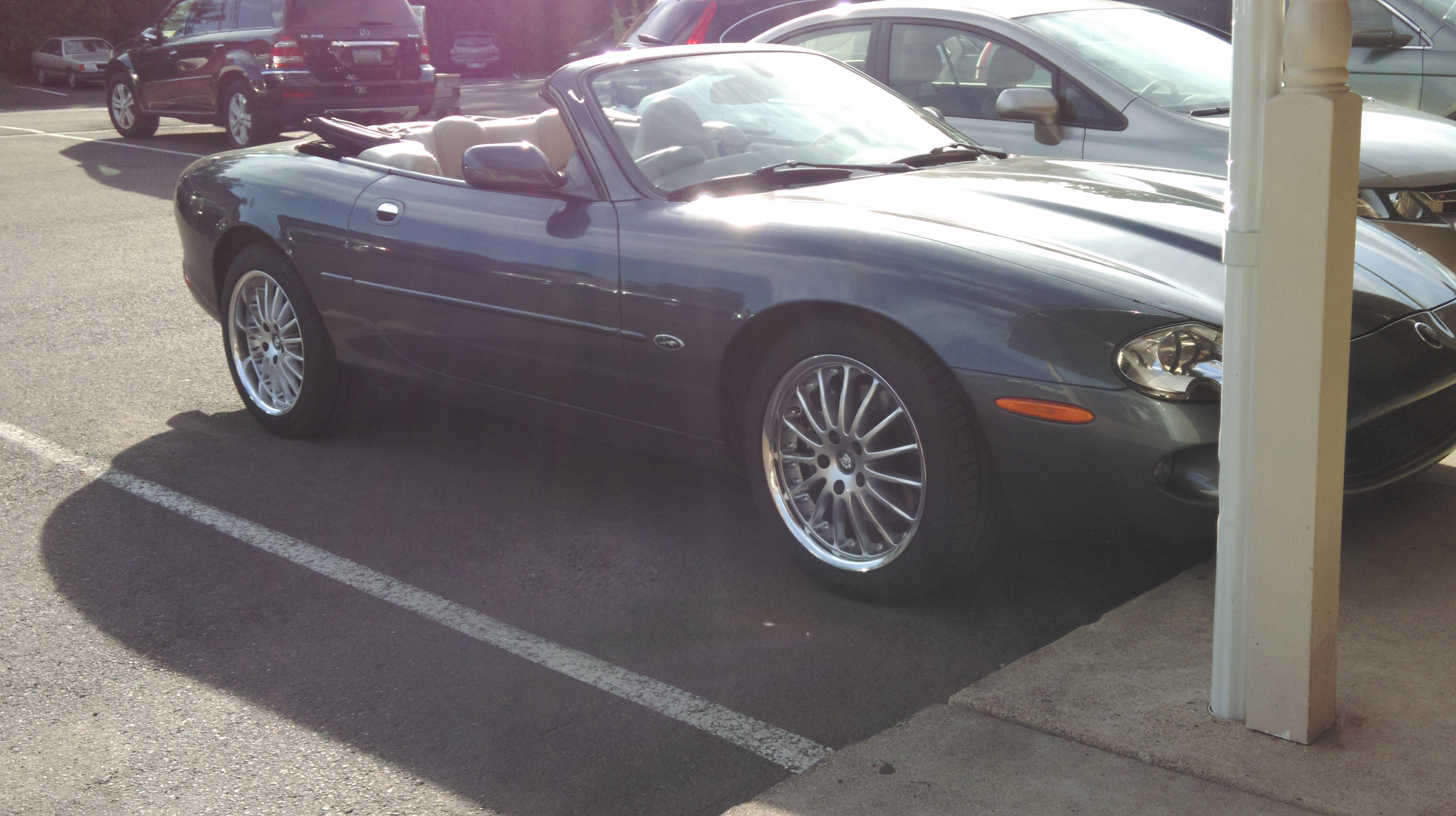

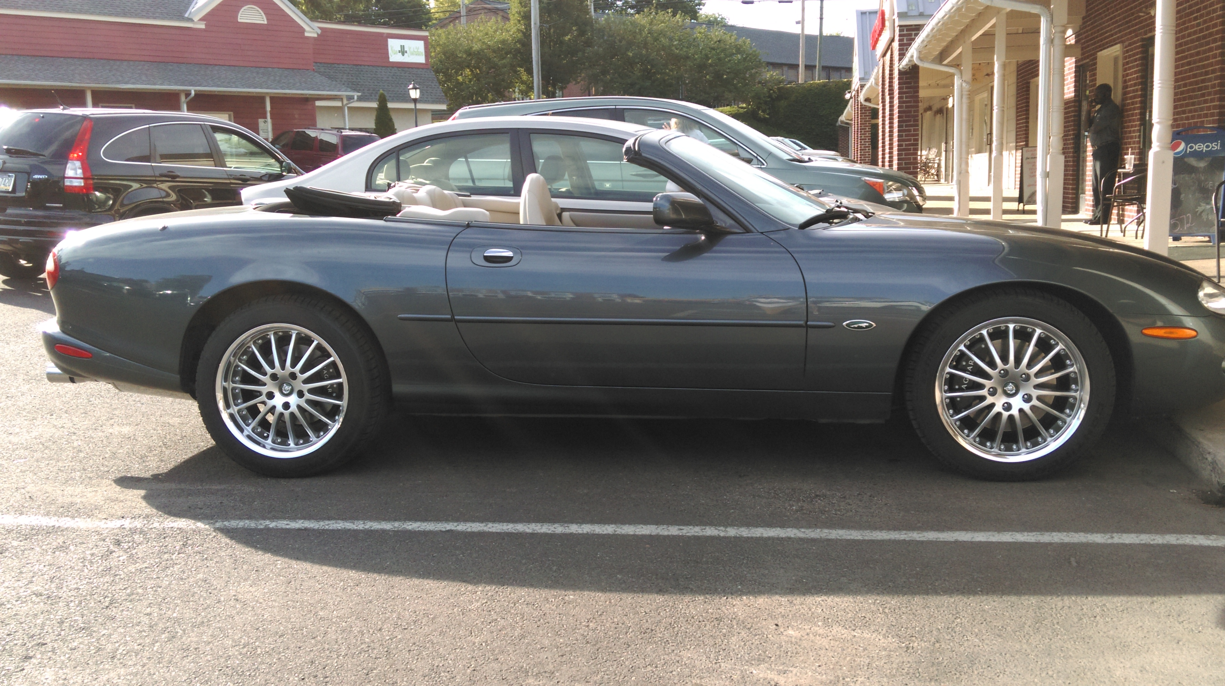

My wheels arrived Monday, and I spent the better part of the day installing them. They're 18" staggered, and here's how they look. I'm very pleased with both the look and how they perform. They're perfectly balanced (up to 90 mph!) and it feels (subjectively) like they ride and handle a bit better than the Michelin Pilot A/S on my old Lumina wheels (which are now for sale, by the way).
Thanks for everyone's interest.
