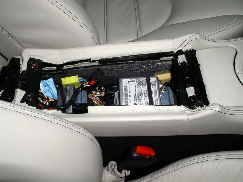

A comparison of my 2001 and 2005 XK8 Coupe centre consoles.
2001 XK8 - deep liner:
2005 XK8 - shallow liner:
Both had the Adaptive Restraints Module at the front. The difference with the later model was additional space required for what I think was part of the Bluetooth installation although it wasn't the module because this was behind the rear seat.

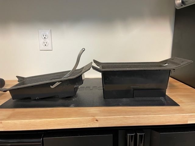

This is the difference in the console box depth. The one on the left had the phone connector in it. The one on the right I bought to replace it, as the phone is of no worth today. There is a module under the box that makes the one on the right too tall. Is there a box that is shallower?
