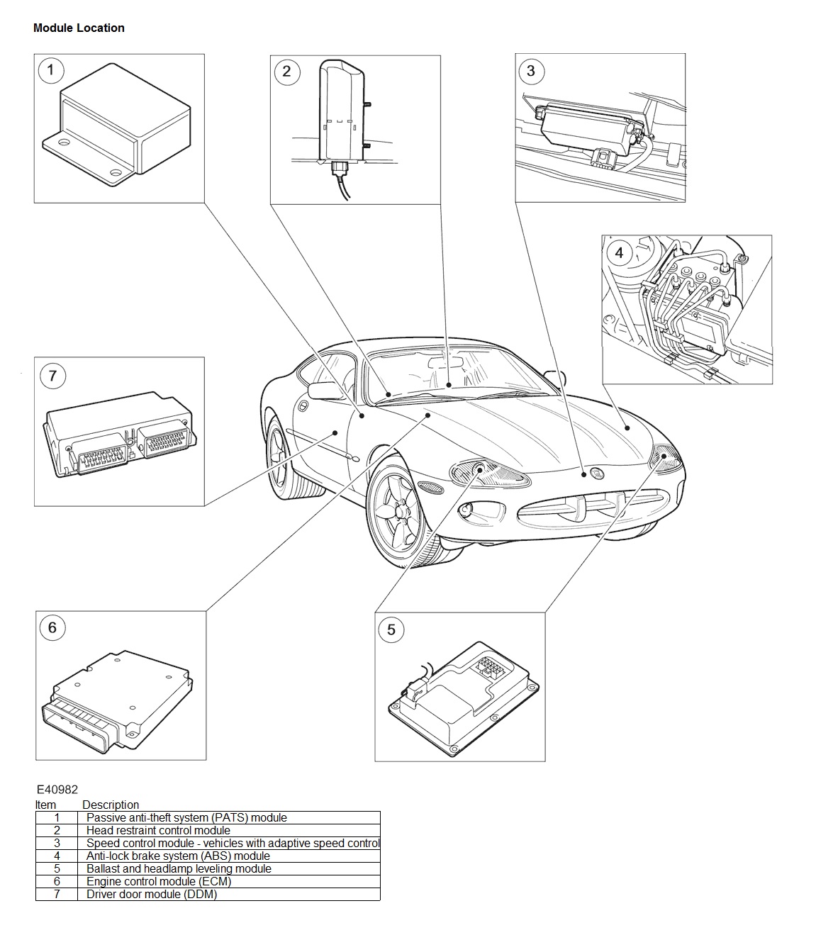

I wonder if anyone can tell me the exact position of the central locking security module?
I thought it was by the battery, but cannot see it??
My central locking is playing up and want to check that its not been water soaked, as this seems to be a common theme.
I found an ecu box by the battery, I think, all was dry and well, but no aerial point for the security system, so assume this was not it?
Any help greatly appreciated.
Thanks
Al

AFAIK, the Module is located Underneath the Fuse Box in the Trunk.
Old Aug 21, 2014 | 02:46 AM
Likes: 17,018
+1
When hunting for modules, it often helps to know what they look like. Here's the locations and drawings of them:
(click on the images to enlarge them)

Originally Posted by GGG
+1
Attachment 93676
Attachment 93677
Great Help!!!
Thanks Graham
Al
