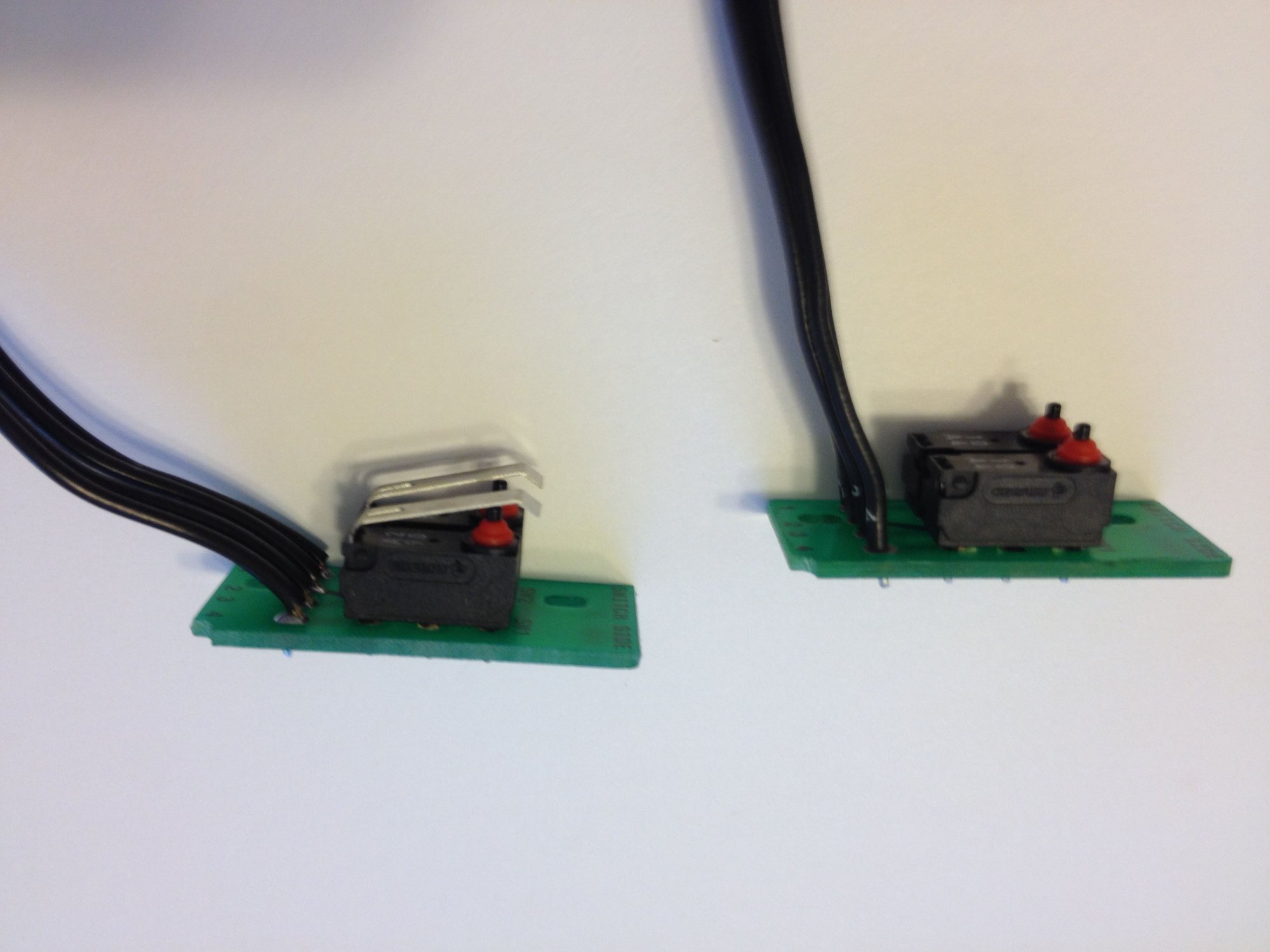

I was going to take pictures, but I could not get any sharp and bright enough to show anything. It really doesn't matter. Lying on your back with your head against the floorboard, and your hand(s) under the dash, you really can't see anything. The only useable shot is below and it shows why my switch was not working. Both contact springs on the microswitches were broken off. I guess one went, followed couple of months later by the other one.

Board from old switch on right.

One note to mention is that those switches on the board are the same ones inside the boot lid latch switch.
I had to unsolder a switch from a faulty brake switch assy and install it to get the car out of VALET MODE when the customer's knee hits the button.
The latch has a switch assy that comes apart and THAT micro switch is inside.
I think I had to swap metal levers but it worked!!!!
