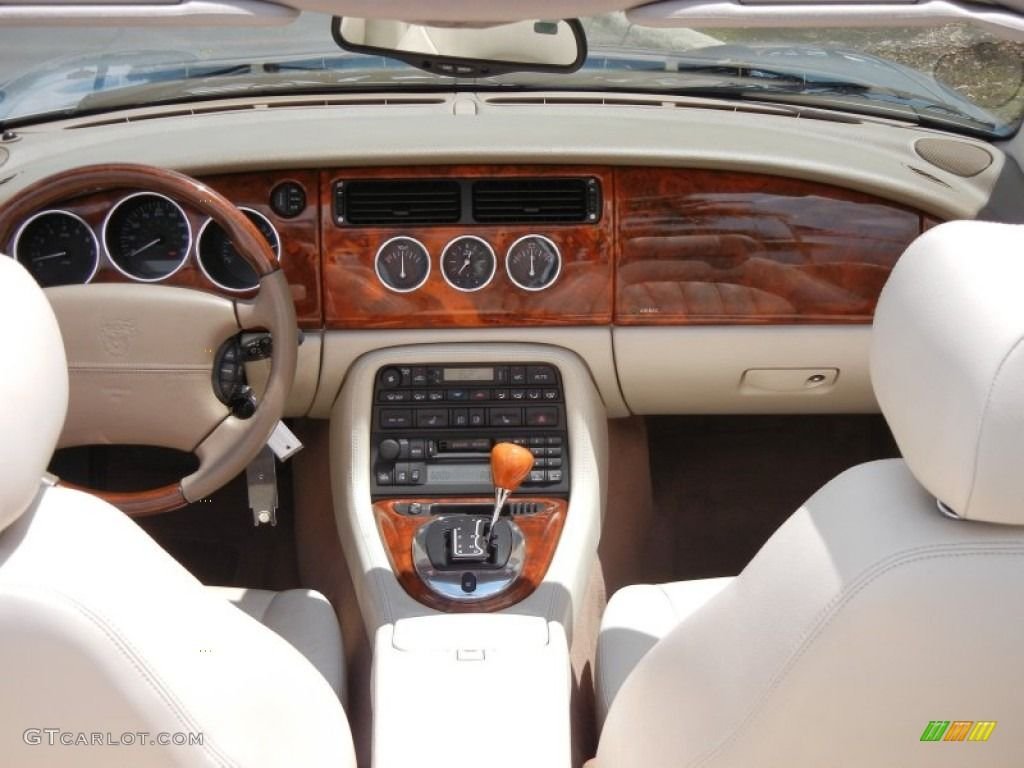

You can change the fuel and trip functions to KM by using the button above and right of the steering wheel.
Does that help?
You can see it here just left of the three centre gauges.
