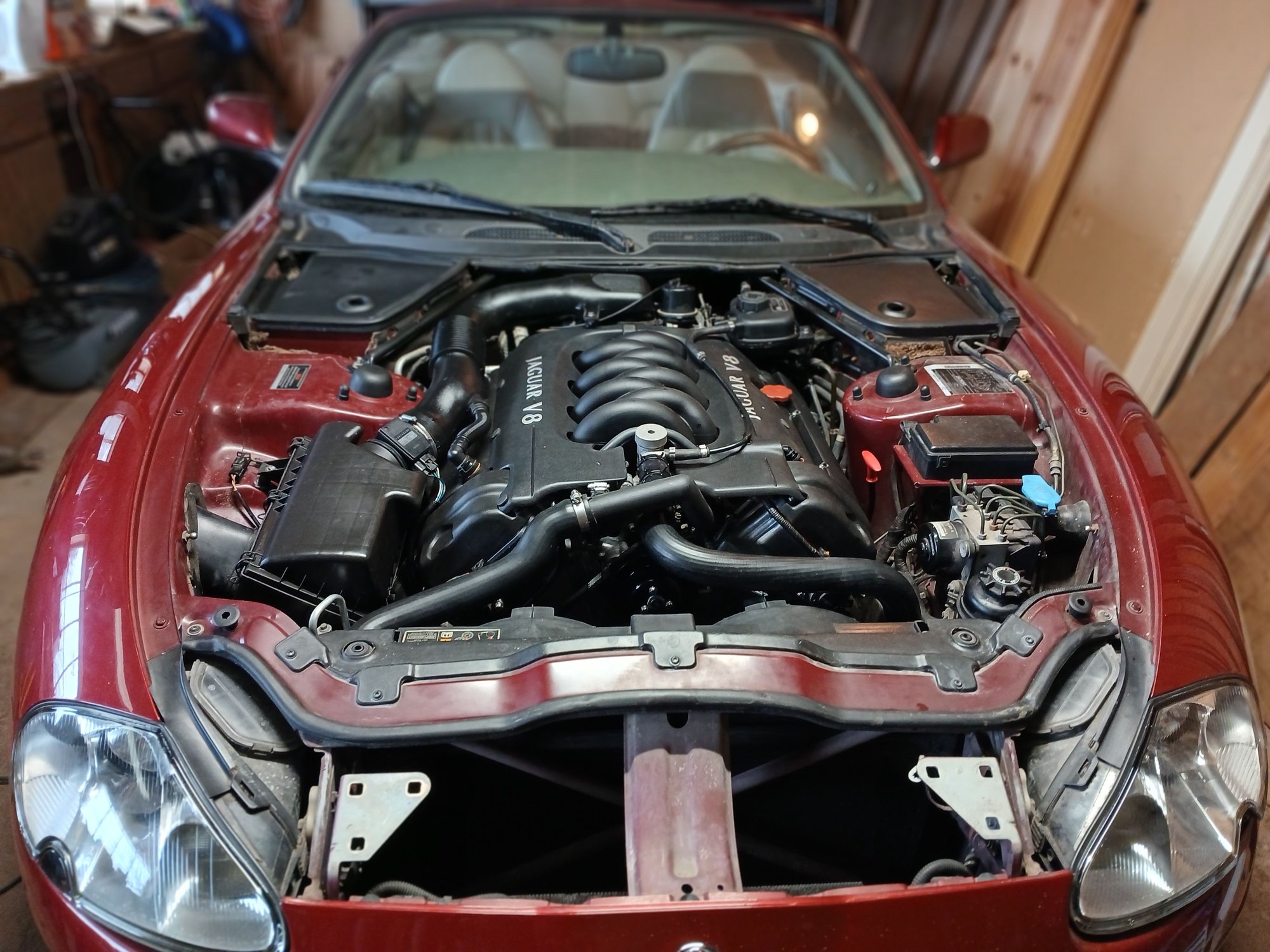

A BIG thanks to all who advised and commented on my struggle with tensioner and guide replacement. After a long delay due to bitter winter weather during December and January (wind chills as low as –51⁰F) I finished up just a couple weeks ago.
Still some detailing to do in the front.
I checked it out at idle in the garage with a stethoscope after replacing the newly painted oil pan. Then after getting the hood/bonnet back on, we got a fresh twelve inches of snow.
After the roads were cleared and dried out by a February thaw and some welcome sunshine, I was able to test it on the road this past week with a few drives of 10 to 50 miles. With temps expected to be in the 40's and 50's (F) the rest of the week, I'll take Kathy shopping for her birthday—about a 150 mile round trip.
Thanx again, Rick
