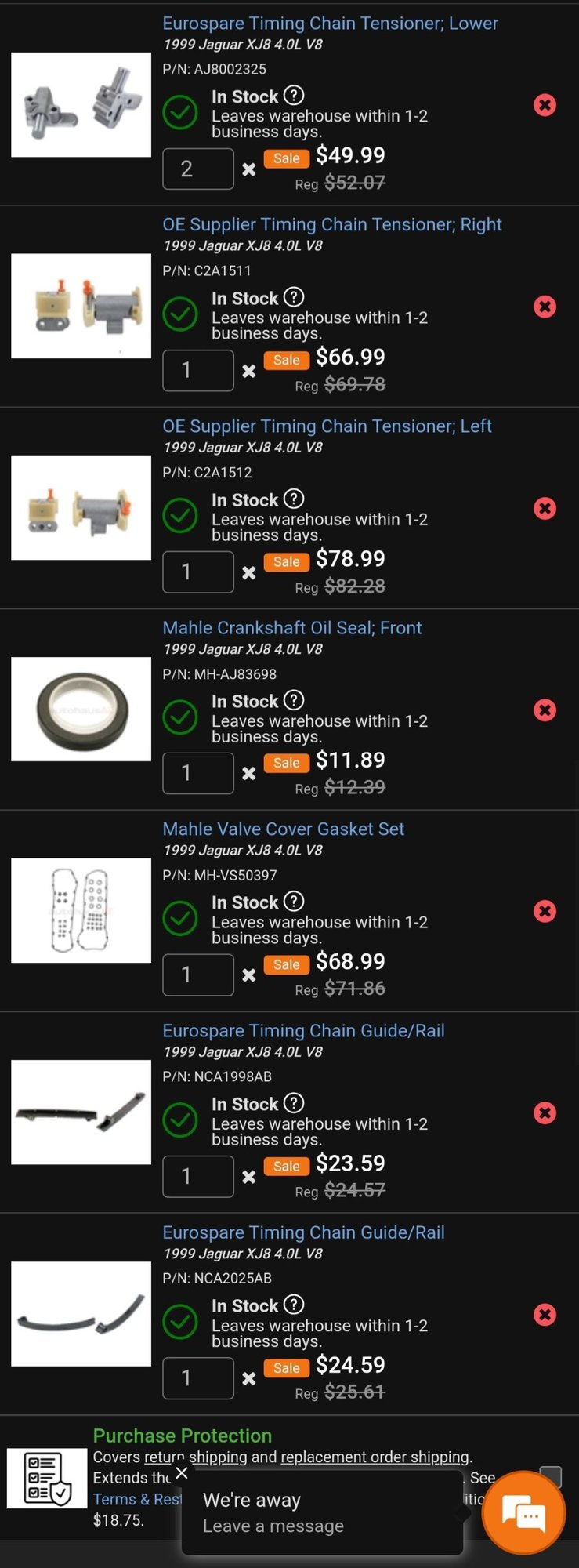

1. The slide you suggest (NCA1998AB). If so Britpart or Eurospare ($6 difference)
Eurospare OEM C2A1456 Timing Chain Guide/Rail - Jaguar or Britpart NCA1998AB, NCA1998ABG Timing Chain Guide/Rail - Jaguar
2. Upper tensioners
OE Supplier C2A1511 Timing Chain Tensioner; Right - Jaguar, Land Rover and OE Supplier C2A1512 Timing Chain Tensioner; Left - Jaguar, Land Rover
3. Upper Timing Cover gasket Eurospare AJ8003699 Timing Cover Gasket; Upper - Jaguar | AJ83699
4. Lower Timing Cover gasket Eurospare NCA2127AC Timing Cover Gasket; Lower - Jaguar
5. Anything else needed?

Here's main parts you need don't buy chains it's not necessary it's only 54k miles . If you want cheaper then rock auto. You will need timing set tool Amazon 50$

Buy everything and then take the car to the shop
I forgot to update the guide quantity you will need 2 guides from each one . Don't overthink it it's easy if they know what they're doing they don't even need to remove the radiator just the cooling fans . Good luck

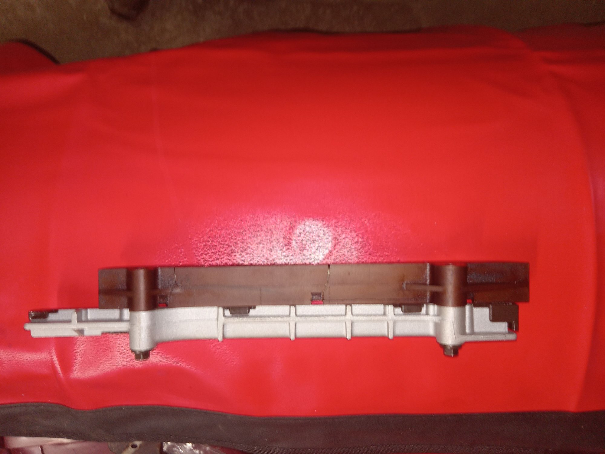

Here's a pic I found (I think it's from member BobRoy) comparing the two guides, the top one being for the earlier pre-Morse engines.

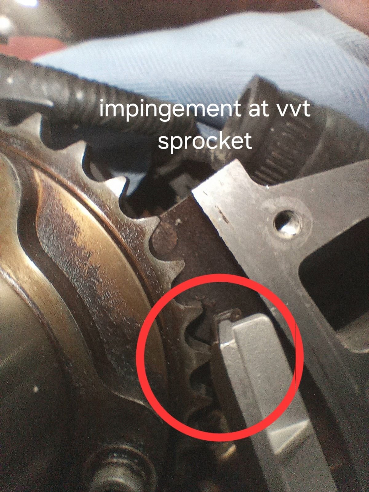

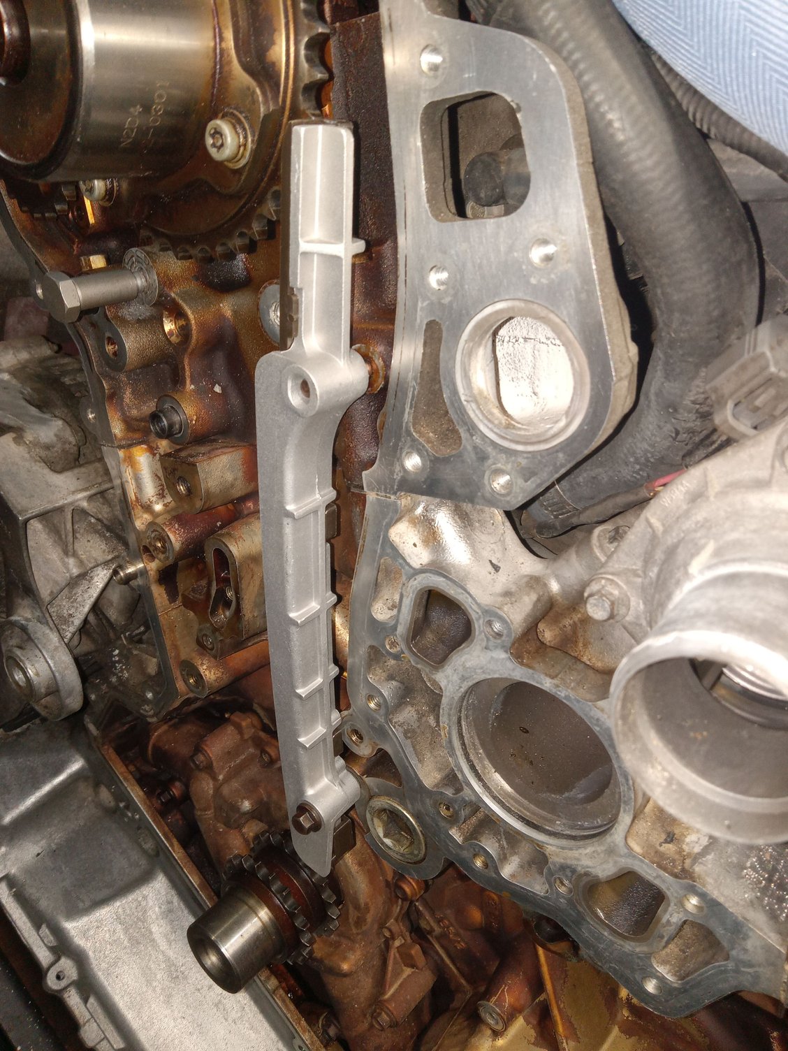

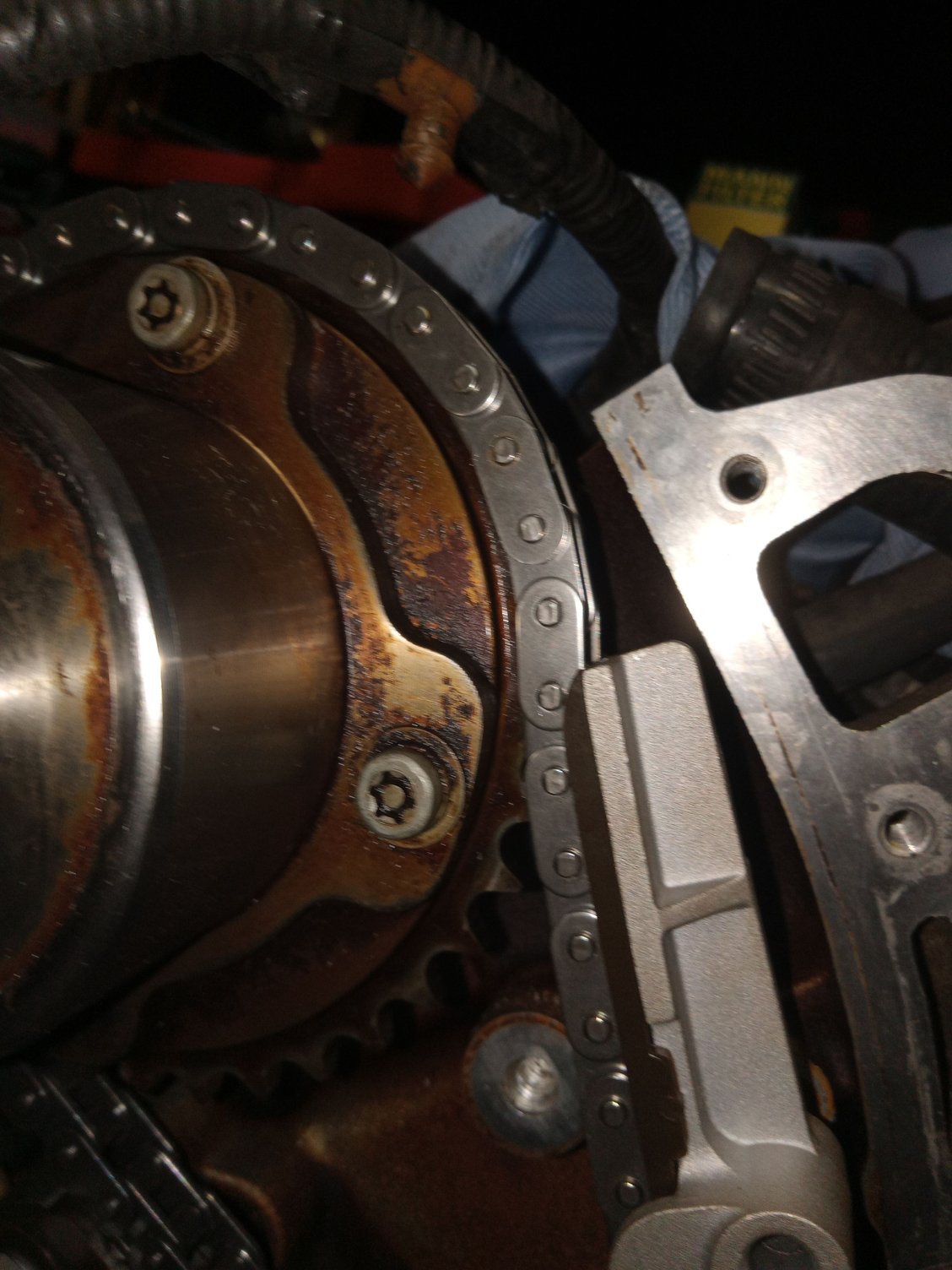

I ordered the primary chains, guides and tensioners Saturday morning from JLR Classics. At the time, 8:00 AM it was snowing here, and the wind chill was –3⁰ F. Neither my garage nor my barn are heated by anything but sun and electric space heaters which only help if positioned close by and pointed directly at me; thus my hurry to get this done. It was the high cost of the secondary components that led me to keep the old ones. I thought about opting for the very inexpensive after market set(?) but switching them out later is certainly not as involved, as the timing cover doesn't need to come off. It still nags at me though, since I sourced almost all the nearby parts: idler pulleys, water pump, outlet pipe, damper and fixings, and cleaned and painted the other pulleys and bolts that were not worn or damaged. I'll attach a few photos of the fitment problem with the new guides for anyone interested. Many thanks, Rick.
Original and aftermarket guides compared.
Rt. bank, slack side.
Rt. bank overview with aftermarket guide not bolted down.
This is not bolted in, just riding on pin. The rib also interferes with the cover here.
Reinforcing boss and plastic tab prevent bolt from attaching. Bolt (lower) end,  Rt bank.
Impingement at left bank vvt sprocket.
