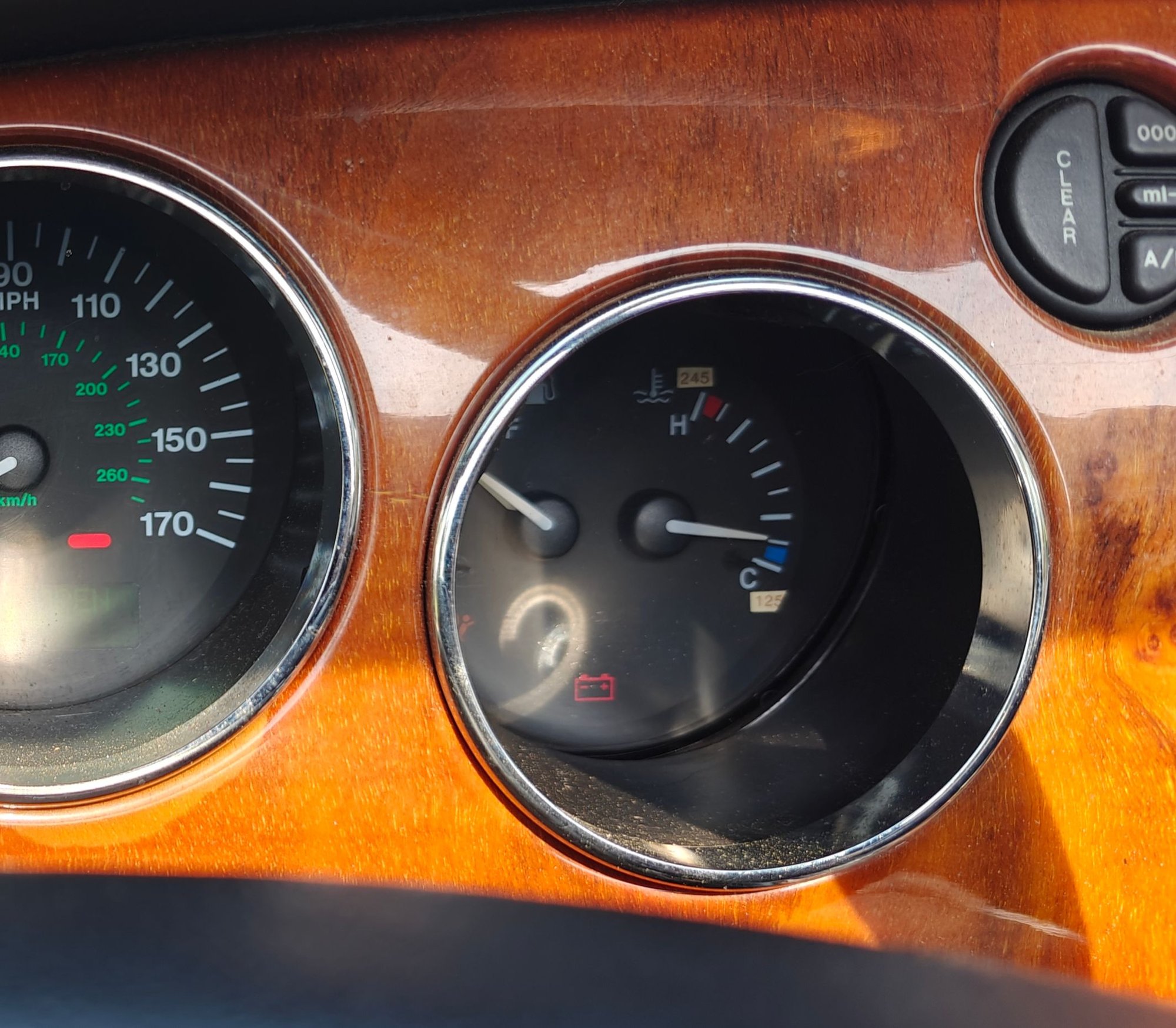

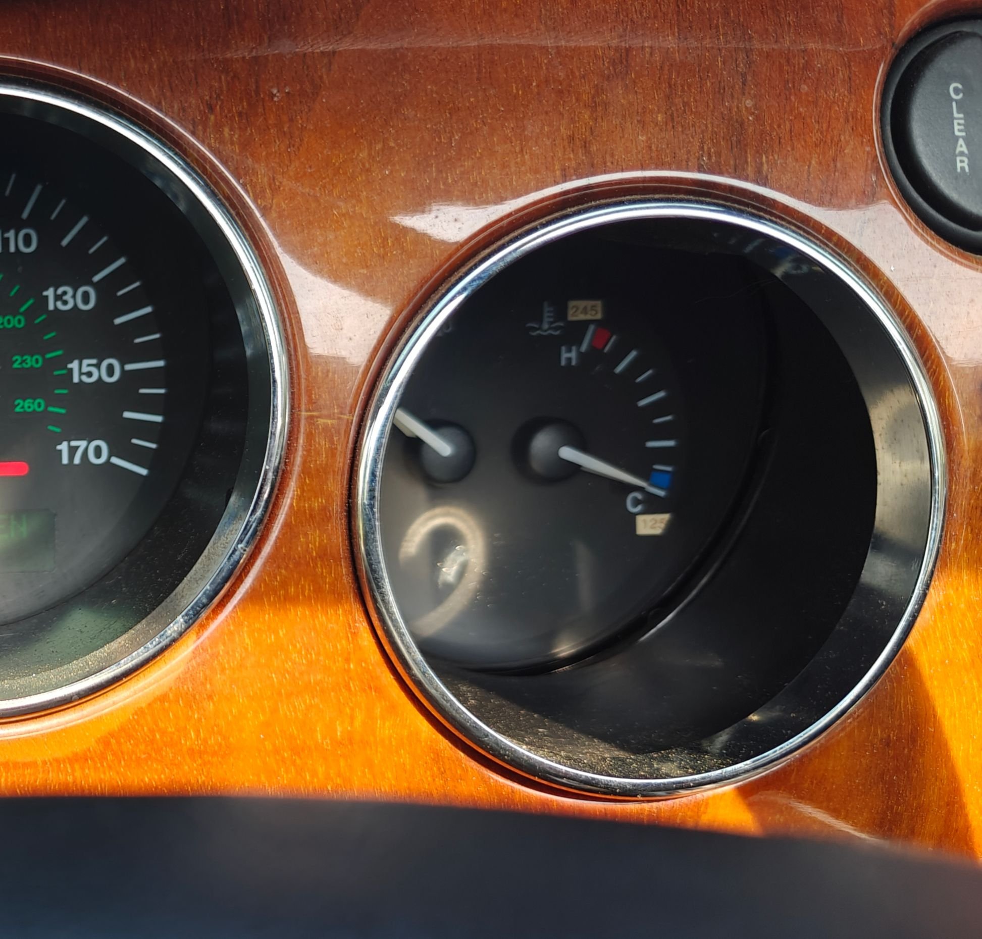

Thanks again.. so I went with my first option of doing a hard reset..and it worked! Must be something residual causing this (perhaps weak battery) Saved me from having to remove the cluster.
Note: car was cold
Here are pics
Before hard reset with key on (not running Looked the same with key off
After hard reset with key on (not running
