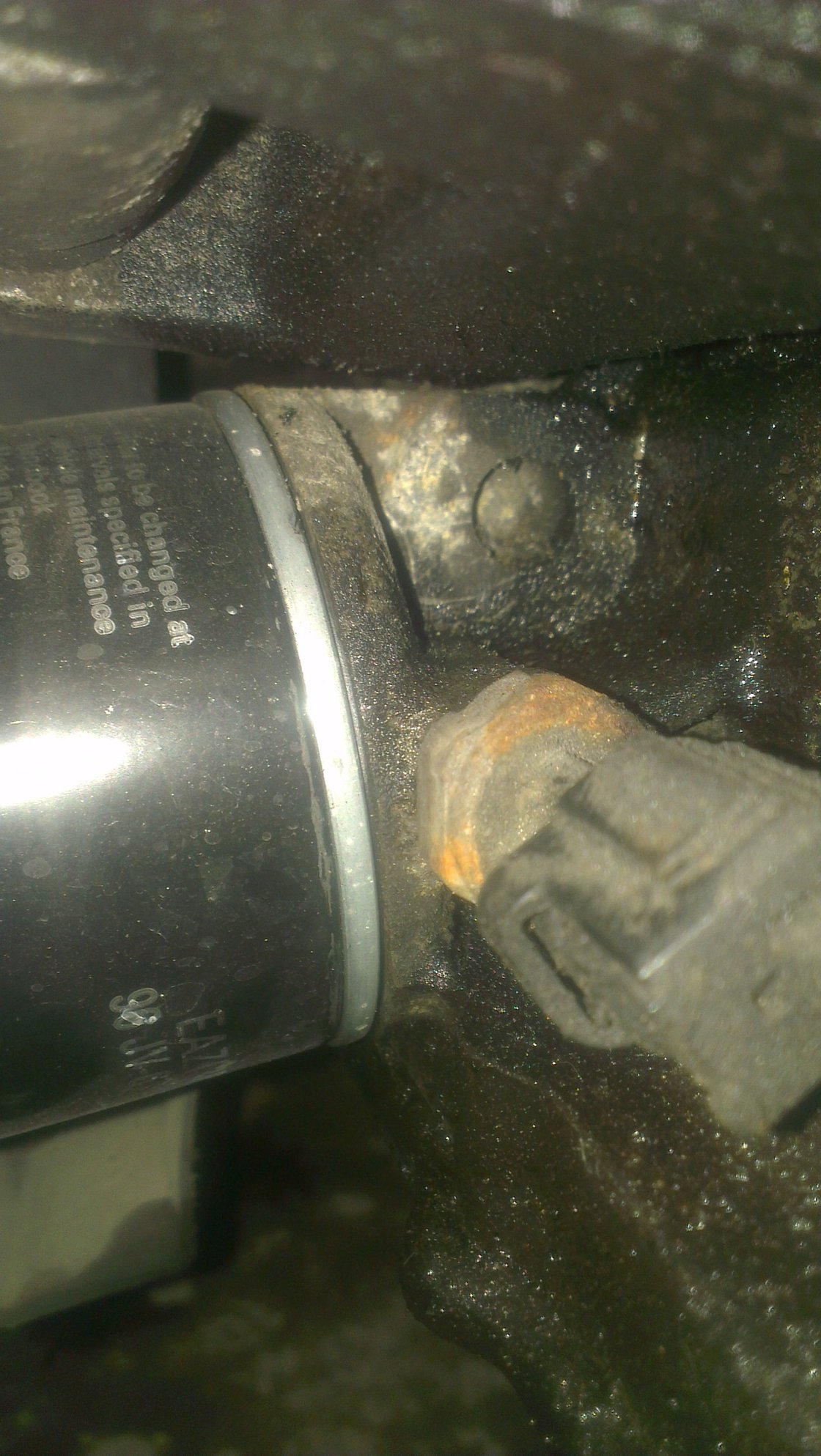

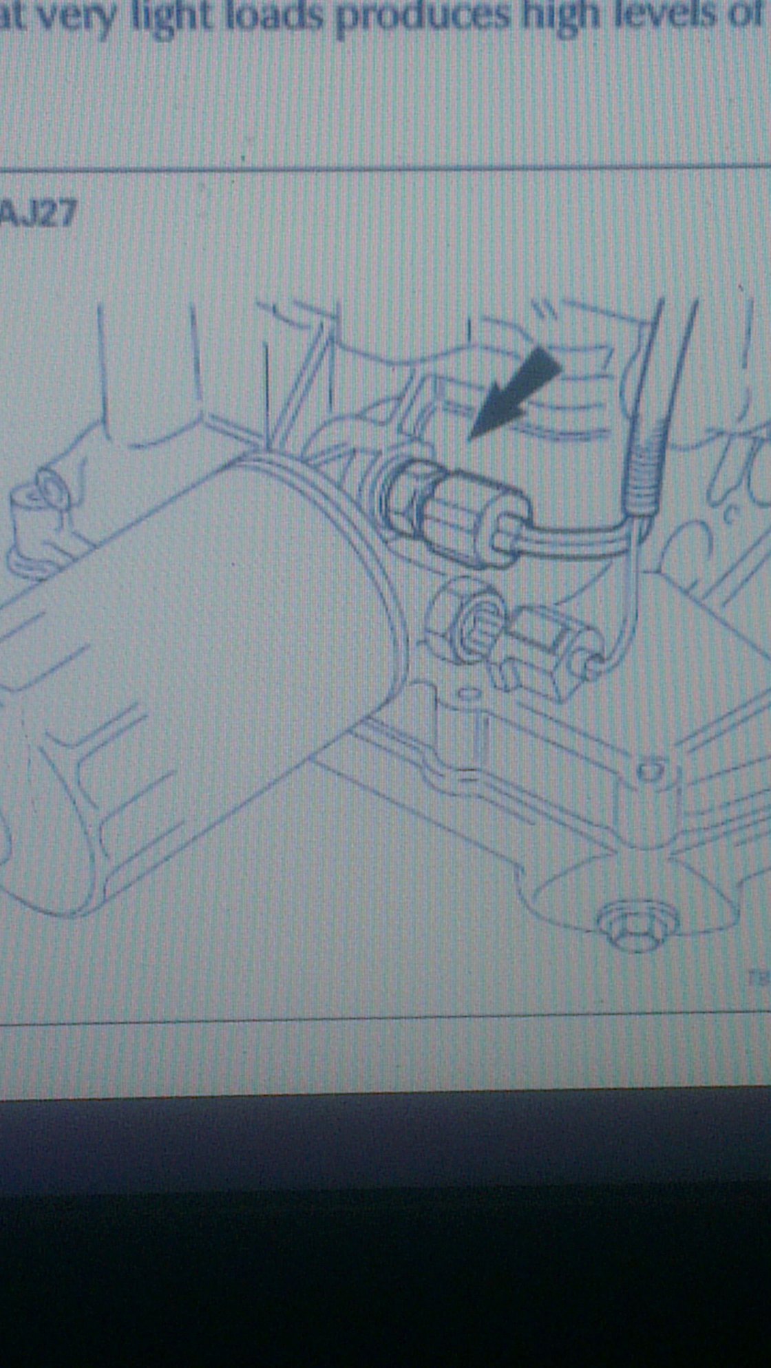

Yes it will cause a CEL, I was getting the Cell light because of oil temp p**** codes..
So got a new oil temp sensor ..
When i went to change the sensor i found that it was just hanging near the oil filter !
Reason for this was the PO must have tried to change the sensor and SNAPPED it off !
So if you do have a go at changing this sensor, take care not to do what the PO did to mine.
Others may have some tips for changing this oil sensor,

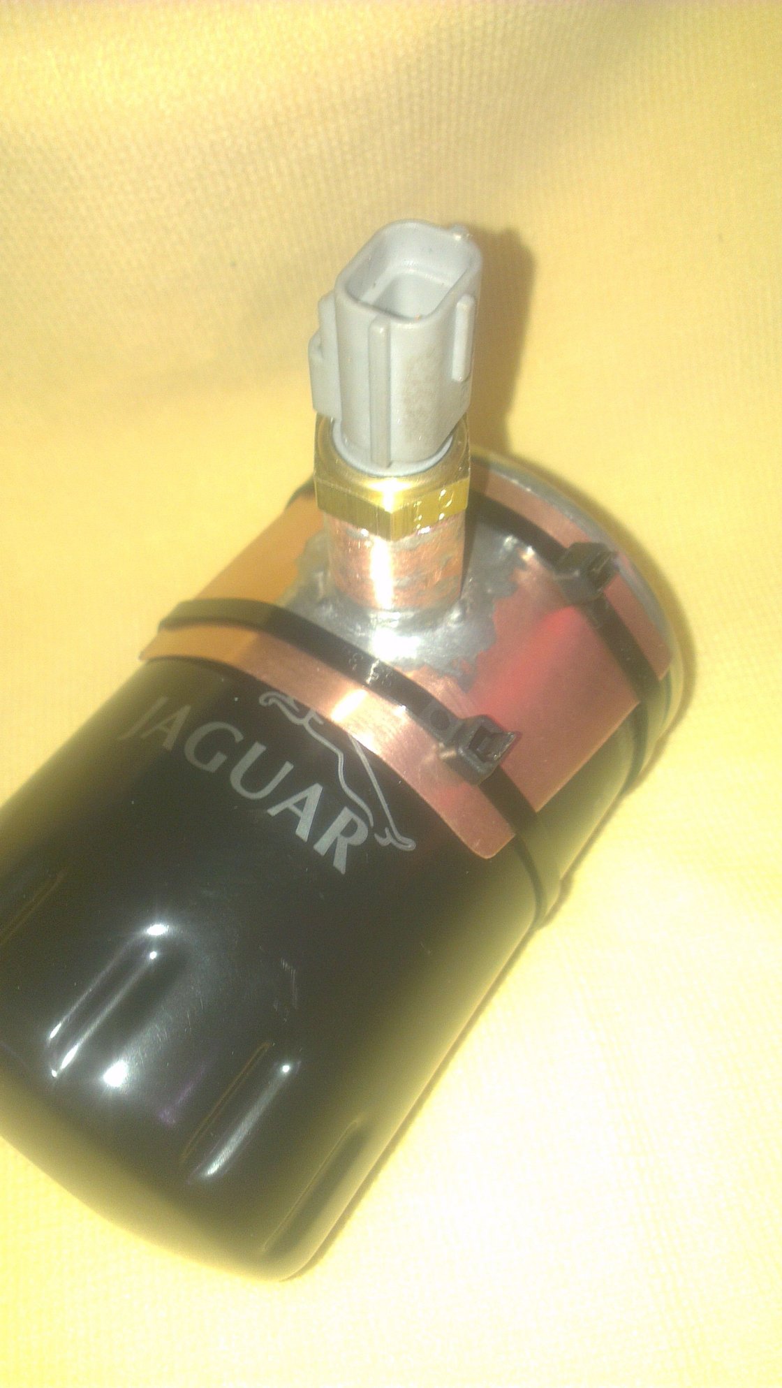

I never got to remove the snapped off sensor and came up with a hack way to attache the new sensor directly to the oil filter, and all is now well with no CEL light/codes for the oil temp sensor.
Some photos .........
LOCATION OF OIL TEMP SENSOR ^
MY SNAPPED OFF SENSOR ^
MY HACK/FIX TO STOP GETTING THE CELL AND P**** CODES RELATING TO THE OIL TEMP SENSOR
Good look and proceed with caution..........
