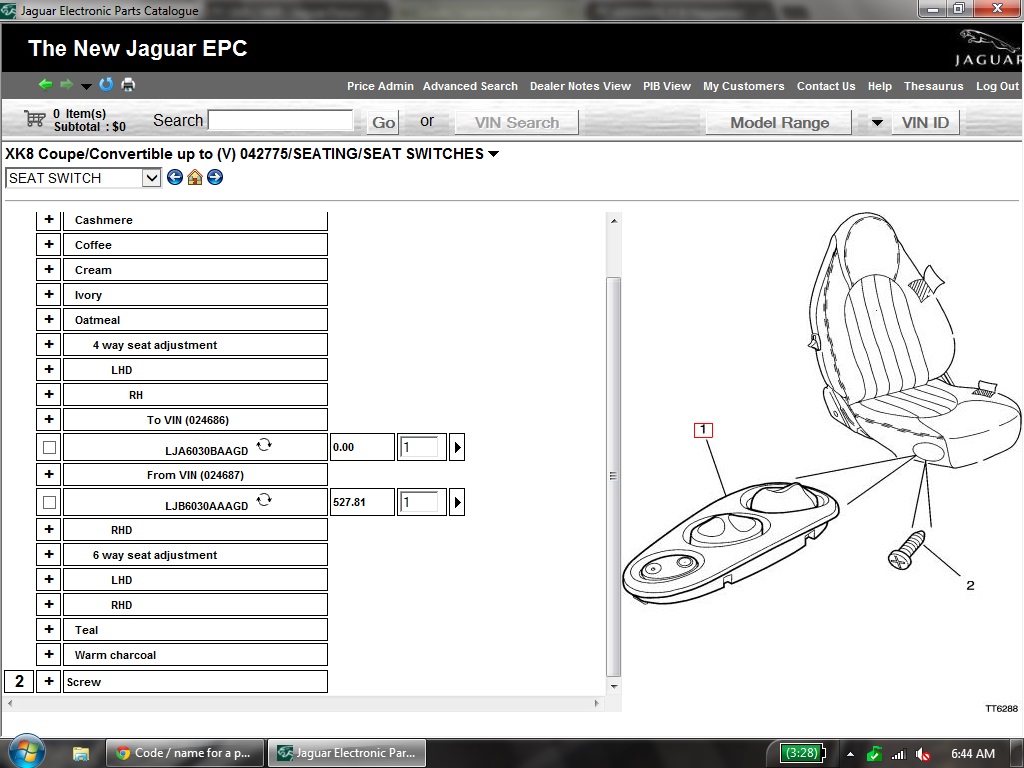

The symbol means that the part number has been superceded by a new one.
When I checked that online I found LJE6034ABLEG
These crop up on ebay from time to time as well, so you might try there also.
Good luck!
Code / name for a part ( seat switch housing? ) and colour codes-seat-switch.jpg

So is AGD oatmeal? I know that's what it says in your screenshot but I wanted to be sure before I go and spend my hard-earned on the wrong thing.

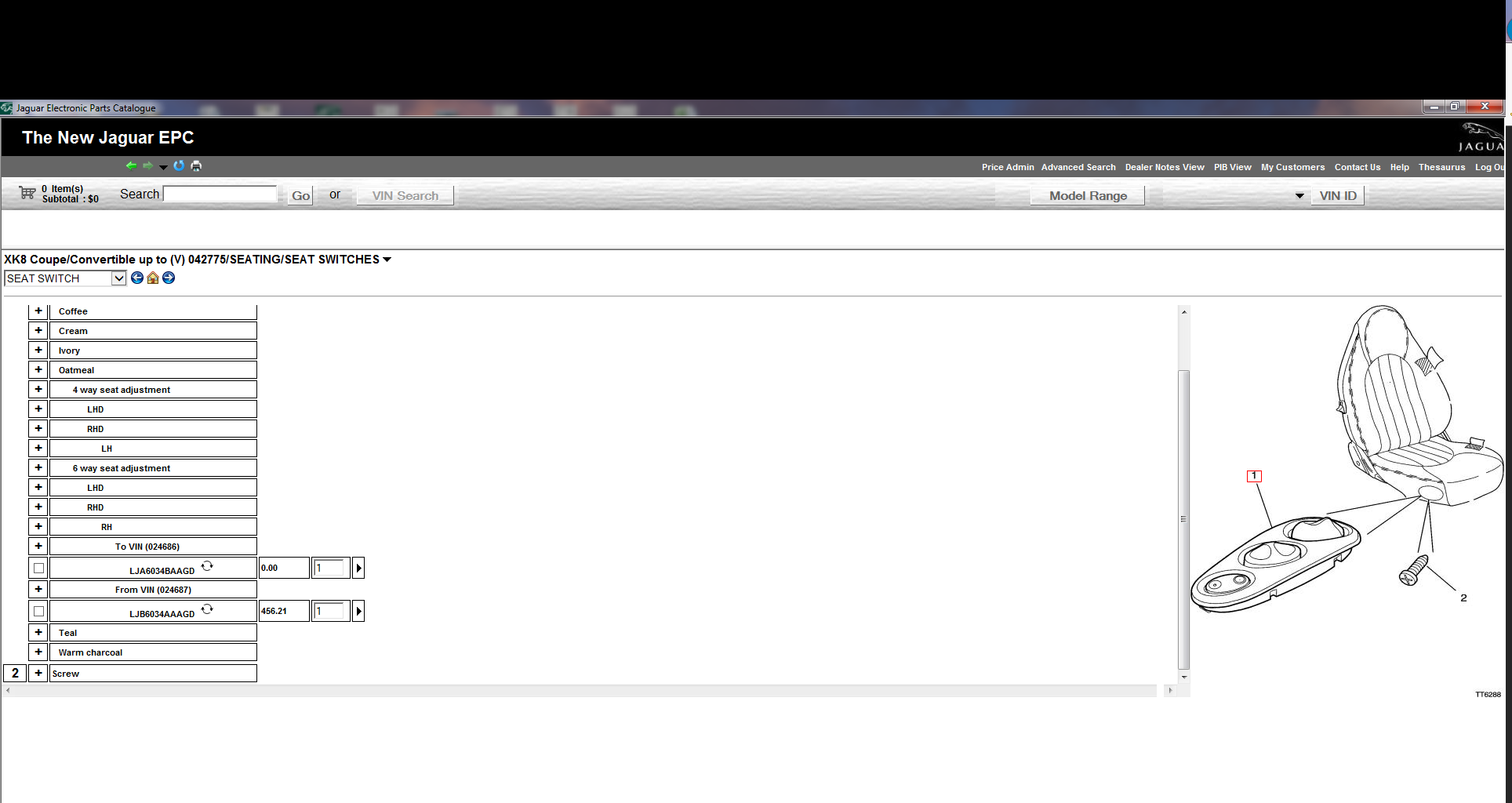

Charlie beat me to it but you are in the UK so I believe we are looking at the driver's side of a RHD XK. If so then:
LJA6034BAAGD To VIN (024686)
-or-
LJA6034BAAGD From VIN (024687)
Attached Thumbnails Code / name for a part ( seat switch housing? ) and colour codes-jpc-seats.png
Yes, AGD is Oatmeal.

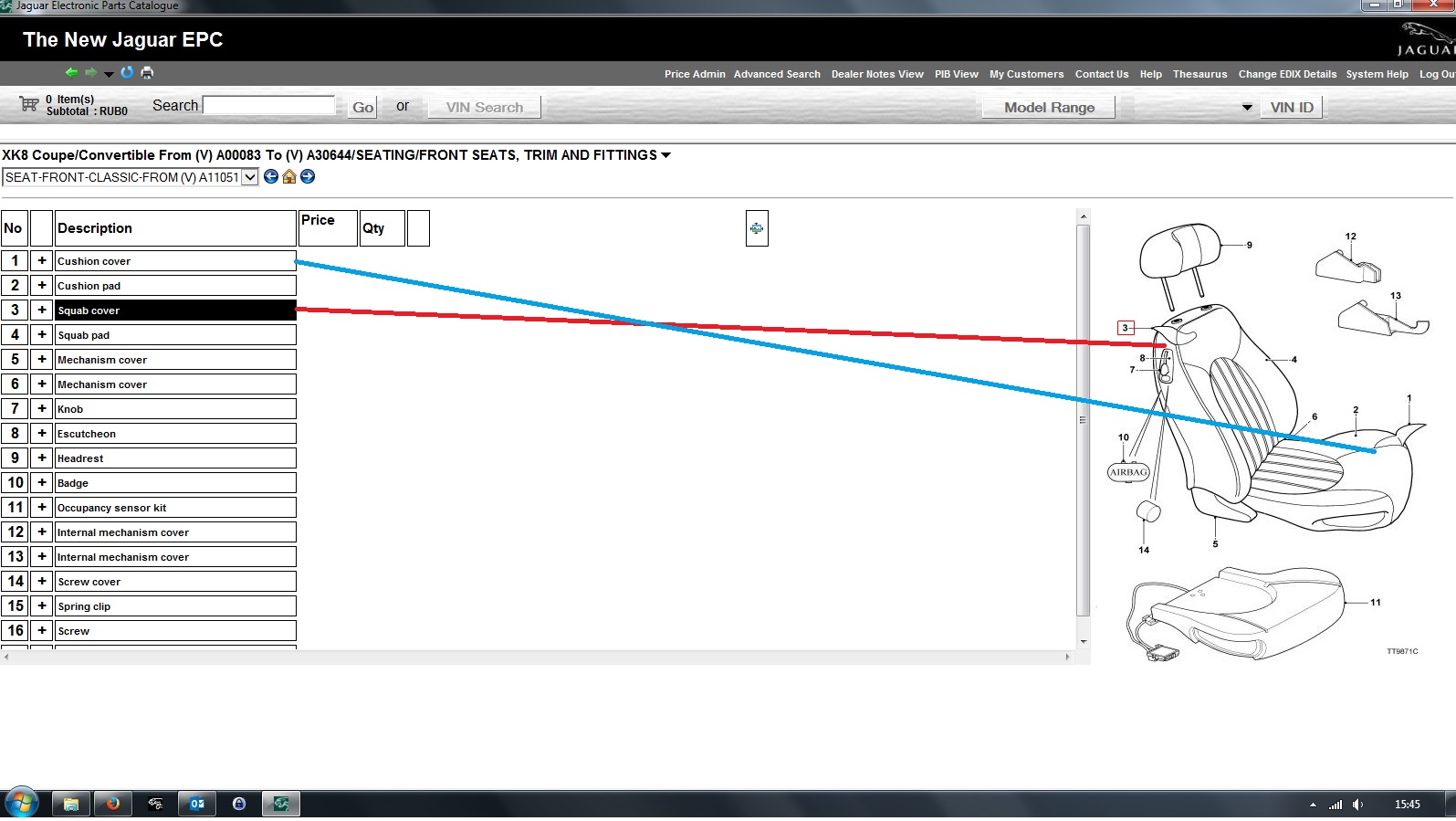

and I had one breaker insist its called SQUAB ... I begged to differ....
Old Aug 14, 2014 | 09:50 AM
You sit on the CUSHION and rest your back against the SQUAB:
Code / name for a part ( seat switch housing? ) and colour codes-seat.jpg
