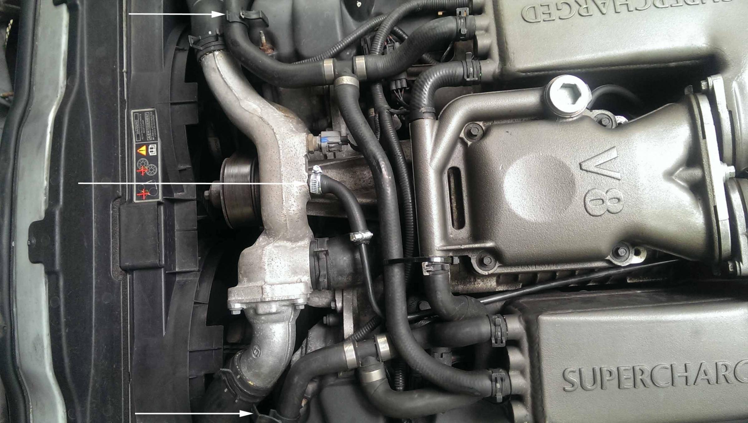

So on searching the threads it seems these codes are often due to leak from air hoses/MAF etc. I have had a good look around the engine bay and can't see anything obvious but have not checked with "propane" - not sure I fancy that idea - I do have some stuff I use for checking for LPG gas leaks on my boat but probably not useful here. The only thin I have notices is that the clips on 2 of the vacuum hoses are broken but i can't fathom where they would normally clip too anyway. The air box lid is tight and the fuel filler cap likewise.
The overflow pipe from the coolant expansion tank has a repair where it goes back into the engine - I have a complete replacement pipe ready to fit but I can't see that this would cause an air leak.
White arrows on pipes copy.jpg show broken clips and the repair to the overflow hose
Any advice gratefully accepted - in the meantime I'll just wait and see if the codes come back.
