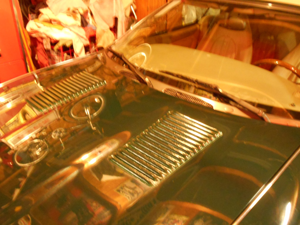

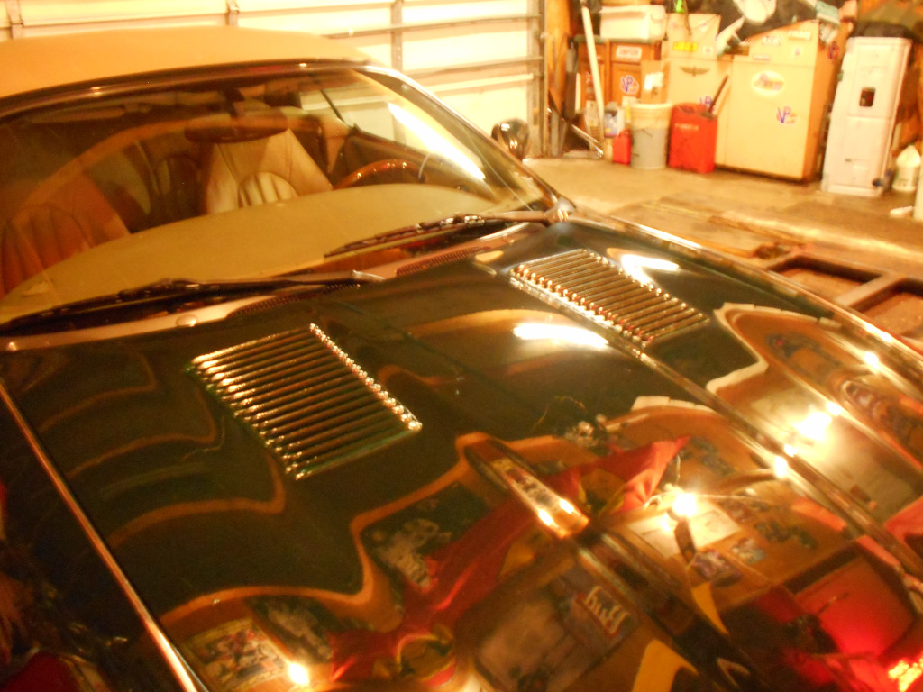

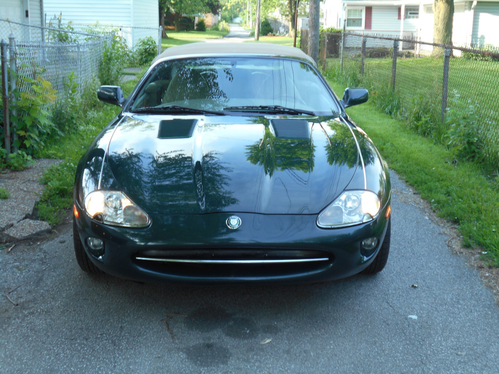

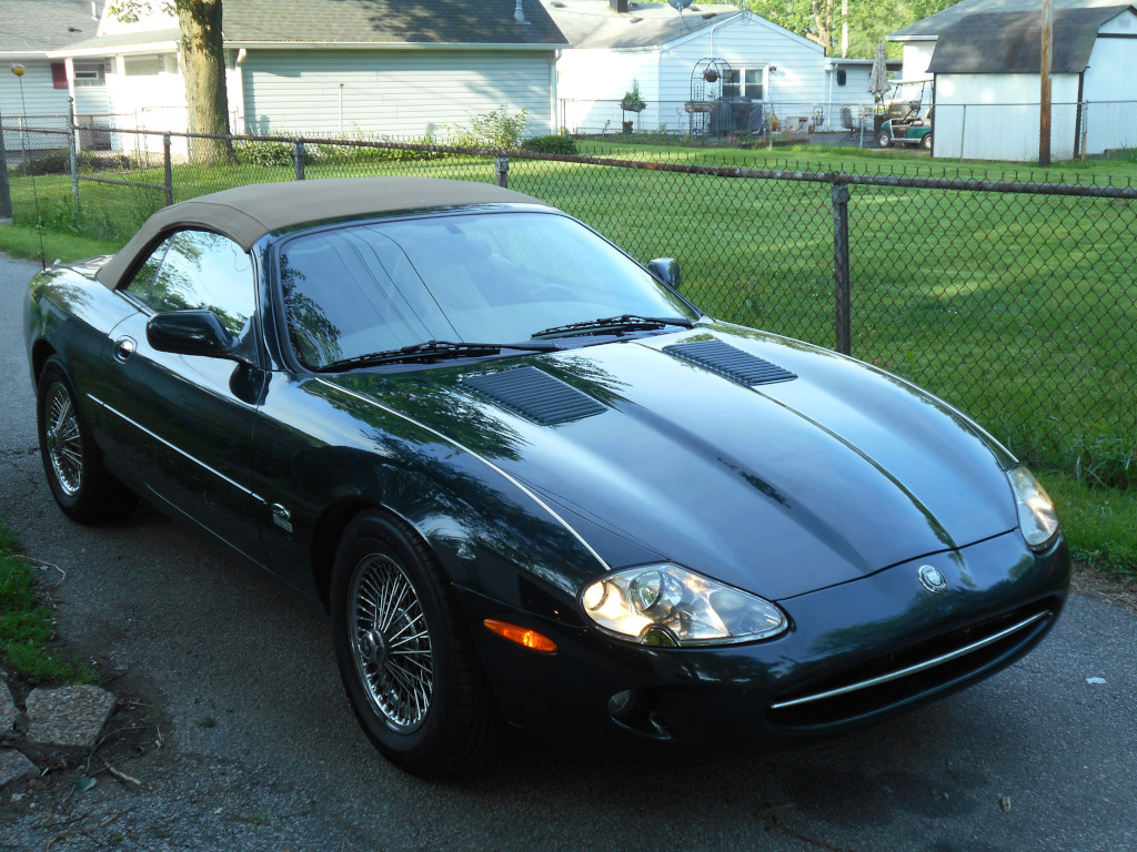

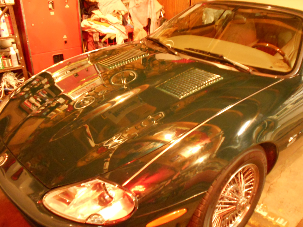

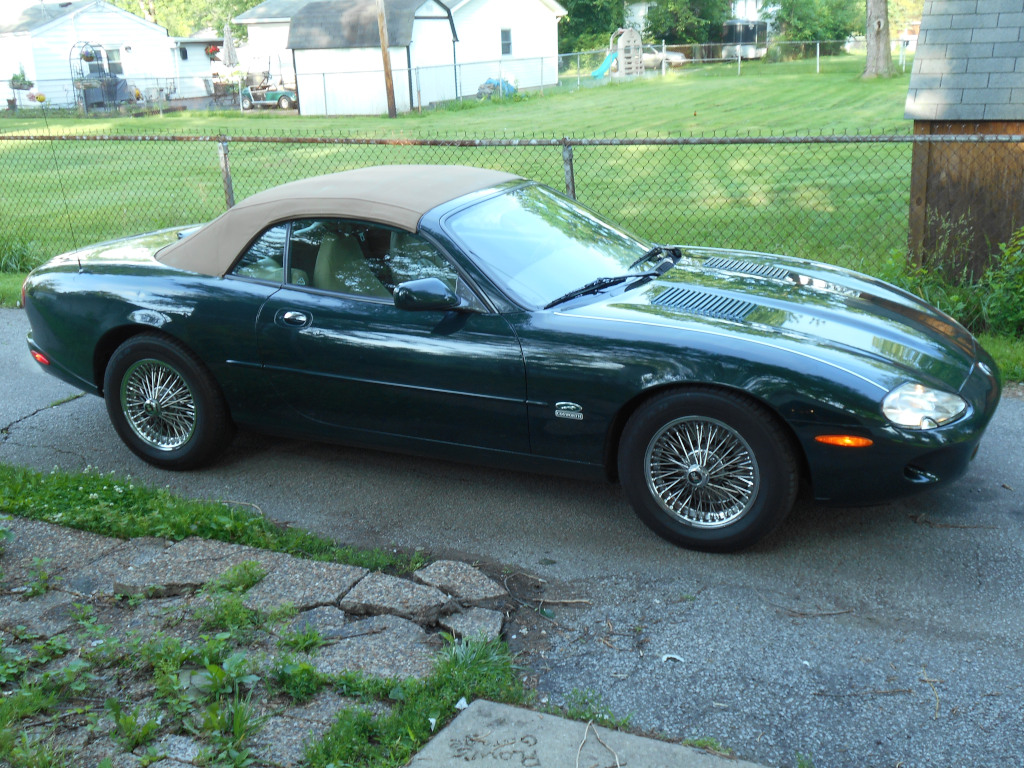

After a wee bit of work, I was finally able to convert my XK8 into a comfortable E Type. All that is left now, is getting the trunk to stick closed when I get a flat so a Jag technician can drill a hole above my license plate to get in, make the trunk so small I need to put my luggage on a rack in the rain, over heat in traffic while killing my 10amp Lucas charging system running a 15 amp electric fan, not be able to hold a conversation with the top up or down, and strip out a hub on a long trip.
I used louvers from the hood of a late 20s early 30s car, because the aluminium ones sold on Ebay were all not wide enough, and would bend too easy(we haven't been able to figure out what year the car was, but I don't think a pistol bullet could penetrate it)
I sand blasted and painted it with paint from Automotive Touch up and Paint. They are not functional, because of all the electric goodies underneath. I still have time to screw that up.
I am happy, and the car won first place in the import class(the tuners were real pissed at that, including one that wrapped his car in chrome) at the Police Department's car show The rain even held off, and my wife thinks this is all I am going to do with my JAAAG, as Jeremy Clarkson says....There is always the exhaust?.....Be cool....Mike

Mike, very nice. The louvers are perfect. Great vision and execution of you tribute XKE Jaaaaag.....
How about a close up pic of the louvers from the side, rear and front......

I hope if you can click on the pictures, they will get bigger. Right now we have a monsoon happening, hail, 72 mile an hour gusts expected, and tornado warnings out, until 8:00pm. I'm glad we are driving my wife's Jeep Cherokee to her dentist, over an hour away. I will try to get some close shots in, but I kind of shake. Look tonight, or tomorrow......Take care....Mike

Very nice, Mike; you are a true craftsman. And congratulations on winning first in class at the car show with the Jaaaag. The other things you must also be missing about the original e-types are: floor pan rusting out and the transmission tunnel starting to bend in two, having to pull the engine and transmission to change the clutch, which wasn't too strong to begin with, not being to see out the cloudy rear plastic window, and the risk of heat stroke in the summertime with all of the heat emanating from the engine compartment. And as always, the Lucas ignition system on a rainy day. Enjoy.

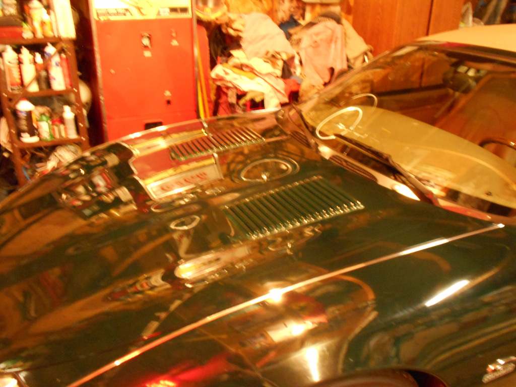

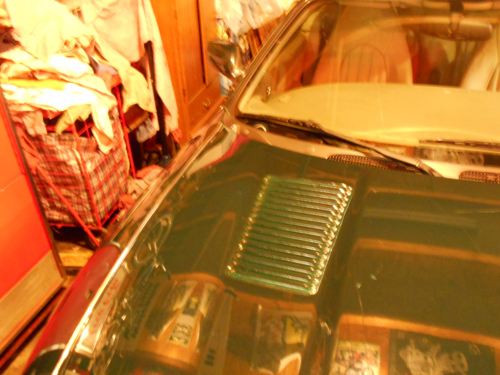

Here are the Pix, up closer.......Mike

Nice, thanks. What do they look like from the rear or drivers view. Are the louvers open with the bottom welded closed.
They are just secured to the top of the hood, with some epoxy, and rivets. I left the bottom closed because there is nothing but electrical goodies under where the louvers sit. The rivets are getting painted tomorrow, when I have a little time.
They could have been functional. As for the drivers view, you can't really see them, when you are in the car, unless your head is touching the roof. Hope I didn't disappoint you with them being just a set of functional louvers from almost a hundred years ago, being glued and riveted to the hood.
Where they sit, is over the AC unit, and wiper motor and both banks of the engine, with very little space for a water deflector. The nice hood pad would have been ruined also. They are longer than what they look, and our engine compartment is smaller than what it looks. At any rate, it was the best I could do in a couple of days.
Cutting them out of the old hood was the real bugger, because if you cut too close, they would fall apart, and too far, they would look like cr+p with a half inch of metal surrounding them. They have about a sixteenth of flat metal around them, with a few double sided tape spacers under each one, so the water could run out, if it rains. All I had was a die grinder, because the metal was so thick, and 2 cutting wheels.
They have 4 coats of primer filler, to remove some age, and 3 coats of color, and 3 coats of clear. They will dull up a little, because clear always does in the sun. If you want more info, just ask

Thanks again for the info, you did a great job. Unless you had said they were stuck on I would never had known from the pic'c..

The first time I saw your post and photos the first thing that came to my mind was "why?". Then I looked again and convinced myself that the car looked decent even with the pseudo E-type look. I didn't initially like the placement of the louvers but figured that at least they were functional. But now it seems they are NOT functional. So I come back to "why?"

I had an original E Type, when they were selling new for around $4500. All of Hollywood, and anybody who was anybody had one, even though they could buy Ferraris for only 5 times as much. Steve Mcqueen even had one.
I loved the looks, and driving it, but they were far from fine cars, as you have read in the posts above. The nice ones now are all between 60 and $80,000. I always missed my XKE even though it was a mechanical nightmare, that would rust sitting in the show room. I sold mine for $2000 in 82, and was glad I got that much for it. We left 2 of them behind the back fence when the dealership I worked at moved, because they just weren't worth anything.
Mine was British racing green, and when I found this 99 with a few problems, I knew I was going to do this to it. I would put the growler motif on the front chrome bar, but it already has a stock one on the bumper. As for the louvers, I needed 8" to 9" wide ones for them to look proper on this car, and I could not afford real punched in louvers. I could not use aluminium louvers, because they would get damaged very easily.
I drilled the mounting holes first, to see exactly where they would come down over in the engine compartment, and they would be sitting right over a bunch of expensive electrical stuff, not to mention the spark plugs, and coils, which short out very easily on these cars.
I had functional louvers on my Corvette, from a wrecked 24 hrs of Daytona race car hood, because you can run a Chevy small block under water, if you had a snorkel. That is why the Jag's aren't functional. I make all my cars just a little different, because I think of some cars as art.

I think she is pretty much done. If I wanted more chrome, I would have mortgaged the house again, and purchased another XKE. I have thought of maybe a chrome luggage rack on the trunk, but haven't decided if the rear end is too high. I am thinking of dropping it a couple inches, but want to do it right. Other than than those possibilities, I think my mods are done.
She attracts a lot of attention now, including folks taking pictures of her at the beach, so long as a long grey haired 70s throwback kind of dude isn't standing next to her.
The side moulding will need to stay where it is, for the reason that I can't afford a repaint, on what the government gives me on disability, and the other reason is that my wife won't park far enough away from me, to keep from hitting the side of my Jag with her Jeep doors. She doesn't slam her doors into my cars, but doesn't take enough care to avoid contact. I pull in the garage backwards, and she drives straight in. It wouldn't matter if I pulled in differently, she would just hit the other side of the car. I am going to buy foam pads, I saw in a magazine, to save my car, as well as my mental health. To her and her family, they are just modes of transportation, and their cars look like it. I put a wheel stop(cement block), so she doesn't ram the back of my 928S. 5 years ago, I needed to use hydraulic jaws, to move out the right bumper shock, because she accidently tapped it. She isn't in to what I like, and I am not in to what she likes.
The badges under the leaper are simple Cosworth badges, since our heads were assisted in design and made for the 4.0, and 4.2 by Cosworth. I have had 2 Cosworth head cars, the Sierra RS Cosworth(RH), and an open wheel car with an early 80s Cosworth engine(the Cosworth Vega I don't consider one, because it was slower than a stock Vega) and helped set up a mid 80s Cosworth Indy engine. Like I said.....I used to be someone. I noticed the familiarity in design, when I changed out my upper chain tensioners, and research brought me to this little known fact, that for some reason Jaguar has kept hidden.
I think having Cosworth written across those massive cam covers would look a lot more impressive than the cheesy plastic they put on. The valve angle gave it away, and as I see it also opens the doors for someone willing to make a lightweight high compression piston for our cars. Looking at our bottom end, I am sure it could take a higher compression piston, except for the supercharged engine, which for some reason has smaller journals. We would probably just need to bump up our octane, so the knock sensors wouldn't have a nervous breakdown. Sorry for your dislike, but Cosworth has always meant something special to me. Glad you like it.......Mike

Hi Dan L.......If you look at my latest album, I did put the luggage rack on. I have had a lot of positive comments on it, and even an offer on the car. With all the work I have put into this $3000 car, and the luck in finding parts, I don't ever think I could build another one just like it. It is like my 928S, except I mortgaged my house for that one.
They were built for people way above my station in life, as the sticker price shows, so I take someone else's trash, and restore it. Being 57, I don't think there are many projects like this left in me, but you never know. I have always wanted a front engine 12 cylinder Ferrari, but just haven't found the right barn yet.
I did make the hood louvers functional, like I was kind of goaded to here, but after the first heavy rain, my suspicion's were confirmed, and I had to put water deflectors under the vents. The vents are still functional, but the deflectors keep water out of the spark plug holes....Thanks for liking my car.......Mike
