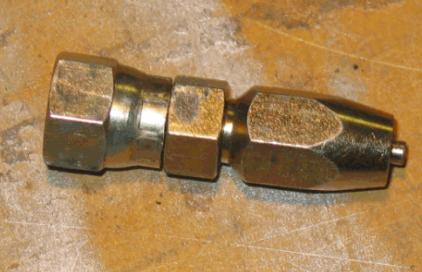

Just the other day I installed a short version of this new hose set. Well my attempt to make a short version has been blown away by a leak that redeveloped on the old hose at the connector. At the present time a short version is not available.
After installing the short version I did verify that the hose kit fittings we came up with will work. My concern was that the new fitting may not fit in the bulkhead at the latch. It is snug but it does fit with no room for error. However, what I did find out was that Jaguar/Powerpackers connector that was supplied with the old hose kit is a real problem and gives out. This occurred after being installed for only a few weeks. I went back on the install and identified where the weak spot was. I am now looking for another splice kit. I have an idea how it can be improved but need a connector kit. If a set is removed and you can send it I would greatly appreciate it.

If this works this is what it looks like.
Attached Thumbnails  Convertible top latch hydraulic problem-hoseconnector.jpg
