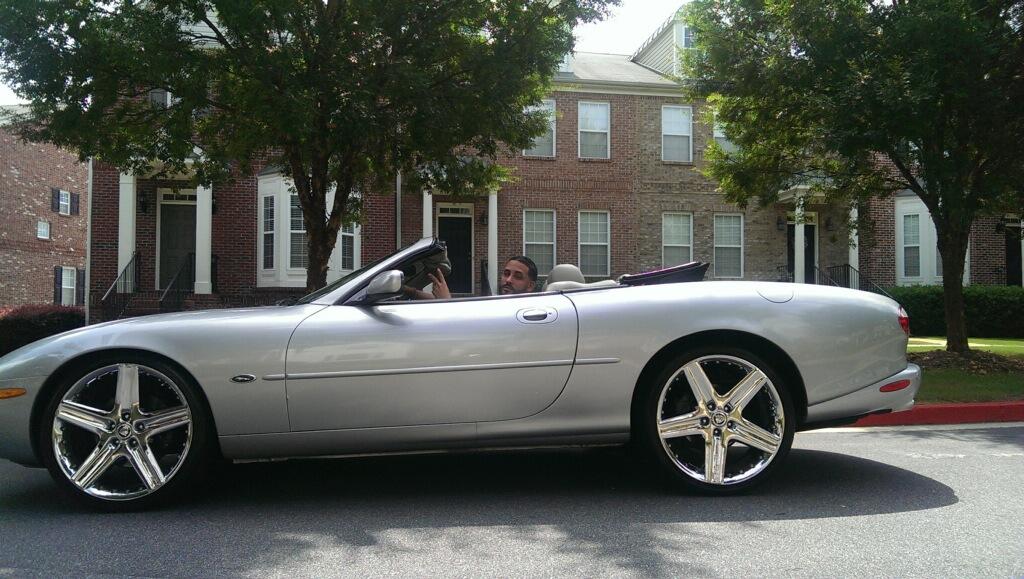

Thank you Hayesja8 for the 5 stars two thumbs up rating! I have attached pictures of Hayesja8's Jaguar XK8 shortly after the repair. See Below
I wish all of my customers posted their experiences with on the Jaguar Forums. Finally a few of them have posted comments about their experience with the Jaguar Green Shower Leak Repair Service.
If you own a 1997 - 2006 Jaguar XK8 or XKR have gotten the Jaguar Green Shower and in need of a quality Jaguar Green Shower Leak Repair Service, please take the time to inbox Hayesja8 and ask about his experience.
I would be happy to give you a few referrals.
