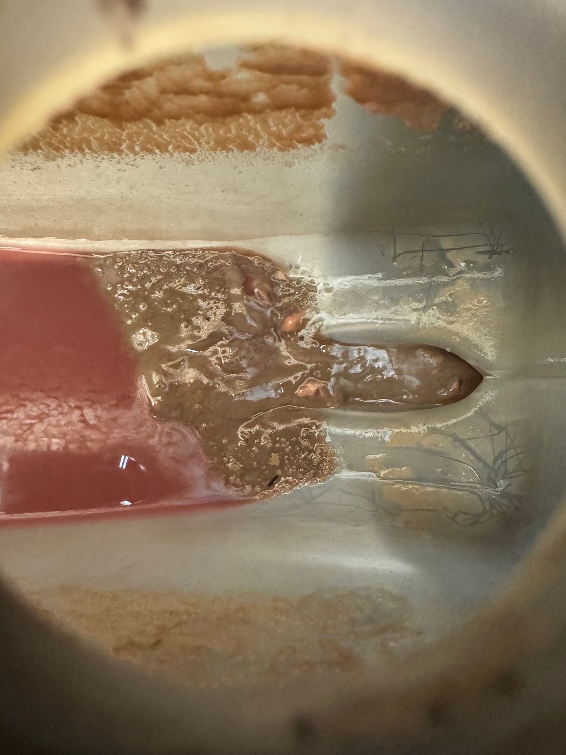

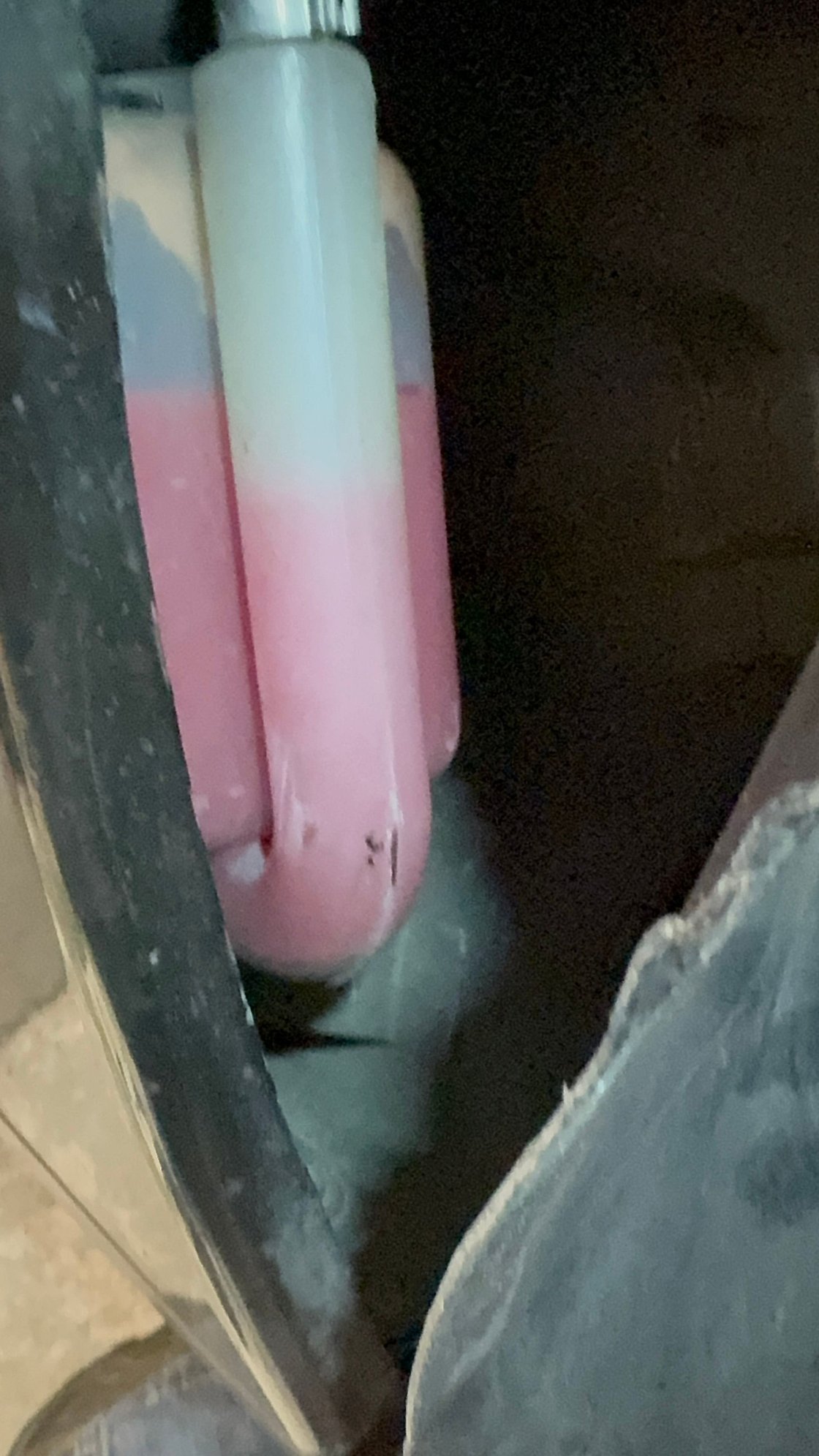

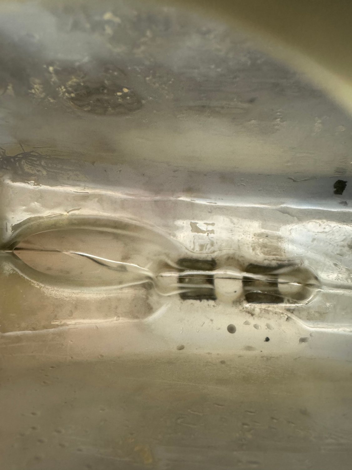

I had the same problem and it turned out to be sludge in the overflow bottle in the right hand wing. It is easy to get to and remove. It was not obvious from looking at the clean coolant within it, before removing it, but once removed found sludge in the small tube entry orifice. Cleaned that out and much better now, not a top up bottle float problem at all.
What prompted you to check the overflow bottle? And why would sludge be the issue?

I believe that fluid moves to and from the overflow bottle as the temperature of the engine changes. The sludge was preventing mine from allowing this to happen fast enough, so when sat in traffic and the engine got hot, I would get a low coolant warning, but when going again, the warning would go away. I put my ODB scanner on and monitored engine temp for a whole drive and found it was fine and not over heating at all, but when it got hot for a little while, the low coolant would come on.

The SKP tank from rockauto arrived today. However, before installing, I'm going to check the recovery tank for sludge. The pictures you posted are quite convincing and the symptoms match mine.
I'll clean it and then drive the car until it's hot enough to see if the low coolant warning returns or not. If it works, I'll just keep this tank for when the current one fails.

I just got done with inspecting and cleaning my recovery tank. It did have sediments, and sludge, but much less than what your pictures showed. The hoses to it were clean.
