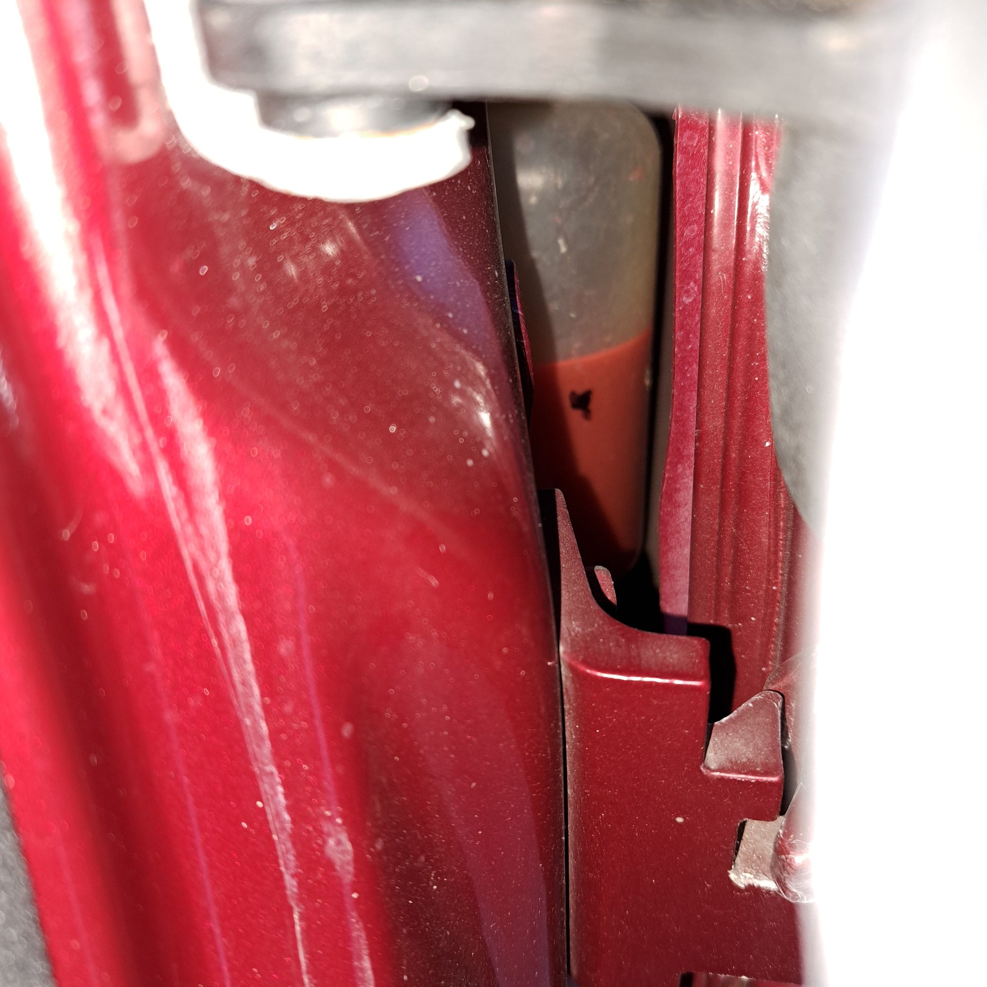

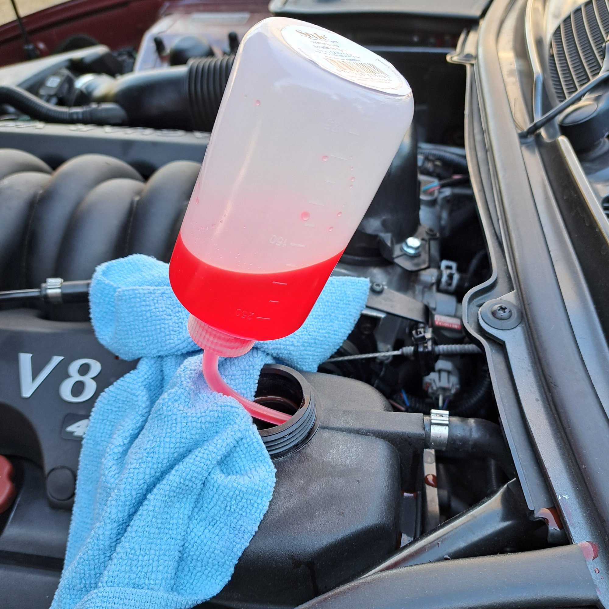

I had been getting intermittent low coolant warnings before. I would come home; let it cool and top off the expansion tank. Later same issue. Upon review of this site, I found out about the Atmospheric Tank behind the front right wheel well. I had already lined up my son to help me take the wheel off and then started looking and thinking a little deeper.

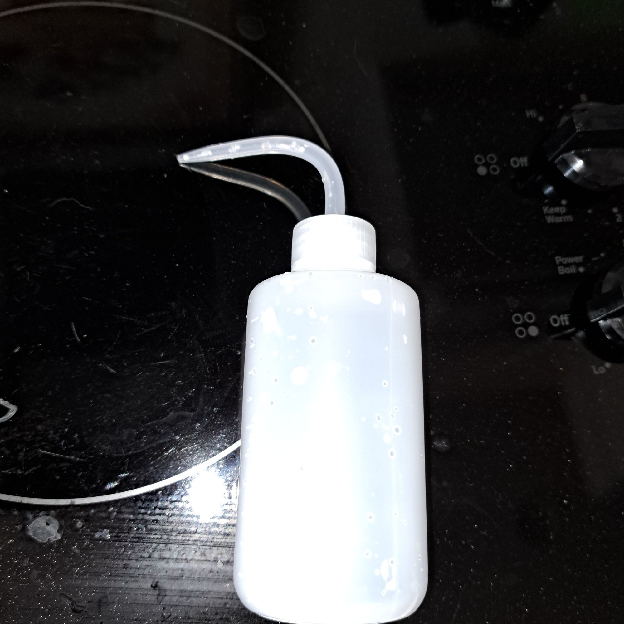

I noticed while looking through the gap in front door as others had mentioned that the tank looked completely empty. So, I went to auto parts store and got some anti-freeze and then to the local hardware/plant store. I figured that if I had a small enough hose and squeeze bottle, I could fil the tank from the expansion tank outlet leading to the back hose.
The small plant bottle pictured did the trick. It held 250ml. I filled and refilled until I had put 750ml into the Atmospheric Tank. Now, you will see in the picture that it is just over half full and slightly above the small black mark I made before driving around. I also think it fixed my cabin heating problem. It never got very warm in the cabin before.
Less than $4.00
Less than $4.00
I stuck tube directly into small opening in tank
See small black mark on tank when I finished filling
