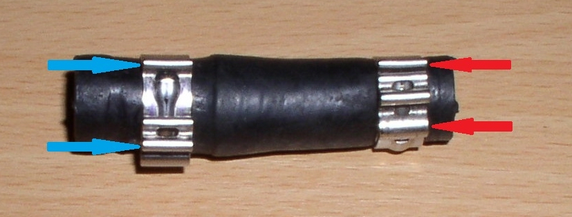

The CLOSED clip is on the right; the OPEN clip is on the left:
To OPEN with a pair of pliers, squeeze the two shoulders arrowed in red together.
To CLOSE, squeeze the two shoulders arrowed in blue together.
It doesn't require much force to open or close these clamps.

Thanks for the photo and explanation. I now understand.
John
