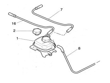

Evolution of the XK8 Cooling System
There is no bleed screw. The early 1996 XK8's had 2 Bleeder Hoses on the Expansion Tank:
1. Tank to Thermostat Housing (item 7)
2. Tank to Radiator (item 16)
The original Jaguar recommended filling method was through the screw-on Thermostat Housing Cover.
The Bleeder Hose (item 16) from Tank to radiator was soon dropped as unnecessary and the second outlet from the Expansion Tank blanked. At around the same time, Jaguar also stopped recommending filling through the Thermostat Housing Cover and changed to filling through the Expansion Tank Pressure Cap (item 2).
As others have said, the system should self bleed as the Expansion Tank is the highest point. However, bleeding can be helped by squeezing the upper radiator hose with the Expansion Tank Pressure Cap removed (only on a COLD engine!) to force out any air.
