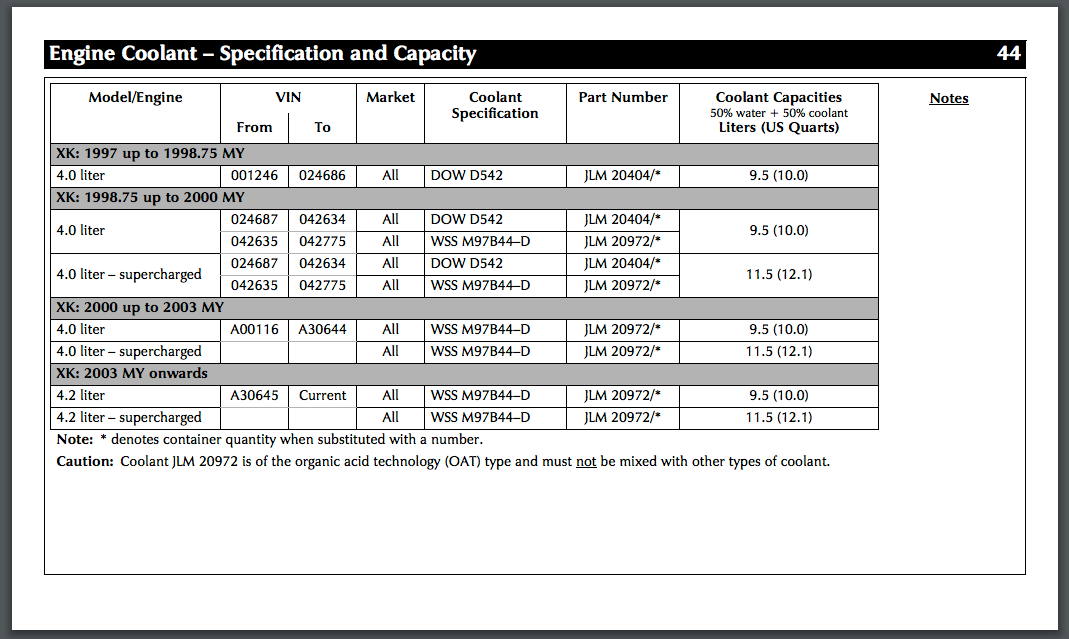

Old Jun 2, 2016 | 09:07 PM
Sir Alex of Yotto's Avatar
Joined: Jun 2015
Posts: 114
Likes: 20
From: Palm Beach County, FL, USA
Default Dexcool for 2000-to-? Model Year
In the Jaguar Vehicle Specifications book (dated 9/2003; see attachment), it states that XK8s -and- XKRs from MY 2000 to 2003 are spec'd to use a coolant that meets WSS M97B44-D, and the stuff I buy at Wal-Mart for about $15 meets that spec (also see attached pic and URL).
I've seen the much more expensive MotorCraft Orange (about $30 or so) that meets that spec, but, why pay more? If there is a good reason to do so I will. Otherwise, I get the DexCool at Wal-Mart (used in my 2000 XK8).
Prestone Dex-Cool Extended Life Antifreeze/Coolant, 1gal - Walmart.com
BTW, this coolant is also spec'd for SOME pre-2000 XK8s and XKRs as you can see, so check the numbers carefully. Also, since this specification book was published in 2003, there are vechicles beyond the 2003 MY that will use this coolant as well; seems to me I've seen elsewhere that it is used up to 2007 MY in some Jags.
As others have stated many times, "READ YOUR OWNER'S MANUAL" for the correct coolant to use.
To toss a red herring in here, it has been seen on other forums that newer HOAT coolants are a superior replacement for OAT coolants (this Dex-Cool, for instance) in all vehicles, but, I cannot confirm that without more research.
Attached Thumbnails Correct coolant?-dexcool.jpg   Correct coolant?-xk8-coolant.jpg
