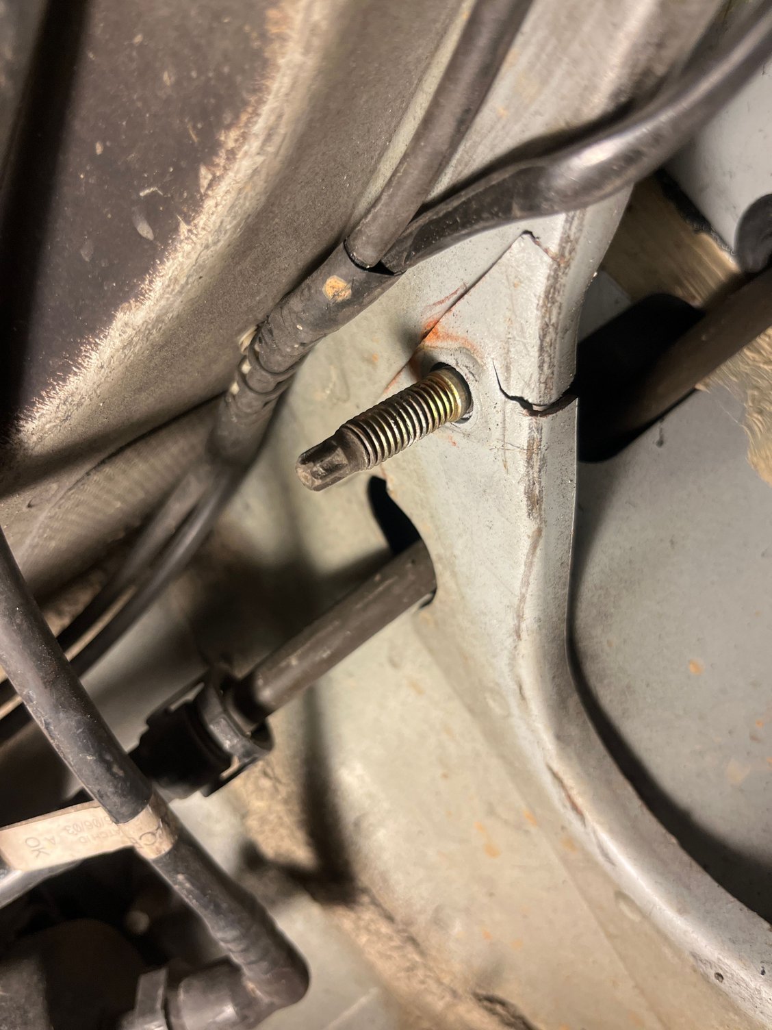

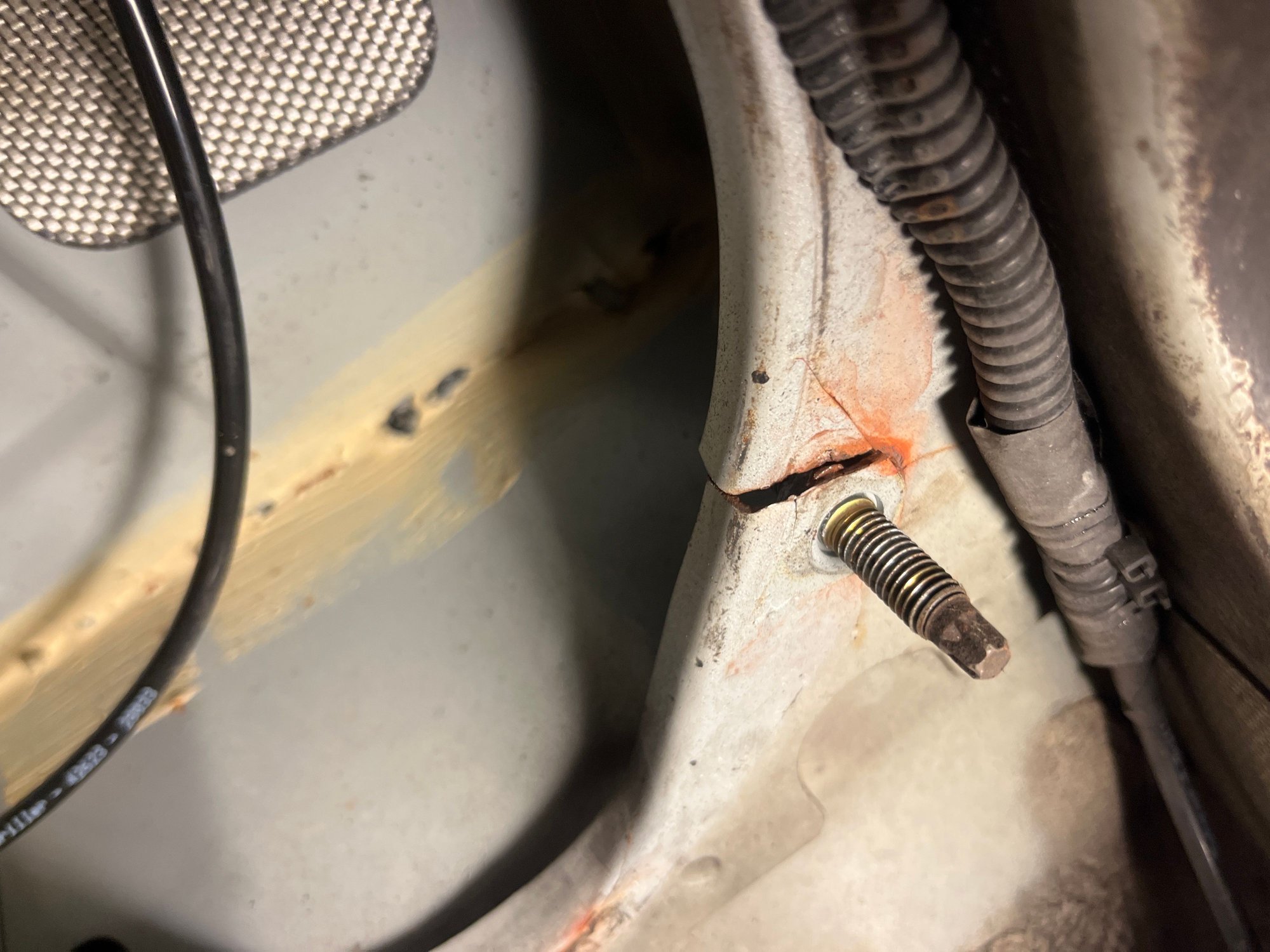

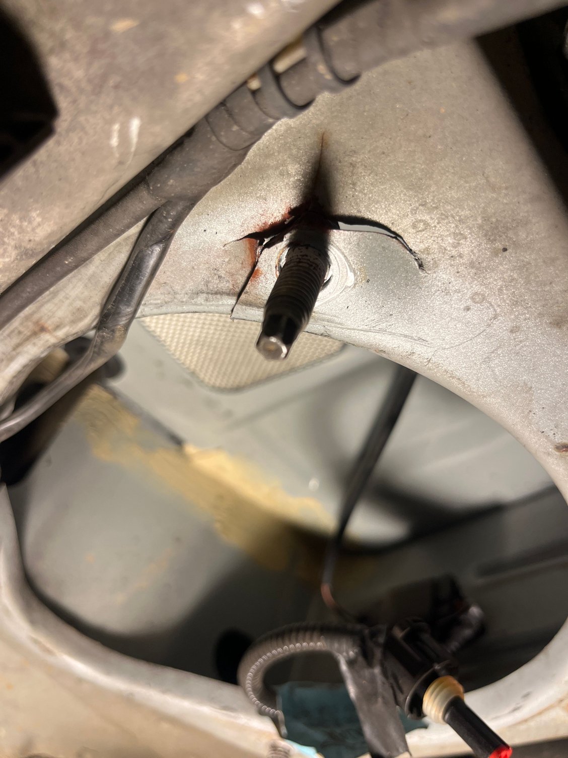

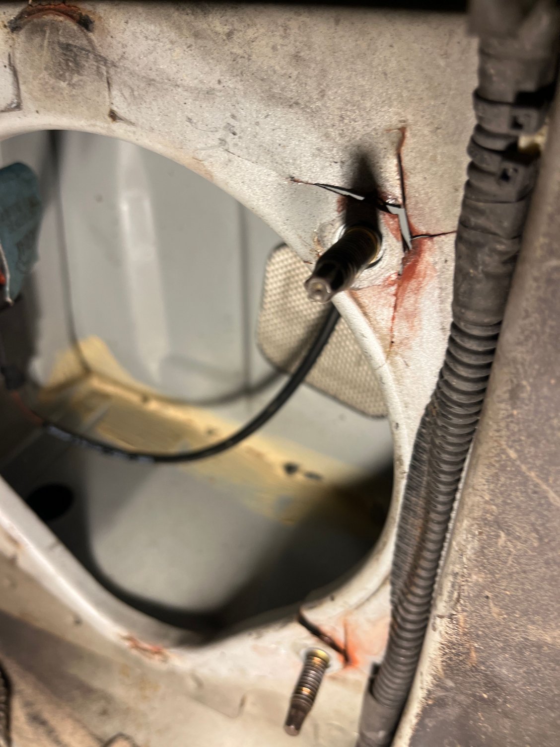

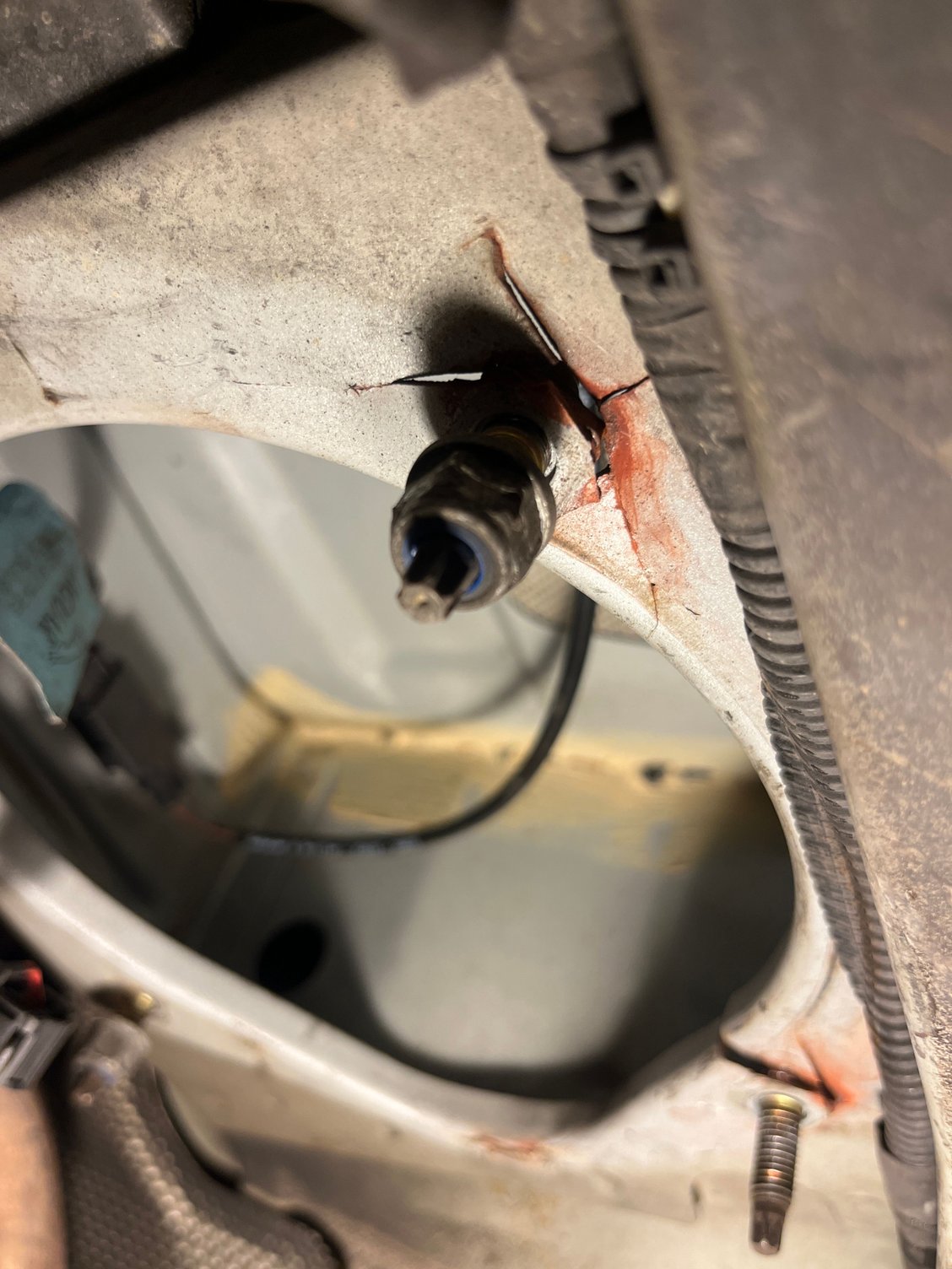

This is a nightmare situation.
Steve’s rear shock mounts arrived. I removed my rear shocks and got around to swapping the foam isolators for the poly isolators.
When I was ready to put everything back in place I encountered an Eldritch nightmare. The metal around some of the studs fatigued and cracked.
I was able to find a welder that can come to my house to cut and weld in a new patch and reinforce it.
With the rest shocks removed, would that be enough space for him to work with or should I remove the entire IRS? To make matters worse, it happened on both sides.
The degrading foam mounts may have actually saved my life. To keep on driving like that would have been very dangerous indeed
Yes, I’m concerned about that fuel line. I told him about it.
This could possibly be the rear suspension creaking I haven’t been able to locate for the past 4 years.

Good catch and looks like just in time.
A good welder will have the right gun to get in there. I do worry about the thin edges blowing away when he starts.
You might want to make some plates with holes in them to stick at the back of every one of them, properly have to make each one for position, bummer.

Yeah, he said he can reinforce it. I very much want that. It will be riding on poly rear mounts now. I expect them to be even harder on the metal.
Has anyone else had this happen to them?

Yuck. It looks like this cable:
and also this one:
got trapped between the body and the upper spring mounting at some point. This would definitely put extra stress on the studs.
Do the innermost pairs of studs show similar cracking at their bases?
As cjd says, good catch.

Good eye! That's one possibility for sure. He came in and welded it today. I finished putting everything back together a few hours later and I just came back from a test drive. Between Baxtor's rear mounts and his welds, all the noises of my rear suspension have been resolved. In fact, there are no noises that can be felt inside the cabin at all. It's eerie.
The rear end is also sitting quite a bit higher now. At least 2 inches higher. My old mounts had withered down into almost nothingness. The car feels tighter than ever.
Originally Posted by Jon89
I would never have expected this to happen. Perhaps that confirms just how bad your road conditions are....
Mayhaps
The man who came over to weld it said it's actually a very common thing to happen here in PR. He's fixed many cars with cracked shock towers, but they are usually front shock towers on front wheel drive cars. He said that often times a bad shock absorber that was driven on too long plus our crappy roads are at fault.
The guy who came over to my house to fix this did a good job and I think he could've charged quite a bit more. He asked $125. I think that's a pretty good deal.
