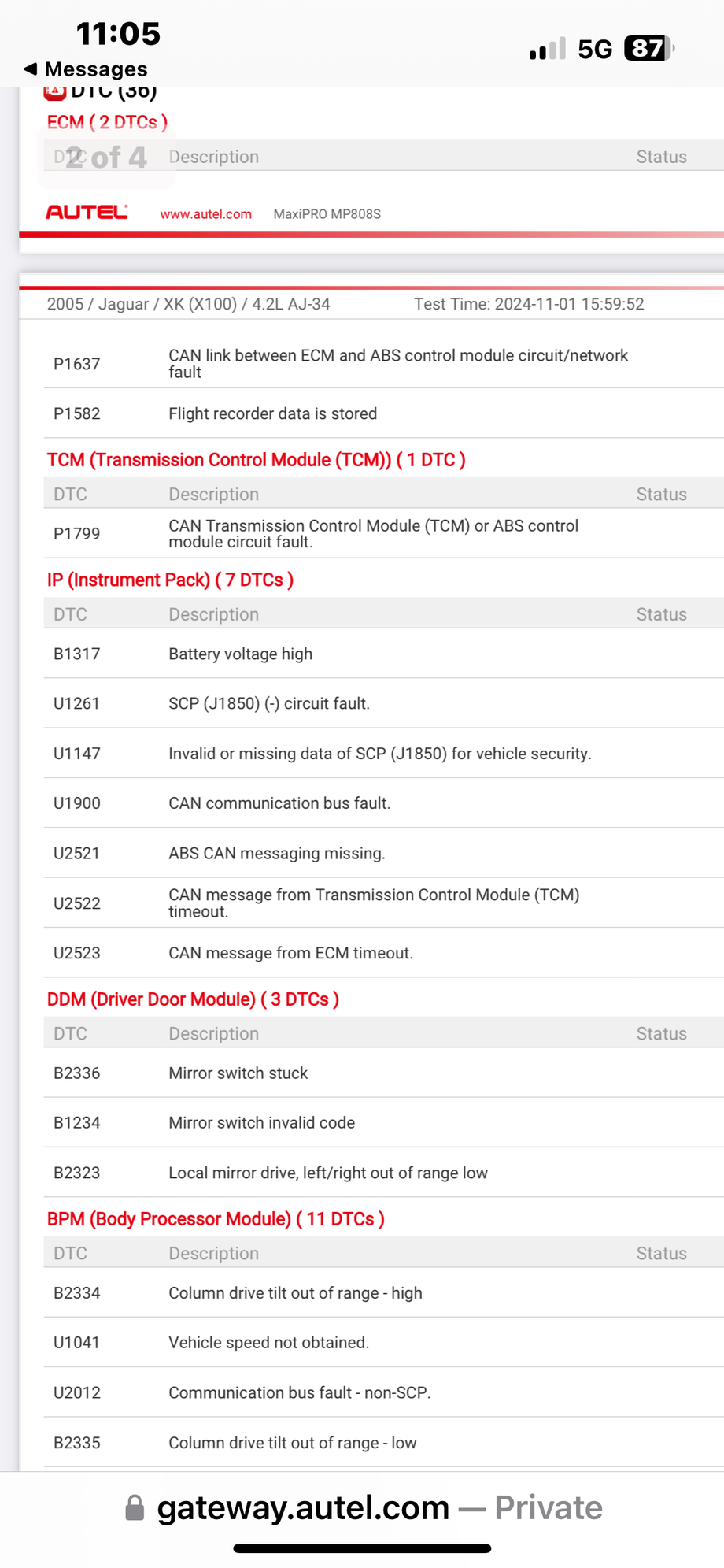

Would the place to buy a crank sensor for 2005 Xk8 be a ford dealership? I had a leak in my cross pipe so I replaced that in my water pump now I’ve got a crank no start did a hard reset. Couple times charge the battery I haven’t bought a new battery yet. I’ve got it put up for the winter one guy said it could be my crank sensor. It does sound like it cranked differently, but I shut it off change the water pump and the cross pipe and then ended up with a crank no start
David,
best if you start a new thread for this as it may well turn out to be something completely different.
What does the car think is wrong? Have the DTC codes read and post them back. Don't buy any parts on spec as that can get expensive very quickly...

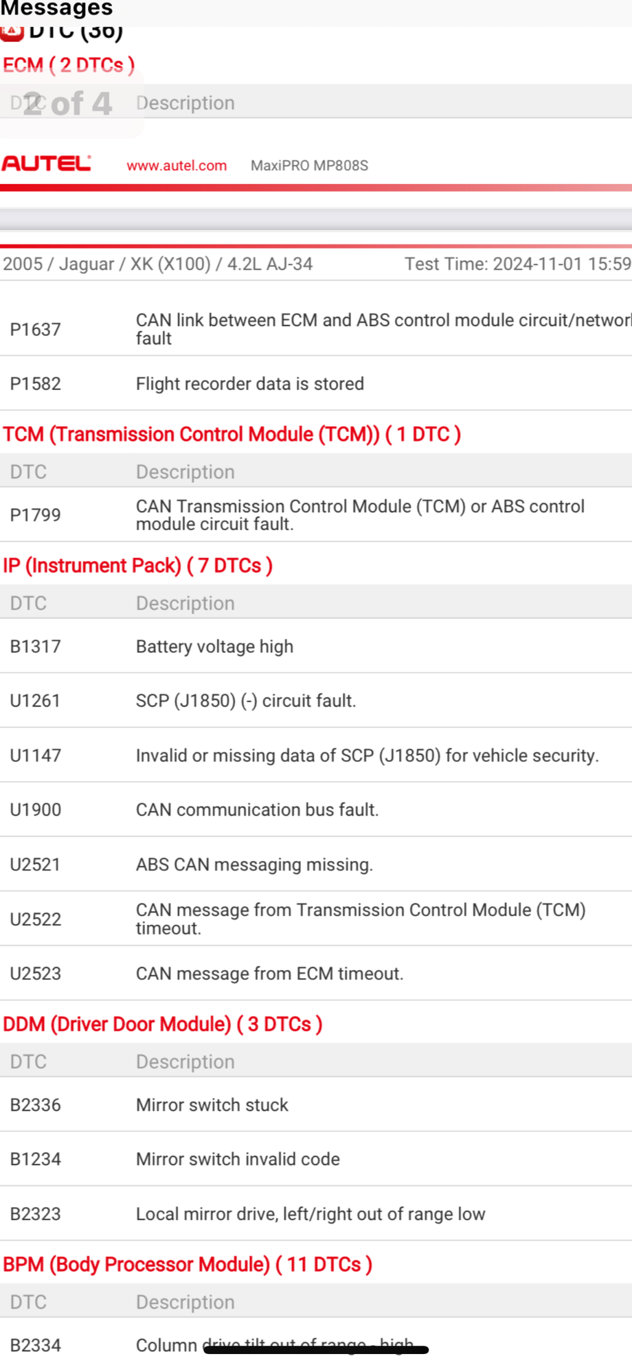

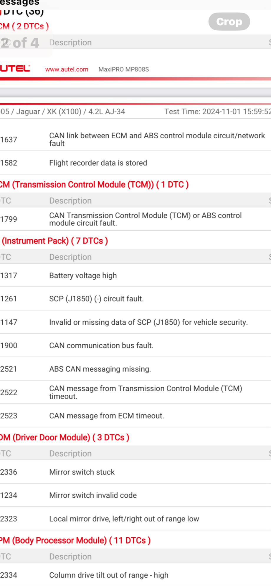

these are the error codes that came up for my 2005 XK84.2
You really must start a new thread - this has nothing to do with the OP's search for a crank sensor connector.
