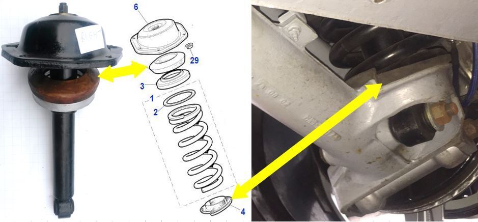

The top of the rear spring has a Rubber 'Isolator' which is cleverly contained within a tapered cup pressing..
The bottom of the rear spring sits in a captive rubber 'pigtail' seat that perfectly fits into a profile in the cast Wishbone.
It means the rear spring is actually completely mounted and contained by Rubber alone and should never creak on compression.
Any degradation or damage of either upper or lower rubber element will lead to metal-on-metal contact and noise.
That said, the creak noise could easily be coming from a Damper.

Old Jul 1, 2022 | 01:06 PM
Likes: 17,009
Originally Posted by PKWise
The top of the rear spring has a Rubber 'Isolator' .......
A splendid graphic.
