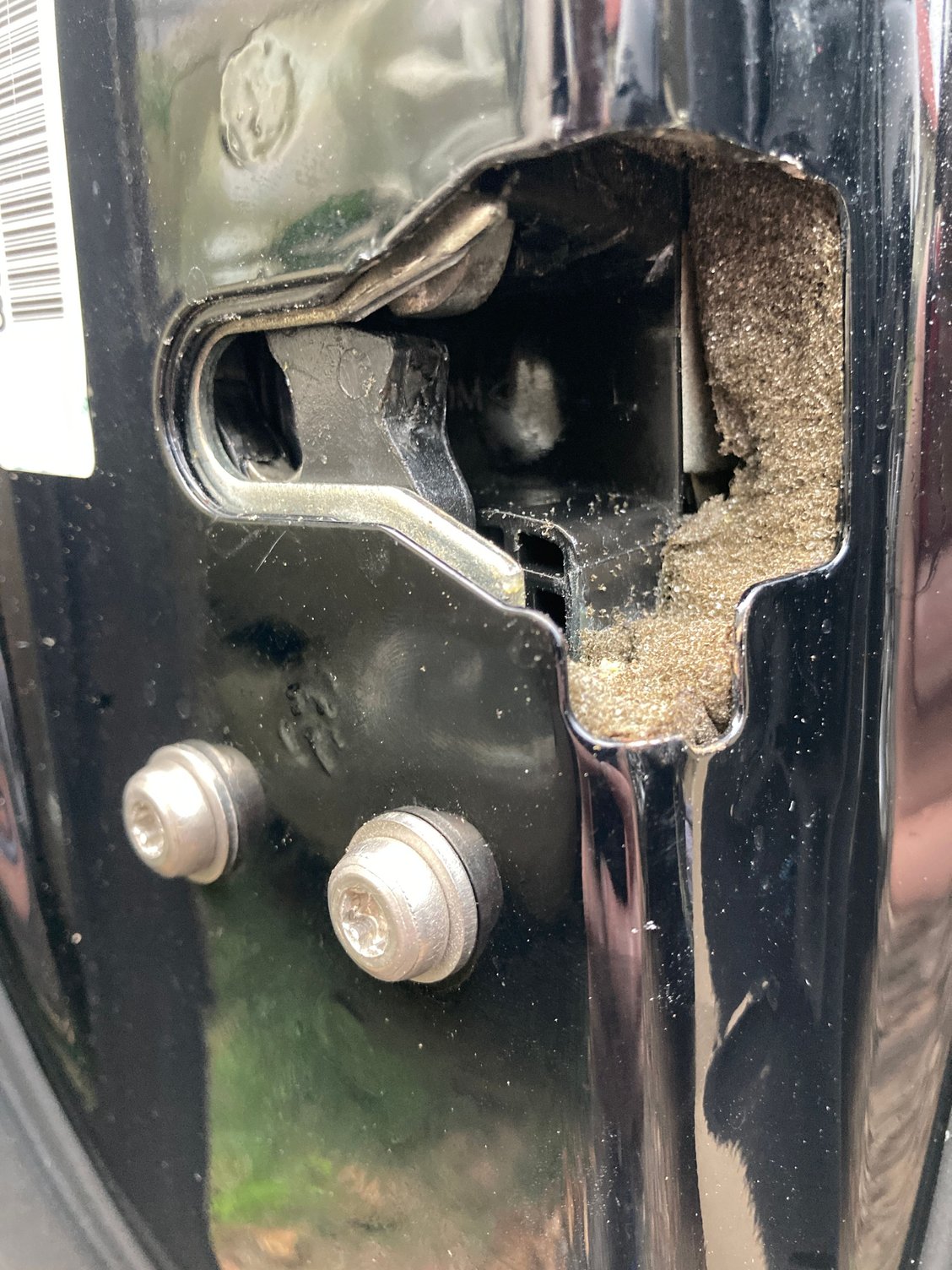

My partner and I did the hard reset, and it worked—took about 10 hours. Now the car cranks fine, but we’ve still for what I think are both electrical and mechanical issues with the driver’s side door. I also replaced the half-dozen fuses that I’d identified as possible problems. None of those new fuses seems to have made a difference.
I did the window reset, and the passenger window is fine; opens and closes as it should, and goes up/down that 1/4” or so when I open/close the door. Driver’s side door still won’t close, and won’t remember the window reset. When I pull on the exterior door handle, the window goes down about 1” (as you’d expect before a window reset). Once I’m inside and have the car running, I can raise the window fine with the switch. It still doesn’t lift/lower. I may try resetting it one more time, because why not.
I’ve attached a photo of the door latch that’s stuck in the closed position. I’ve tried the screwdriver suggestion and a couple others, but so far haven’t been able to get the latch to move as it should. Could be that my hands aren’t strong enough or dexterous enough to make this work. A conversation with my stepdad, who worked on the door/window line in an automotive factory for 5 years, leaves me thinking the door lock actuator may be the problem. Something’s slipped off of a lever and therefore the latch doesn’t work.

I had a problem similar to this. It was the microswitch in the latch. I just replaced the latch and it been working fine for years.

To release the clasp in that door, with door open (obviously, lol) pull interior door handle as IF you were inside and going to open it to get out - know what I mean? I know folks have said what I'll try and describe next,,,
At the same time (interior handle pulled ALL THE WAY to open) take a screwdriver and put it in the space that you see (your photo) in the door latching mechanism... Hold/pull the interior door handle to OPEN. You have to try and imagine what HAPPENS when you are pulling the door closed. That latch, when it strikes the U shaped bracket on the INSIDE of the door jam rolls over and hooks over it, closing the door. When it's in the open position, the U in the door clasp is facing OUT (open like packmans mouth) ready to clasp itself around the U on the door frame. Shoot, this is tough to explain, lol...
Let me try again --- what you need to do is pull the door handle inside of the car OPEN and at the exact same time, while the handle is pulled, put a thick/large screwdriver blade into that slot and push/pull it towards the interior of the car... It will "roll" over and be ready/positioned for regular closing.
I can't image SAFETY cops would allow a door to be designed to stay closed/locked like that for any reason unless the pull rod for the door lock at the interior door handle has broken or popped off altogether. It's an easy easy *** job to remove the door card. If the rod/cable that controls the lock is broken, well in that sense you are LUCKY it was in the open position when it broke. Jus say'n
