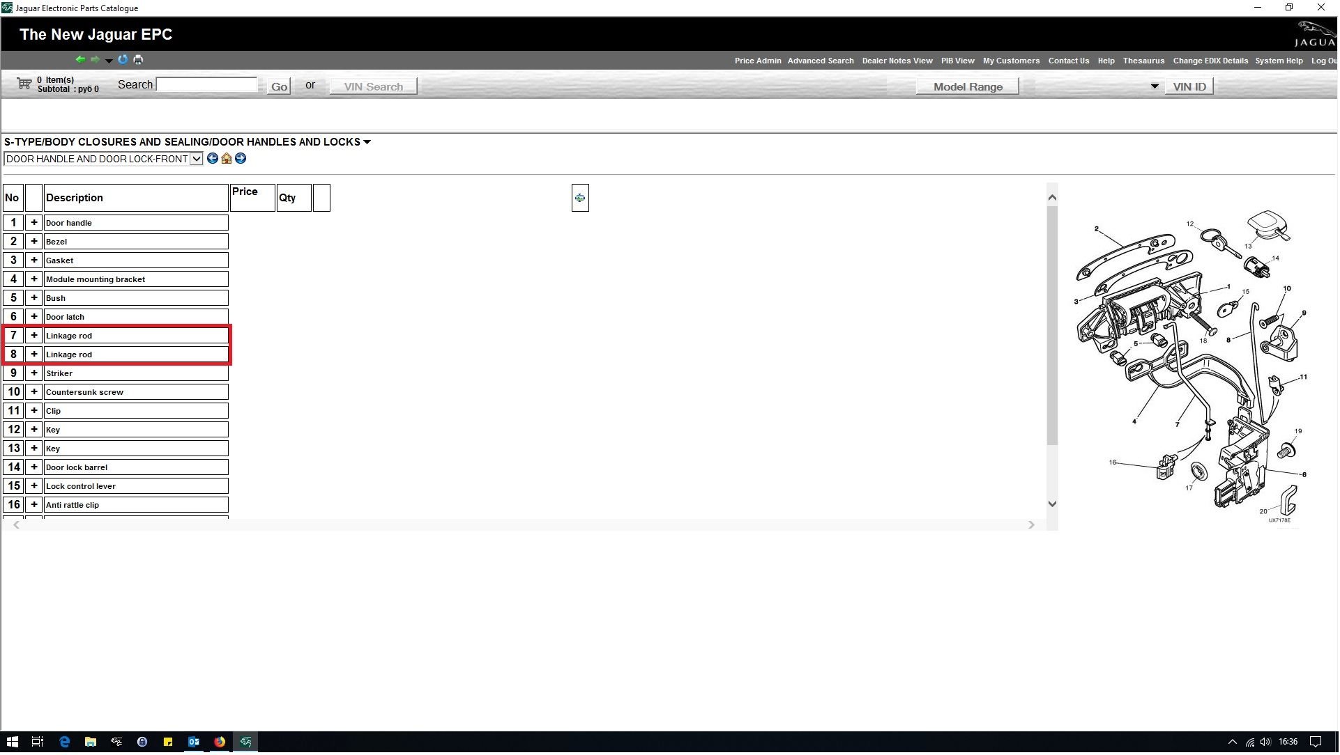

All recent Jaguars have a similar latch design with mechanical linkages which still operate the lock and handle in the event of electrical failure. This is the S-Type (see items 7 & 8):
The "lockout" to this is the security system but you cannot activate this from inside the vehicle.
If your vehicle doesn't operate like this, you have a linkage or latch issue.
