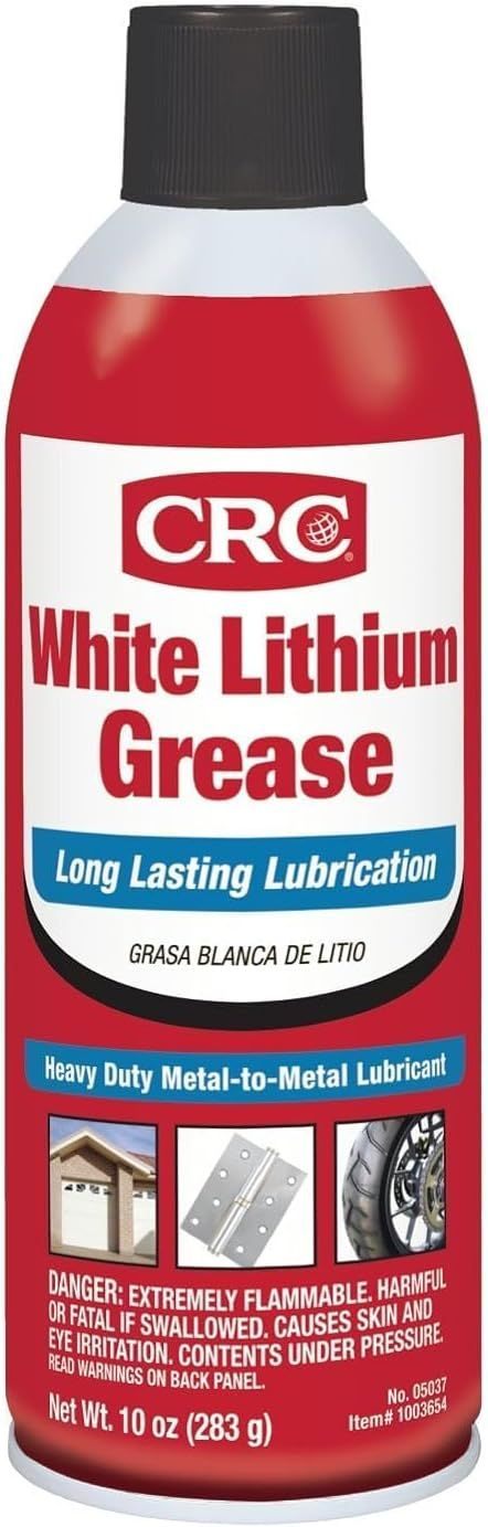

I have good luck with the white lithium grease spray cans like the CRC:
I work the door in and out while spraying grease down and up the hinge pins. There's usually enough clearance between the hinge barrels and pins to allow good penetration of the grease. I hold a paper towel behind the hinge while spraying the grease to reduce overspray and cleanup time.
