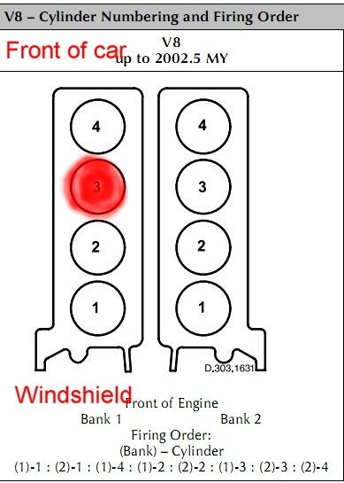

yes, it's p0307. So, its on the drivers side, third starting from front to back(located closest to windshield)?

this one?

Originally Posted by hm1
this one?
No! The FRONT of the Engine is AWAY from the Windshield.

ok, so wich one?
ok, so wich one?
Per stevetech's response above:
"cylinder #7 is the third piston from the front on the driver's side on a LHD. Or, from the diagram above, cyl # (2)-3"
