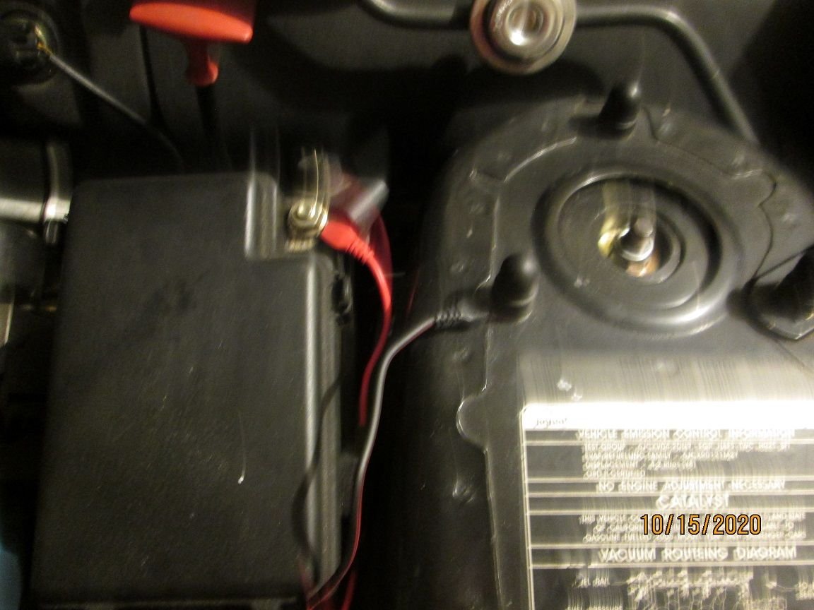

If you can get to the lighter you should be able to open the hood.
Open hood. Go to driver's side. Look down at shock tower. Move gaze forward a few inches. See black plastic fuse box. There is a covered (rubber cap) battery terminal right there.
Connect 12v to energize trunk open button. I use one of the shock bolts for ground connection. This 12v terminal is not for jump start - ever.
John

Are you saying I can attach the jump pack there to energize the trunk lock? If so...I'm indebted to you. If possible, can you post a picture of the place to attach the positive clamp from my jump pack? I'm new to this car and would appreciate it immensely. Also do I ground the negative side?

Connect where my CTEK cables are on the left side of the car.
Sorry about the blur, too much wine with dinner.

The ground should be on the shock tower bolt, you may have to remove a rubber cover.
The positive side is a few inches to the left of the tower between the tower and ABS control box, if you have not found it yet. It will energize 12 Volts on the battery, if it's connected and your push button by the steering left side should work.

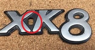

However, you can always use the key to get into the boot/trunk at the keyhole. The problem comes when the only key you have is in the boot/trunk.

If you have the key, there's a key hole in the right side rear. It's hard to see, hidden in the emblem/badge.

So, an often unappreciated fact is that there is a key hole in the rear of the car, near/within the xk8 badge that several of us have alluded to. It is mechanical, not dependent on the battery. For example, a picture below.
Happy motoring.
Picture shamelessly lifted from another thread showing the keyhole.

Now you've got in there would be a good time to check out/free up the trunk lock mechanism. It's possible to open it with a key in the hole in the XK8 emblem as that doesn't rely on battery power. Seldom used so the mech. can stick.
Not sure which you will have as they changed over time, but it's either between the X & the K:
...or here:

The AAA guy was reluctant to put pos jumper on this black rubber covered post. I agree but it is the correct one. I had to sign a waiver
successfully jumped the trunk open
randy

Good. He is right, in a way. Definitely should not jump the starter from there.

Yes I should clarify did not attempt the jump Start the car just “backfeed” the lid mechanism. Popped open with lid button once voltage is applied
