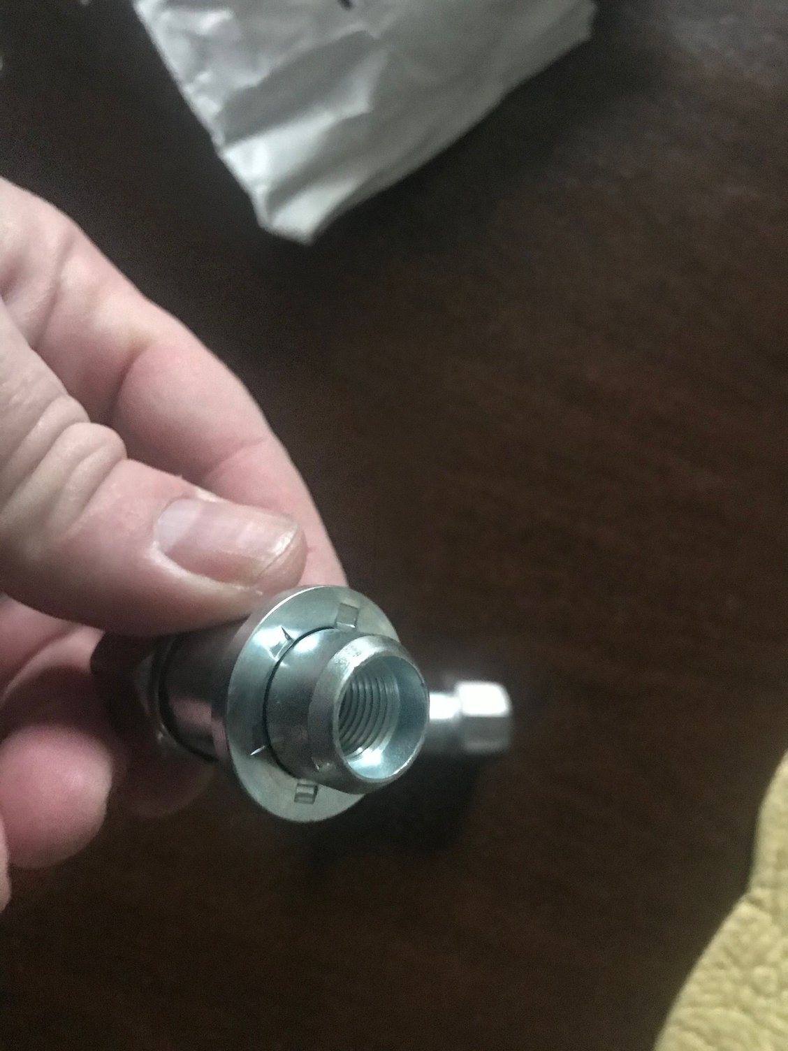

Old Feb 27, 2020 | 10:37 AM
XxSlowpokexX's Avatar
Posts: 1,245
Likes: 174
From: NYC
Sorry for the delay I keep forgetting . Total for all 20 was under 100$ USD. As you can see they are much different than the typical xj wheel.
Also included part number and where I bought from. He is an eBay vendor if you do a search

Slowpoke,
I'm old and stupid and I have tried but I can't find this Guy....I've looked at eBay but I need some help finding him....Please send some kind of email address so we can locate this Guy's eBay Shop!
These Lug Nuts appear to have a Chrome wrapped Top and also look to be about 2" long....Is that about right?

Yes. I would have preferred no caps as I had problems with my XJR lugs in the past. But these are the only ones I found this length that work. Let me know if this works
https://www.ebay.com/itm/JAGUAR-X300...53.m1438.l2649

My Lug Nuts came with the XKR originally....They are the Capped type and are 2" long...About 2 years ago I bought a set of Lockers, as I felt I had about given up all my Luck over the years. The Capped Nuts have held up well over the years as I always take the Removal Tools to the Tire Guy and explain how to use them...When they understand how to use the Air Valve and the Lock Nut cover puller and the Key. They feel like they have learned something and they really are careful with it when you hand them a $10. Bill....I explain that the Torque to use on the Wheel Nut is 75 Lbs. This protects the Chrome Cover and after all the years, the Nuts still look pretty good! Probably average about 21/2 years per set so they have been on and off several times. What do you think?
Billy Clyde
