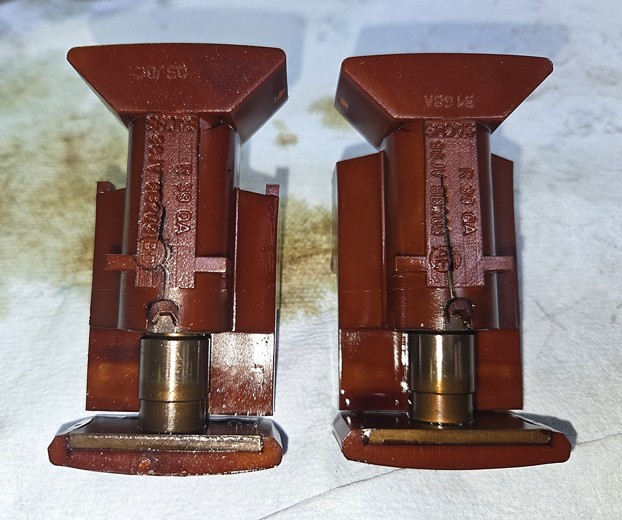

I know your secondary timing chain tensioners have already been changed, but as a warning to everyone who hasn't checked theirs, here's what I pulled out of this '99 XK8 with 93K miles: first generation tensioners cracked almost their entire length. Catastrophic engine failure just waiting to happen at any moment.
This is why they call them ticking time bombs:

I know your secondary timing chain tensioners have already been changed, but as a warning to everyone who hasn't checked theirs, here's what I pulled out of this '99 XK8 with 93K miles. First generation tensioners cracked almost their entire length. Catastrophic engine failure just waiting to happen at any moment. This is why they call them ticking time bombs.
