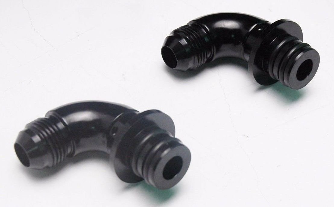

Off the top of my head, the only concern with not draining the fluid would be fluid loss from the cooler line ports if the transmission is positioned vertically while replacing the seal or installing the torque converter. You could buy a pair of the cooler line flush fittings from a vendor like Summit Racing and put a little silicone sealant in the end of each one to create plugs to seal the transmission during the work. You would just clamp these fittings to the transmission with the existing cooler line clamping plate:
You could also probably seal the ports with standard rubber stoppers if you can find a suitable size.
