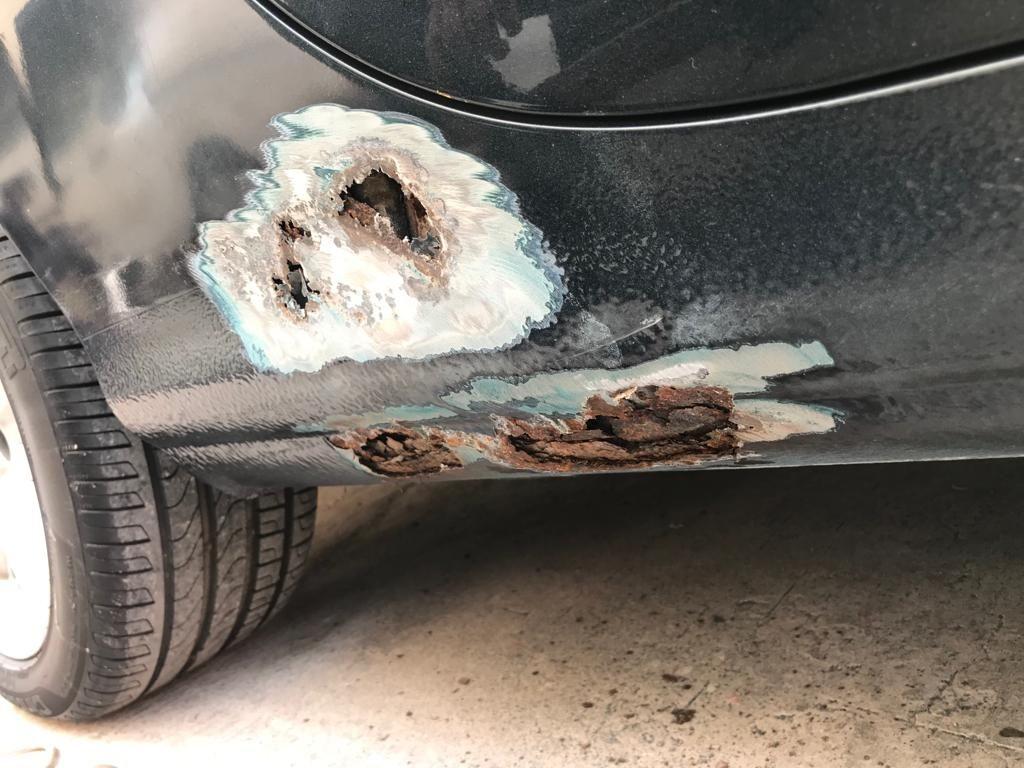

Since I got the car I had these little paint bubbles and knew there was rust behind. With all the discussion recently on the forum on painting, I thought I would investigate further by tapping away with the back of a screwdriver.....
Found this..... initially.....
Had to investigate further with a grinder.....
Look away now , if you don't like horror stories.
Bugger!
I'm not actually too worried as I've dealt DIY with something similar on a 1972 Triumph GT6 in the UK, but here in Bahrain finding the dreaded tin worm came as a bit of a surprise.
Off to my local mechanic now, as I just don't have the kit to fix this at home.

Bahrain is a Arabian desert climate, but there's a local phenomenon where people park cars next to a swimming pool or a grass verge. From the humid air, or from watering the verge border, this results in the rust & corrosion on only one side of the car. The other side of my Jag is just fine!

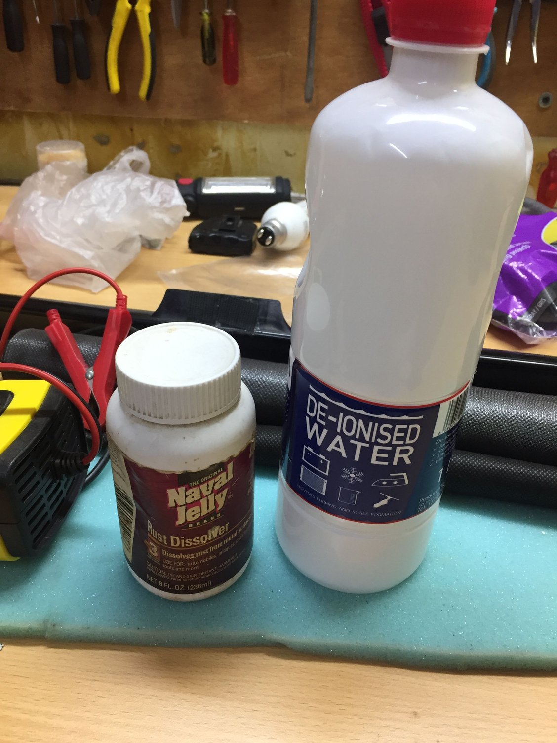

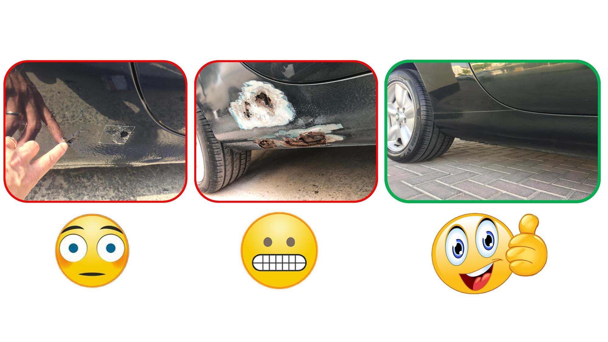

Used a wire brush and the following to clean behind the panels as best as I could reach through the panel holes. Everything looked okay esp. important as the rusty panel is above the jacking point of the car. The Naval Jelly Rust Dissolver stinks though and left it on overnight and used battery water to wash away thoroughly before handing over to my local mechanic.
Car came back from the body shop and all is well again in the world. See below. Total cost = BHD200 equiv USD 529 including a front bumper re-spray as well (hit tyre carcuss on freeway, and car park rash)

Well done at a true bargain price. How is the other side of the car?

I would have liked to see an "in-process" picture with a determined smiley face diligently welding new metal into the rusted rocker, so I know it wasn't just rolled up newspaper and Bondo under the nice paint.

curious as to what the repairer did in terms of future rust mitigation. FYI even when welding on clean panels, the preventative coatings are oxidized away. this includes any zinc dipping. ideally he applied weld through primer before any installation. the standard is to apply permanent coatings from the inside involving interior R&Is which is often why it is not performed and in a few cases access ports are cut from the inside. subsequent to the permanent coating, a renewable product is recommended. these range from gels to oils and waxes as determined by area and owner preference.

Well at least we all agree what needs to be done on a quality repair that lasts esp. where rust is involved. Ungn is right in that there are some unscrupulous people out there.
Short answer to Whitehat, is that I don’t know. Mechanic said it was zinc treated and wax oiled behind before welding new body panel. No evidence that he cut an access panel to treat the back of the body’s new weld. Still at the low price I paid, so be it. Or as they say in this part of the world ... inshallah.
