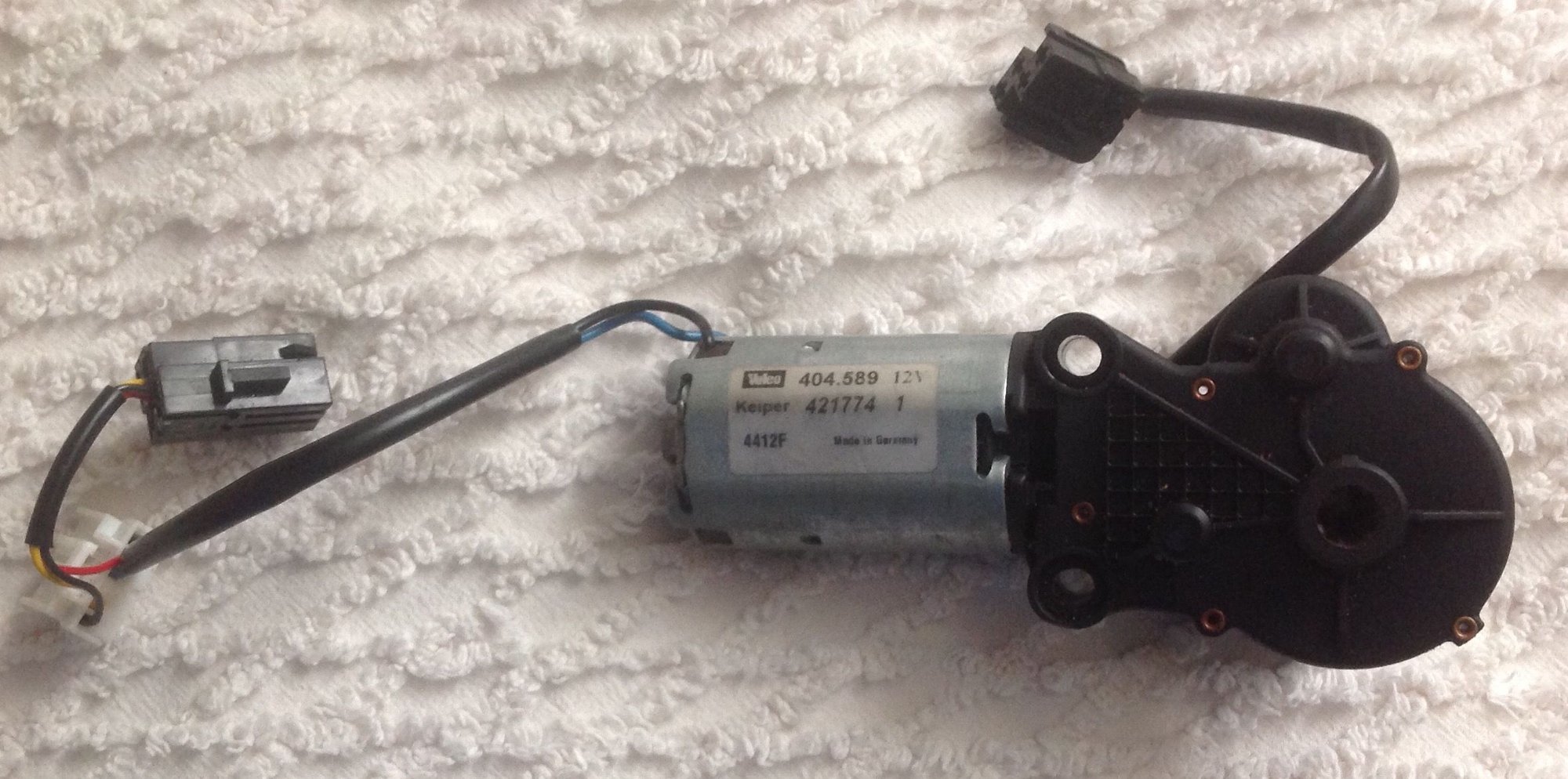

Hello all. I have a 2003 XK8 Convertible. The drivers seat back recline does not stay locked or work at all. I lifted the seat cover to see this left hand motor attached in the pic wired but just hanging loose and not connected to the rod with the teeth. The right hand motor turns on when the seat lever is lifted. This one is quiet. I guess the previous owner was obviously messing with it. I have not bench tested it yet but for the life of me can't find the part number labeled on the motor. Can anyone help? Thanks in advance!

I dont think the part I pictured is the right part. It doesn't look the same as ones pictured for 97-03 and since it was just hanging by the wires and not installed may explain why it's not working. I did find this part number 0390201617 which claims to be 97-03 and is available. I'll look at the passenger motor to get a bead on it.

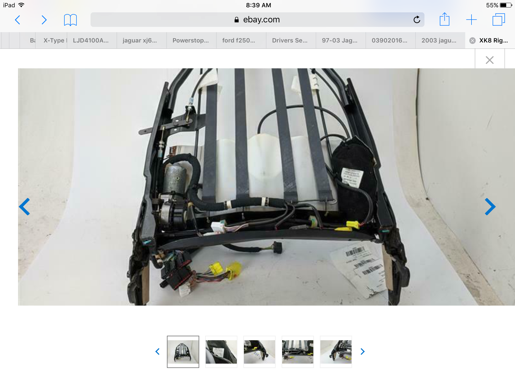

I think I have solved the problem. The motor I took out, which was just hanging there, is for a Mercedes. I found a pic of the frame and a pic of the correct motor on EBay. You never know what you will find in a used car!
