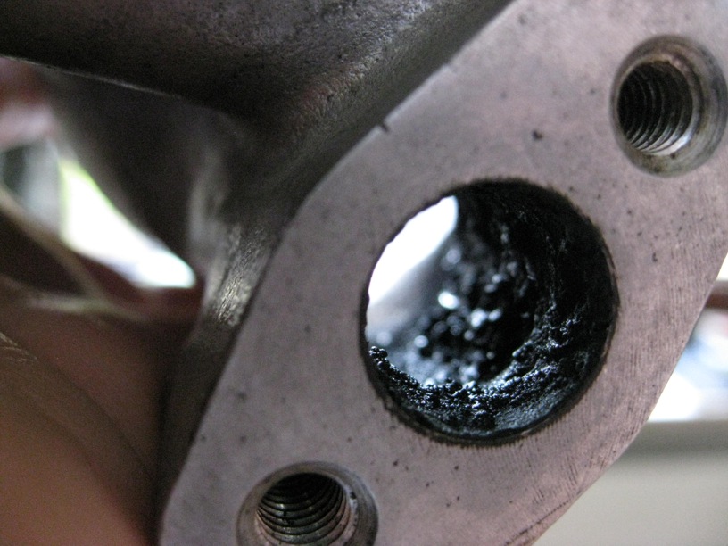

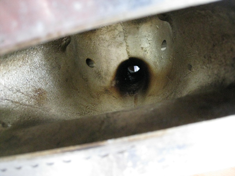

I'm during the process of adapting Kenne Bell 2.2 and designing new intake elbow, so there is great oportunity to delete EGR, which, together with breather is responsible for all that exhaust junk in SC lobes, intake, IC radiators, etc.

Originally Posted by ccfulton
I'd say the breather is most of it.
Have a look at attached fotos, please. 90% of junk comes from EGR flange.
I see the picture and can say that mine looked very similar when I took it apart.
I only know my own experience with having the EGR connected and the breather filtered so that there is not the coating of oil to be cooked on by the hot exhaust gas.
