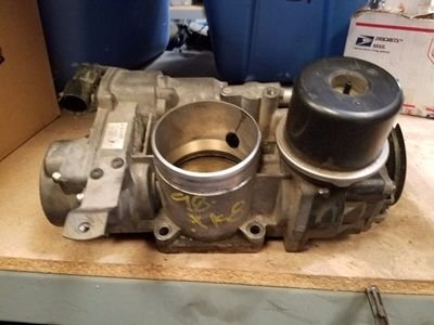

By 'throttle box' do you mean the whole throttle body assembly?:
I'd expect more relevant code(s) - does the engine run smoothly if you rev it gently in neutral?
Old Dec 1, 2025 | 04:03 PM
Kyrre's Avatar
Joined: Nov 2025
Posts: 10
From: Bodo, Norway
Yes, I replaced the whole throttle assembly.
