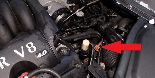

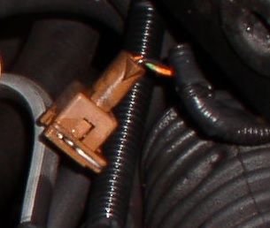

Old Nov 17, 2018 | 01:35 PM
Likes: 17,018
This brown plug?
If so, you're very unluckly. It's about the most robust harness plug on the entire vehicle.
Old Nov 17, 2018 | 01:57 PM
hirev's Avatar
Joined: Sep 2016
Posts: 203
Likes: 32
it is that exact plug and i can see it is an unlucky lose of the metal keeper that shows as silver in the photo, it is that exact plug...

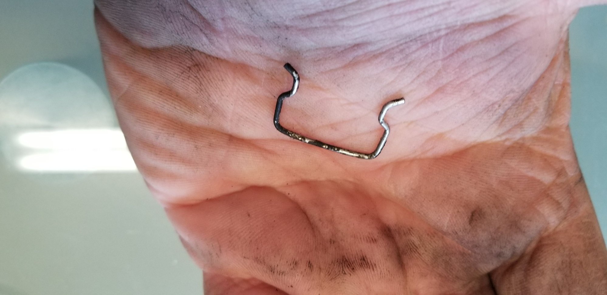

BobRoy's Avatar
Joined: Jul 2015
Posts: 1,536
Likes: 790
From: Sacramento, CA
I know someone. I have it my hand right now. PM me your address and I will send it to you..

Old Nov 22, 2018 | 01:47 PM
hirev's Avatar
Joined: Sep 2016
Posts: 203
Likes: 32
Default thanks again
Well Bob came through, the wire keeper arrived, and it fit perfectly. The plug is now functional and another jag is still on the road thanks to Bob's consideration and his parts car.
