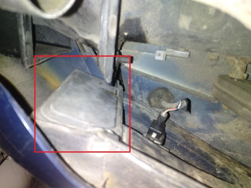

All,
I have a 2000 XK8 convertible and new to All things Jaguar.
My quest is to get the factory fitted Motorola phone operational. Fitting a new transceiver got the handset to light up, but still struggling with getting my O2 and vodaphone SIMS to register. My current issue is finding the blooming telephone antenna on the car. Wiring diagrams say it’s in the right side of the boot ( trunk) but can’t see it. Anyone got any location shots or can tell me where to look. Just need to take a look to rule it out as a issue.
cheers
B
JTIS says the same for mine, but it's actually tucked under the LHS of the rear bumper. Worth a check even though your car is newer. It makes some sense since it's not as shielded by the bodywork metal:
Is the phone control module really in the boot? Seems an odd place so far from the audio head unit.

Old May 13, 2020 | 05:03 AM
Brian8700's Avatar
Joined: Feb 2020
Posts: 11
Likes: 10
From: Garstang
Update......
getting somewhere now..
replaced the antenna at in the rear bumper( fender) NOS from eBay (£20). The phone now picks up a signal and the Vodafone sim now registers. Unfortunately still unable to make or receive calls as Vodafone tells me my SIM is defective.... new one inbound.
progress .... if not finished
cheers
Brian
Old May 14, 2020 | 09:16 AM
Brian8700's Avatar
Joined: Feb 2020
Posts: 11
Likes: 10
From: Garstang
SUCCESS!
Having received a new Vodafone SIM and plugging it into the handset, (then speaking to Vodafone to register it).... Its finally working, and both made and received calls on the move.
so to recap,
Started off with a completely dead phone.
Changed out the transceiver (behind the rear seats), phone lit up but no connection.
Changed out the antenna (under rear bumper left hand side).........
All good
thank you all for the advice and guidance
cheers
Brian
