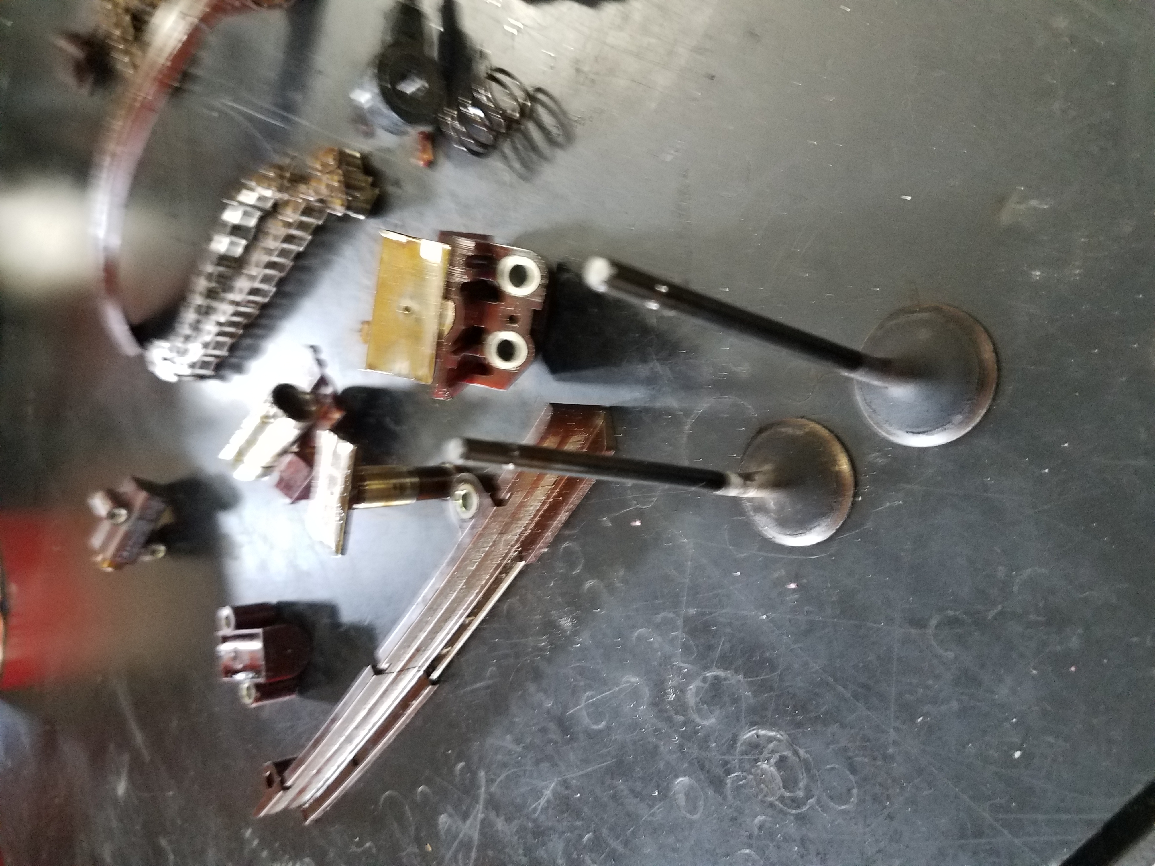

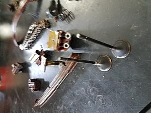

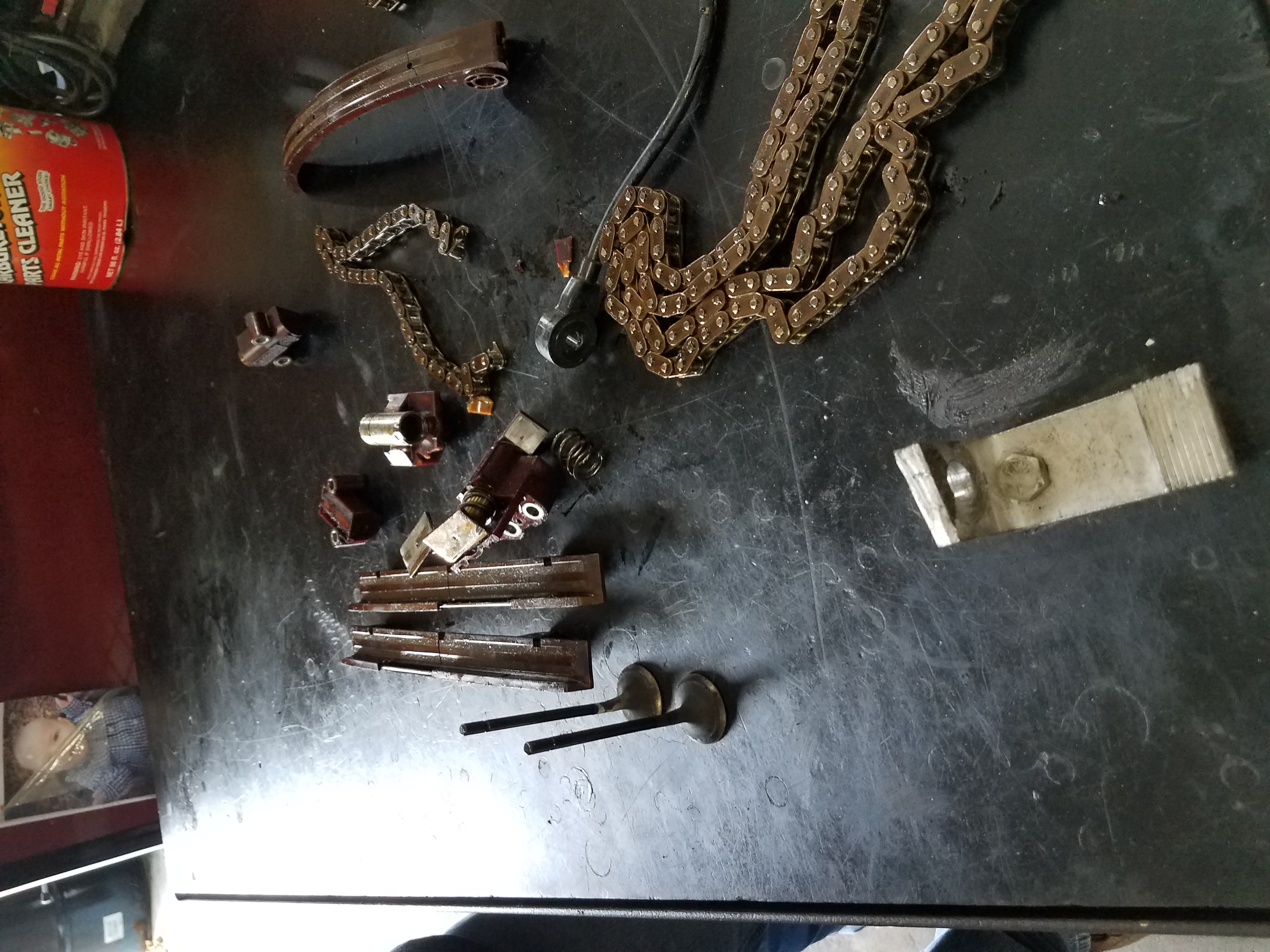

Default Correction - NOT Gen 3 Tensioners
Well finally got the call that the Mistress is ready to be picked up - lo and behold she DID NOT have upgraded tensioners - still had Gen 1 - pics attached.
I also had them replace the motor mounts and knock sensor - runs sweet but did pull up a 171/174 as I pulled into the driveway. will tackle that in the next week or so but she definitely needs a bath!!!
I addressed with the owner as I asked last June when valve cover gaskets, etc were replaced if gen 1 replace as I would have rather replaced at that time before valves bent. His tech assured gen 3.
Attached Thumbnails failed tensioner -  RESOLVED-20180529_154714.jpg   failed tensioner -  RESOLVED-20180529_154721.jpg   failed tensioner -  RESOLVED-20180529_154727.jpg   failed tensioner -  RESOLVED-20180529_154813.jpg   failed tensioner -  RESOLVED-20180529_164237.jpg

I'm surprised she went as long and as far as she did with the Gen1 tensioners.
What was the condition of the cylinder bores?
