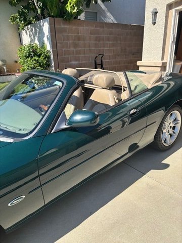

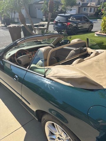

Just finished 2 kind of minor additions that were pleasantly simple to do, the new wind deflector and a switch for the quarter windows. Together they eliminate a lot of the top down wind issues. Well, technically those of us who are folically challenged won't notice the difference but mama is much happier with her hair not blowing all over. And you got to keep mama happy.
