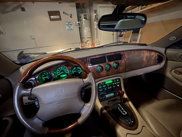

Turns out you can just switch the incandescent bulbs with an LED bulb if you can't get the base that comes with the LEDs to fit into the hole in the panel. It seems that it wasn't so much the diameter of the base as it was the space in the locking mechanism was too narrow on a few LEDs. Now I have nice bright lights in all the center console and the gauges. Now if there was a way to take the face plate off the radio easily I could solder a few LEDs in place of the dull incandescent bulbs and everything would match, lol.
I also took the map light unit out to replace those lights with LEDs. There's the usual plug on the starboard side for the lights but there's another plug on the port side that goes to some items that are under that screen that is to the rear of the cover. Anyone know what those are for? I was thinking one might be for the phone microphone since this car is equipped with the Alpine sound system which appears to allow phone communication, but I have no idea how to connect the phone.
Old Sep 28, 2025 | 12:33 PM
  #29
OCJoeR's Avatar
Joined: Oct 2024
Posts: 455
Likes: 82
From: Orange County Califorina
Forgot to include photos of the new lights: You can see what I mean about the radio light!!!
