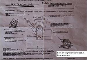

Did you succeed? I started looking at this six years ago with help from White XKR and StevePaa (who very kindly gave me a connector to join the RT connectors in the boot together). Unforturnately, my Radio Telephone (RT..) connectors were corroded and not usable, with blown fuses etc. After a six year delay, I've got them operational and the phone bit of the puzzle works for me - plug and play with a Nokia CK300..
To connect to the 10 pin connector under the armrest I used "Autoleads Cellular Interface Lead PC6-101", which makes the telephony bit more simple. I'm using
JAG-CDR Auxiliary Jack, Changer retention Kit for Select Jaguar XJ and XK :: iPod Adapters & Interfaces to create an Aux connection or relay of stereo output to the factory system, either wired or via bluetooth adaptor.

Default Lead in question
This is the lead... If you cannot find one, I have a slightly butchered one... Works for MY2000
