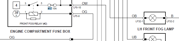

F17 (15A) in engine compartment fusebox is the one to check:

Well I’m a moron, #17 up front did the trick. When I actually take the time to read the manual, there’s a fuse for “fog lights” and “front fog lights”. Thanks!
