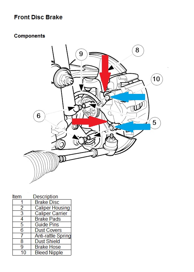

You are trying to remove the Guide Pins (arrowed in blue) and not the Carrier to Vertical Link bolts (arrowed in red)?
Caliper Guide pins are a 2 x Weetabix job but the Carrier bolts take the whole box!
Attachment 92526
Oh Oh looks like a foo par on my behalf. Yes Graham I was trying to get the carrier bolts out.
I take it thats not the way to go but to remove the Caliper Guide pins? Not done this before on this car or this type of brake system. Is it just a case of taking the Guide pins out and the spring of the front and it all comes free? Just had my mind set on taking off the caliper and nothing else.....

Arty,
YES - Guide Pins out and the whole Caliper comes away from the Carrier. There's some useful diagrams in the JTIS section:
JTIS - XK8 Front Brake Pads.pdf
You only have to remove the Carrier if you need to change the Discs.

Originally Posted by GGG
Arty,
Attachment 92584
Thanks so much for the advice and info Graham. I'll give it a go over the weekend weather permitting, like everything else its easy when you know how ( and your spanners are decent, lol's ).
