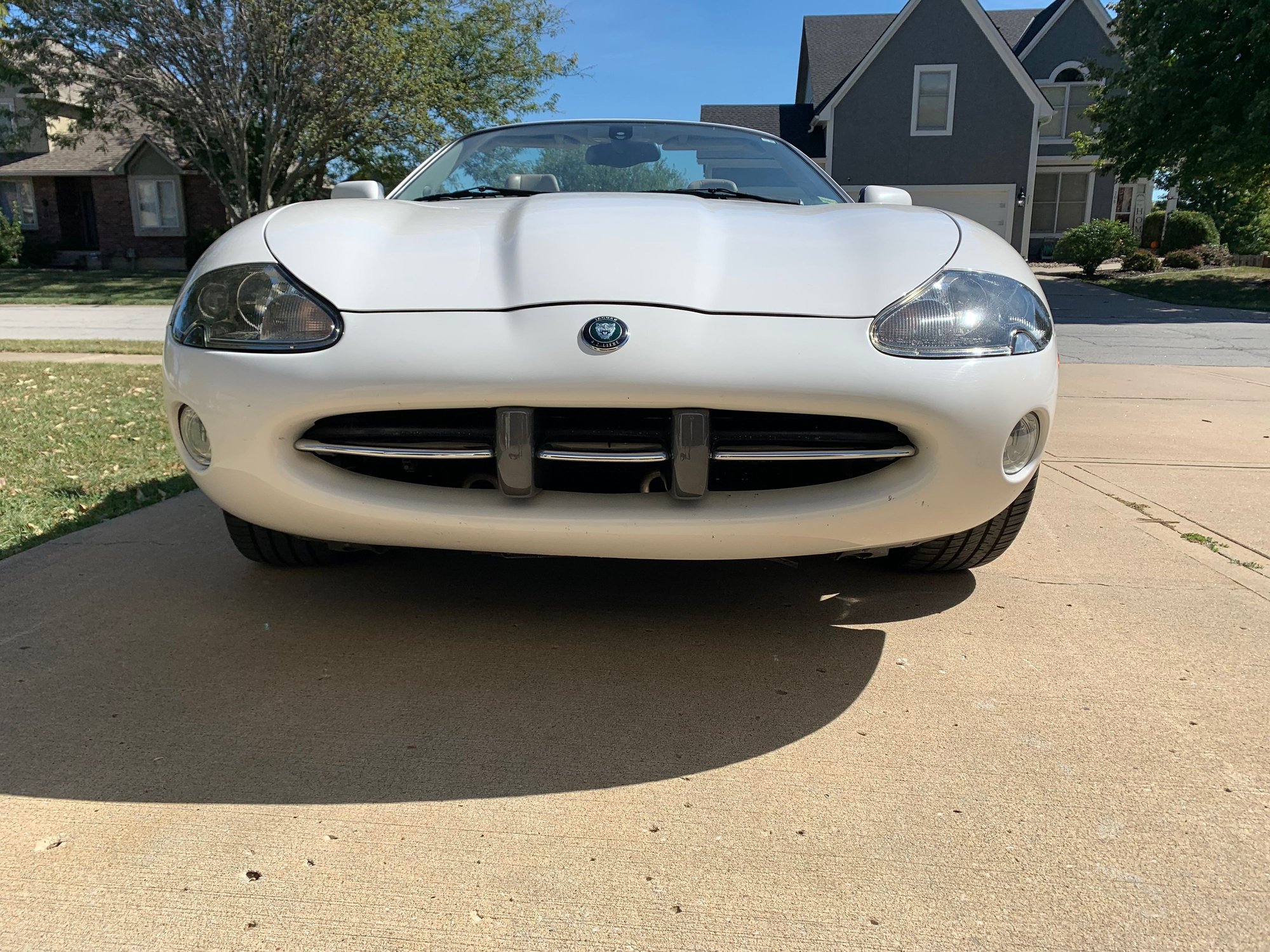

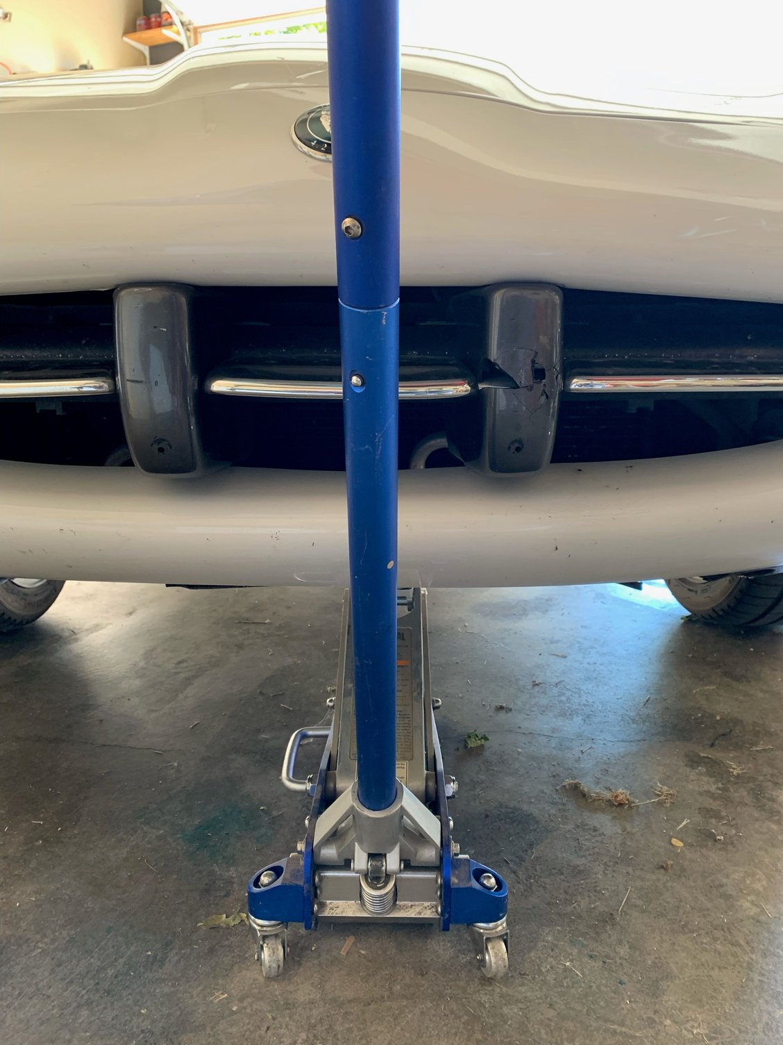

Hello, I cracked my driver side overrider today and ordered a replacement. It looks pretty straightforward to replace, is there anything I should know that any of you know or is there a remove and replace guide? Thanks, here is my car, bought in 2019, has 75K now. Love the Apollos. Background has been MG’s and older Mercedes mostly,

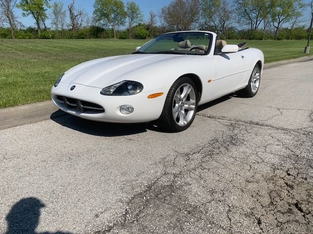

OK everybody, I just followed the instructions and replaced the overriders. Note cheap parts. Went pretty well. Took me 2.5 hrs. I am a total idiot because I put the spacer washers above the nose piece, not underneath, so I need to fix that but that should only take a few minutes. You can tell by the gap in the second picture. Thanks so much for the help, the parts sat for a year and when I opened them I had one that was in the right box but not the right part, so I had to exchange, Finally got around to doing it.
