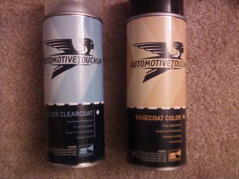

Thanks to all the replies so far. I've got the masking material and some 600 sandpaper laying around. The paint chips are primary for me so the scratches can be dealt with later. The scratches were there before, I just hate the look of the missing paint.

Hi, I bought basecoat MDZ and clear coat finish. I'm happy with the color match but it's coming out a matte finish, did I miss something? I thought the clear coat was the gloss finish? What can I do about that? I've attached pictures...

I'm still seeing scratches, why is that? Yes, clear coat should be a gloss, but I can't tell from the picture. If you put any paint or finish on too lightly it will be dry and not flow, maybe that's the problem. However, you can still sand and buff to a good finish, just takes longer.

I didn't buff the whole thing out I was only going to do where the paint was chipped off(see top pic) but I decided to just paint the scratches. Anyways I was reading at the paint sellers website that I should use rubbing compound after using 1500 sandpaper to get out the inconsistencies so I'll try that and get back. I'm also thinking I should use some filler for the scratches as well like bondo.
