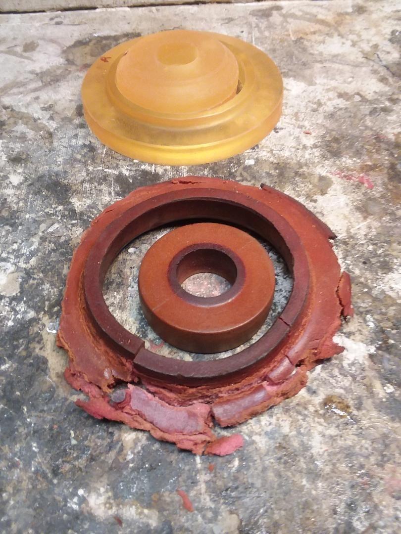

The reason why the front gets lower is because the Spring Isolator gets brittle and crumbles to dust. So When I sell my front suspension kit I include the urethane isolators as well, now I ship these all over the world!

That's a really helpful pic. Mine sits really low but the bumpers look fine from the top - not the mess I see in a lot of pics and vids. And your pic shows why - that inner piece that you can see from the top looks just fine there but the big one is toast. So looks like it's time for me to open it up. Mine are red like that too.
