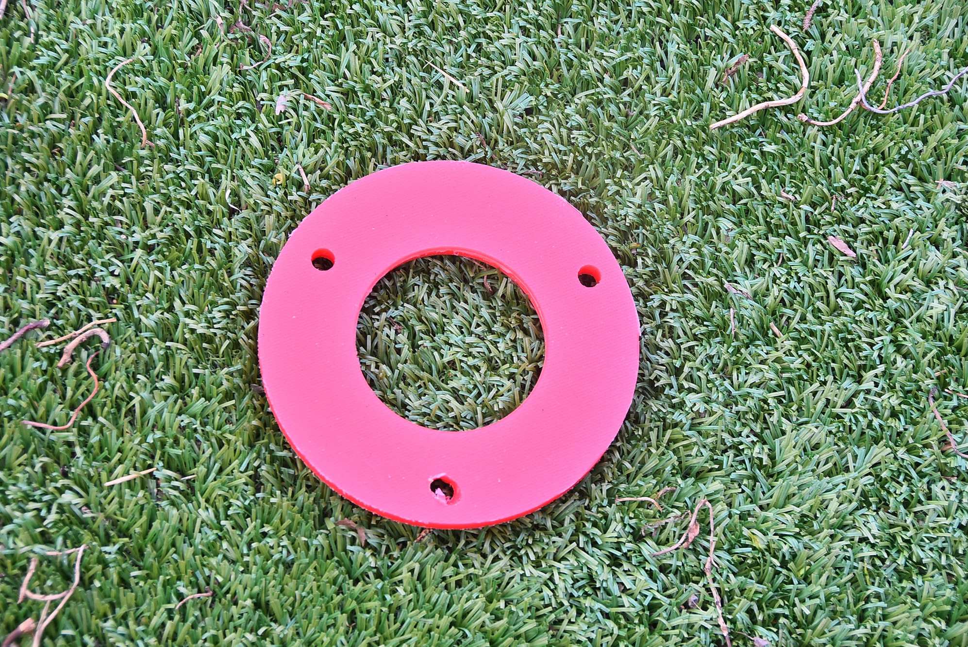

You can get 12mm of board on top of the mounts because the studs have 13mm of excess thread. Doing it this way you dont actually need to get the spring out witch I think needs removal of the top wishbone and shock ..let me know if that is wrong.If my top mounts are shot (they look OK) I shall seal them up and fill with liquid polyurethane.1
Here is the spacer . Use a jigsaw if you dont have a lathe
160mm dia 90mm dia hole..dont you just love artificial grass.

I think you miss read what I said...If you just want a spacer above the top mount then you dont need to remove the spring from the car though you do need to hold it with spring compressors.
If my top mounts are stuffed I would dismantle them / have the shock mount washer in correct place before filling. Sealing and putting removable mandrills in place. May even vacuum bag it to stop any leakage. As I am not running a production line like you I can be a bit crude for a one off.
I have edited the original text to make it clearer.
