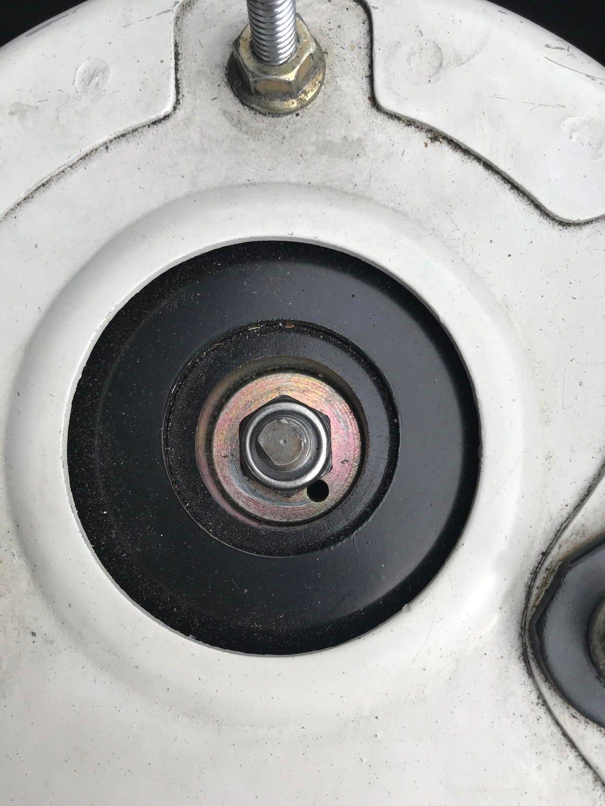

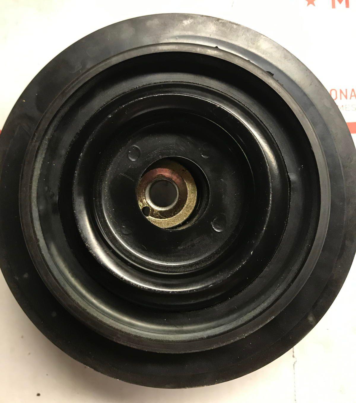

I put these Welsh shock mounts on in February. with new springs to bring ride height back to spec. It was 1.5 inches low. With new springs and mounts it was 1/2 inch high. After 4 months ride height has settled to 1/4 inch high, so I am going to remove the 1/4 inch spacers at bottom of spring.
I removed shock mount and hole is not centered.
I may put my 5 year old original Jaguar mounts back on. I will contact Welsh tomorrow.
And the one in the car has shifted.

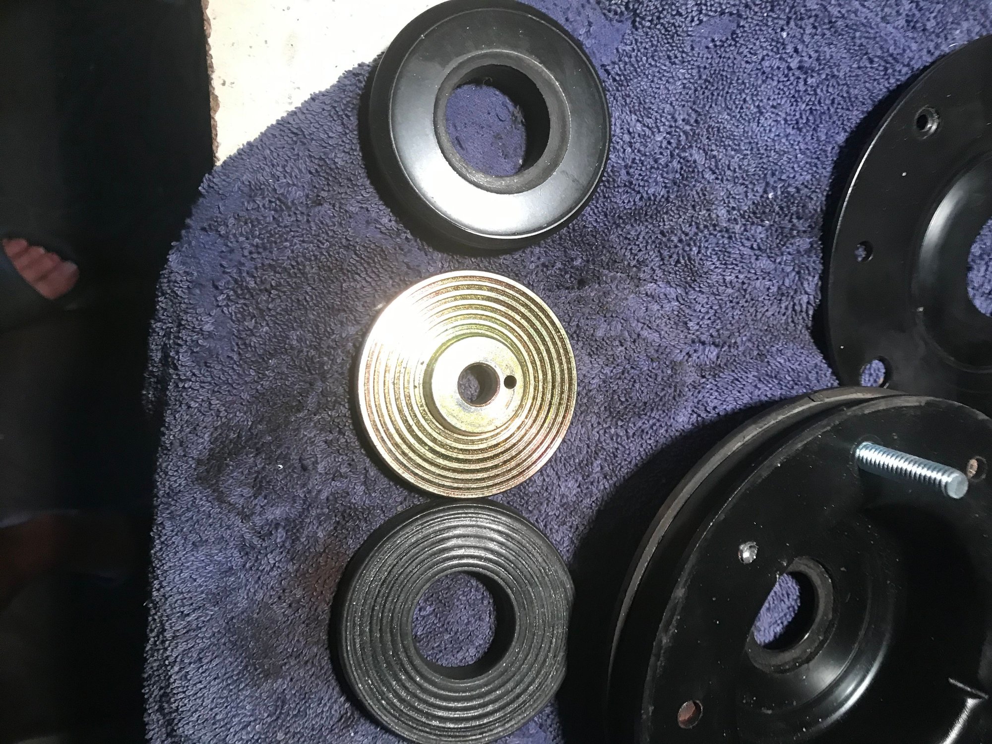

Having same problem/issue. I took one Welsh mount apart, the inner ring is actually more like a doughnut and is smaller in diameter than the area it is in. So this doughnut can shift, thus not being centered any longer. Welsh should make this doughnut the same size as the area and it would not be able to shift or move.
Poor design.

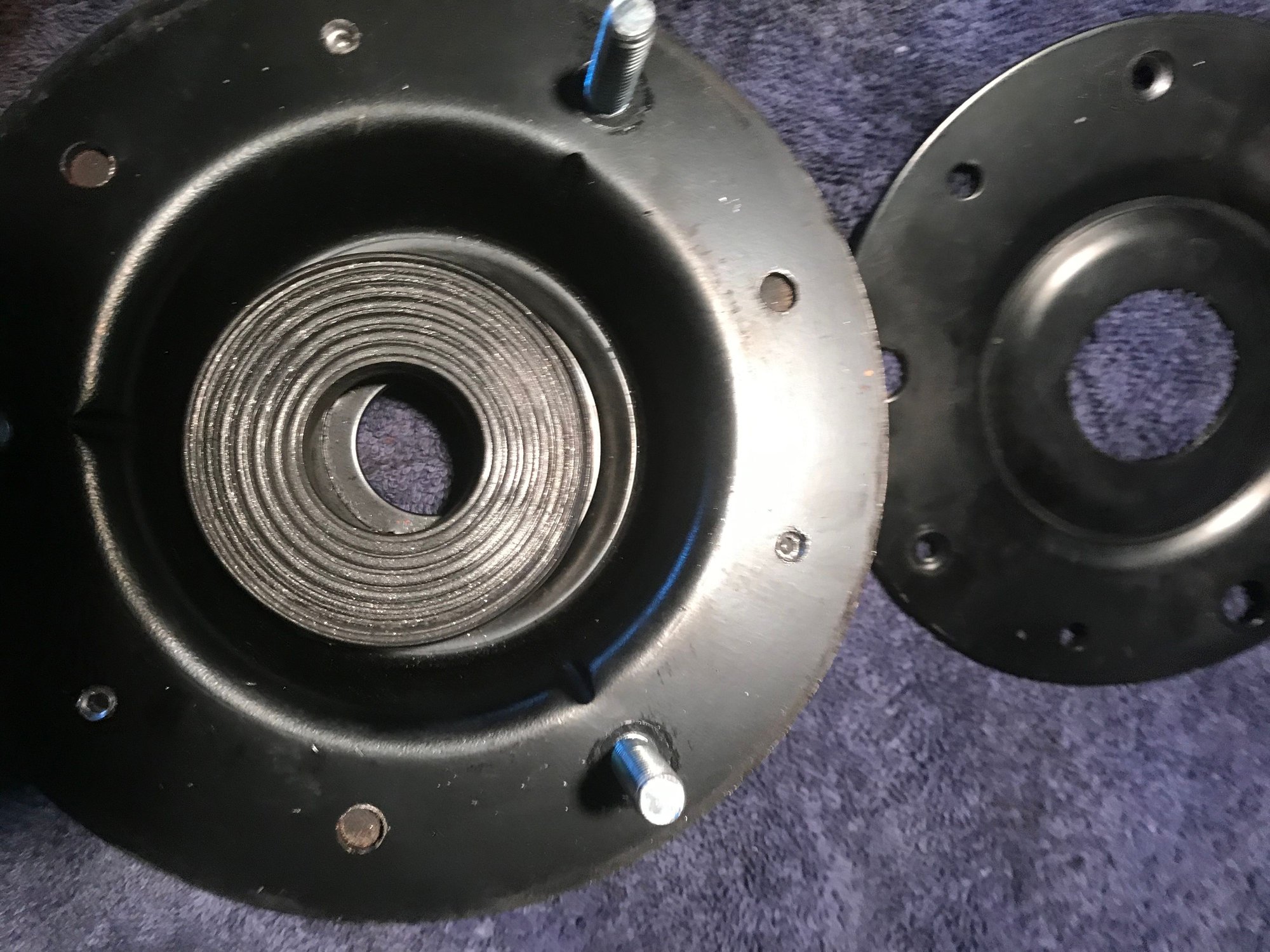

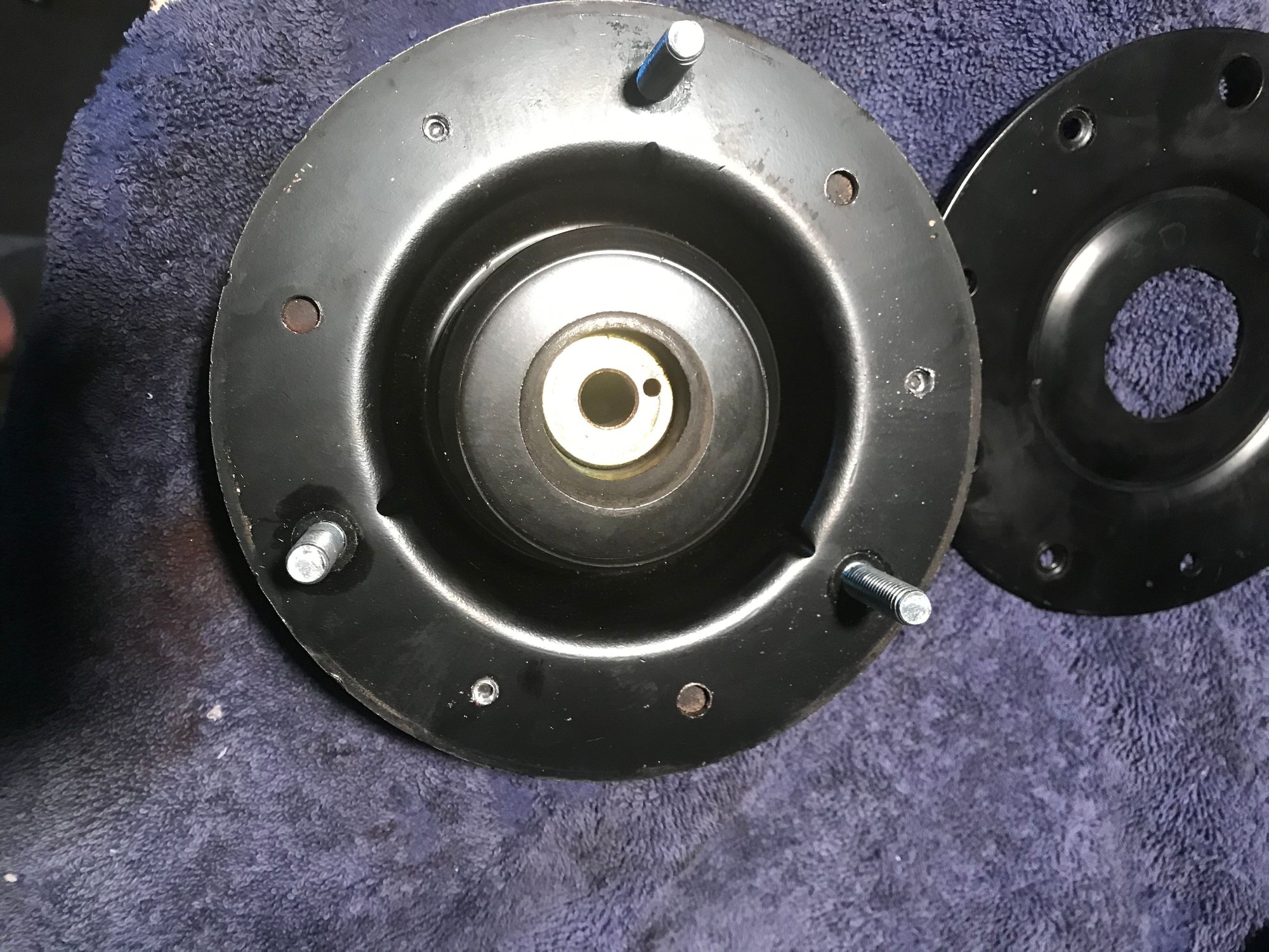

Pics of the Welsh upper shock mount taken apart:
Hopefully everyone can see how the inner ring/doughnut can easily shift to be against the inner surface as the doughnut diameter is smaller than the area it is in. Easy fix would be to simply make the three pieces larger to fill the area. Do not know if the manufacture has changed or the design was always this way. Whatever, this is a poor design.

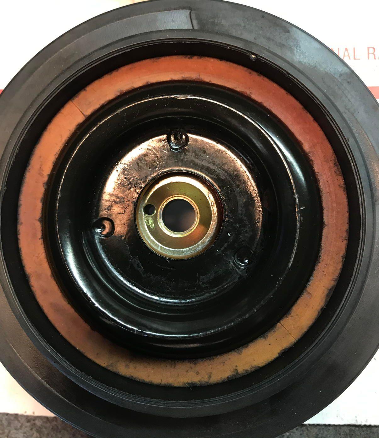

Here is bottom view

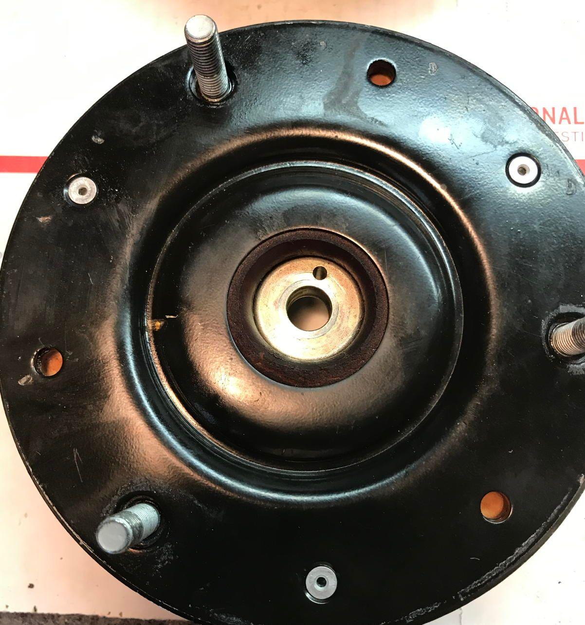

Here are pics of the Jaguar mount
that I am going to put back on. This one has the most movement from center after 5 years.

I am still thinking that not being centered is really not a problem or failure of the mount. On my XK8 I only noticed the off center....I had no clunking or any change in ride or handling....my car had severe inner front tire wear which I attribute to the poly bushings I had installed in 2016 along with the Welsh upper shock mounts (the OEM mounts were crumbling). I had 35k miles on these mounts....no signs of any crumbling....car was driven almost daily and Tucson roads are far from nice and smooth. I suspect that the roads were too much for the poly bushings....which caused the alignment issue....the combination of likely is what pushed the shock rod to be off centered. But I still do not call this a failure.
I took the old mounts apart to just show how they can shift. I think the design could be improved by increasing the diameter of the poly(?) so it could not shift, but not knowing about all the parameters involved....probably not as simple as this.
