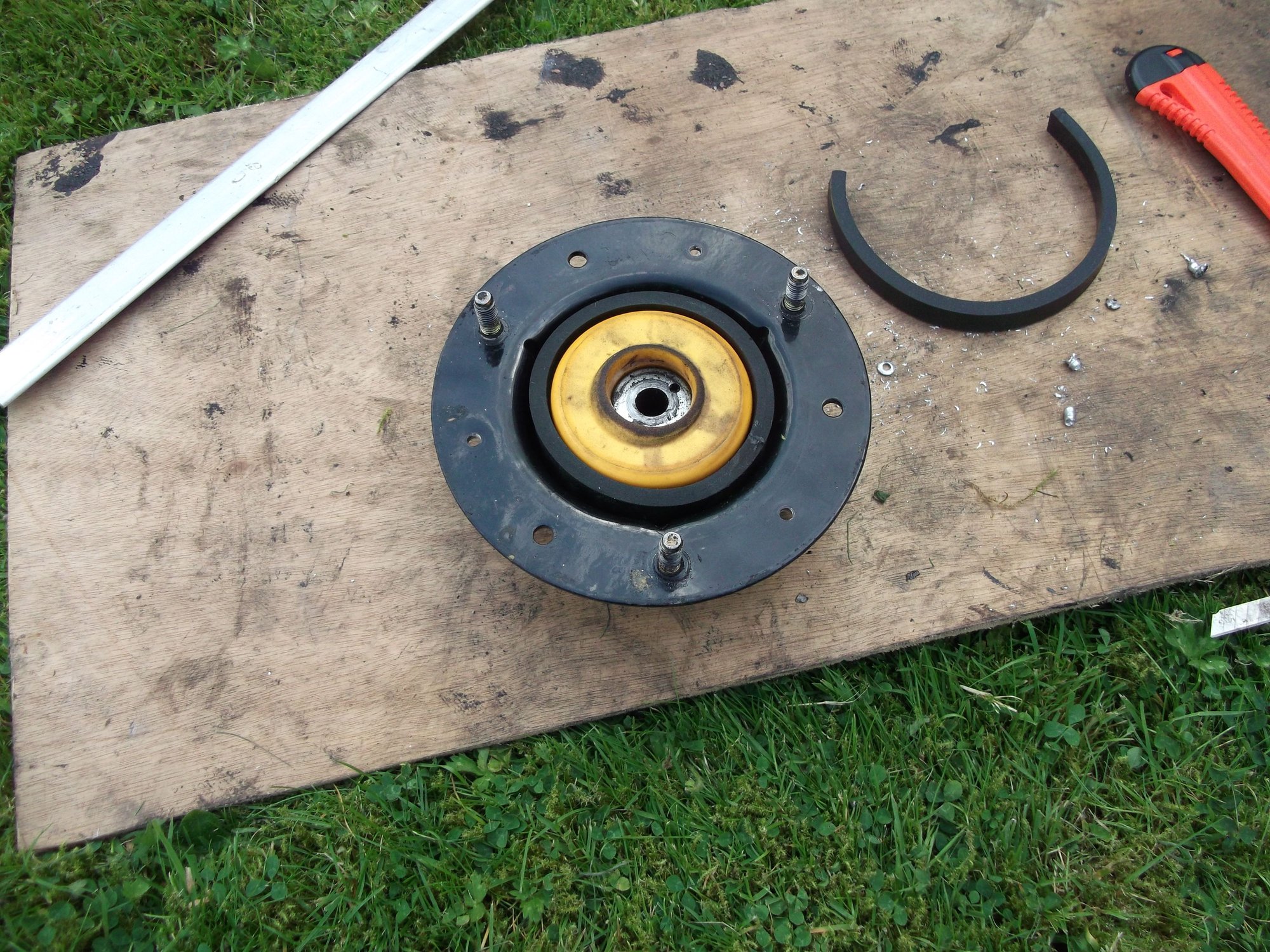

I can't speak for the welsh mounts. but when my SNG barratt mounts moved off centre after only eight months, i made a collar out of 6mm rubber strip.
the inner donut now fits in a snug jacket.
did this 2 years ago and it's been fine ever since.
