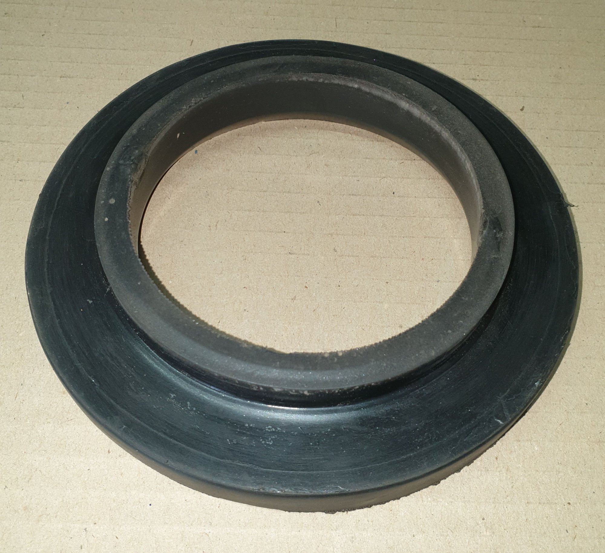

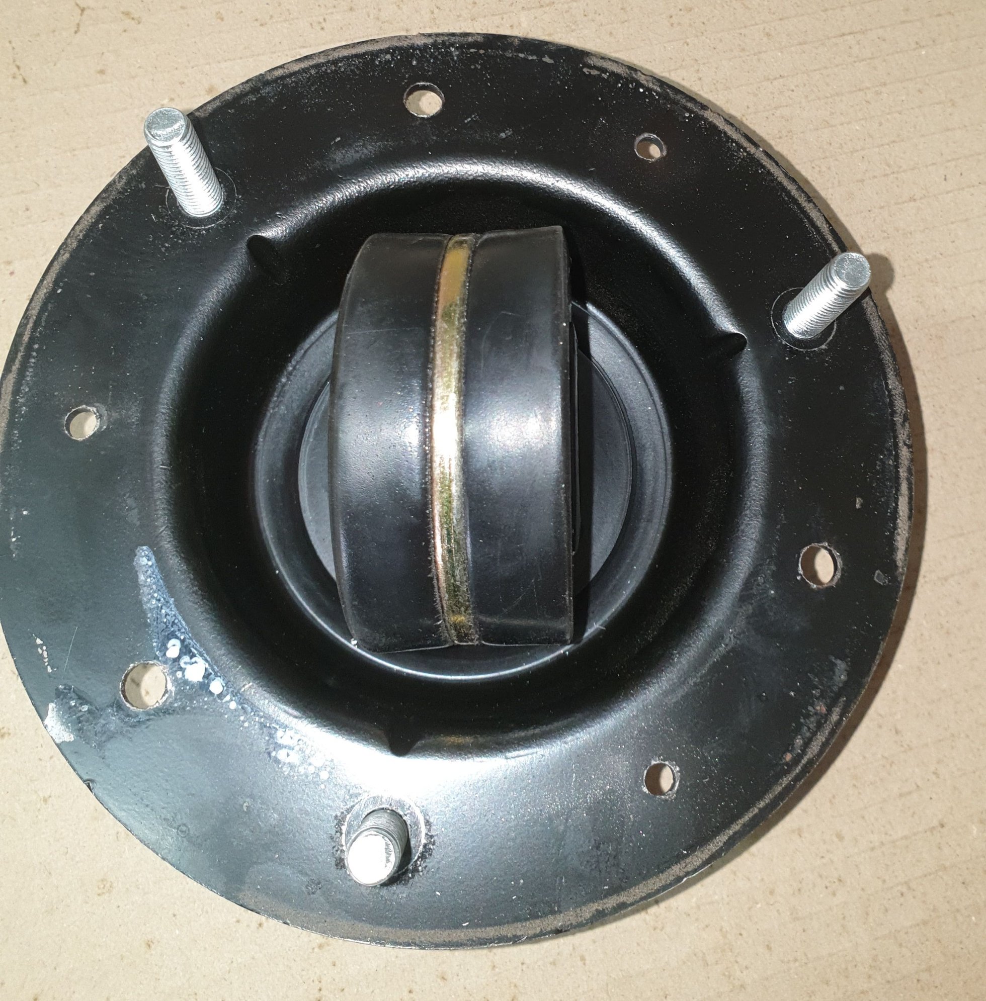

These pics show Welsh poly components at around 4 years old. (NOT daily driver)They came out of my own car when l was testing my own mount design, not because they had failed but because l felt l needed to test my own and only have one car to do it.
Although they too had what l believe to be the same design flaw as all the other mount brands, it appears somewhere along the way something changed with them, l would guess poly formulation.
This has led them lately to the same place most other mounts out there have landed (ie.in the trash)
what l don't understand is the Welsh reference to heat, poly loves heat.
